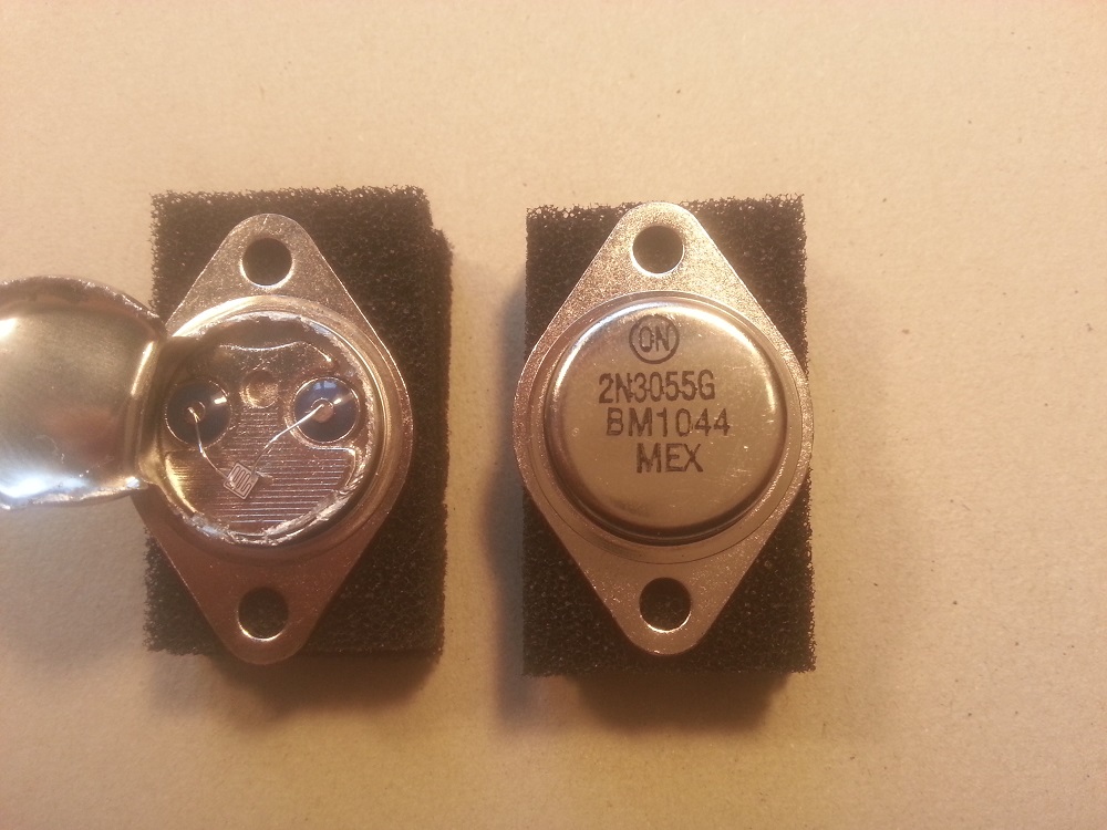

Hi
Just got some 2n3055 from RS .
Marked "ON" & "MEX"
First the " wipe test",the text went clean off ! ?
With a suspicion rising I desided to cut one.
See Att. pic.
A nice surprice,the cooling "coin/mint" (axeformed) is present and the assembling dosn't looks like its made in hand.
Still it could be a fake! The dice is very small. See:Counterfeit Transistors
But I think these are actually ok.
The "wipe" test is apparently no longer usefull for exposion of fakes.
Neigther is the dimensions.Base thickness,flat top,diameter of insulation around pins......
These pirates know there dirty work .
Seems the only way to check is testing a few to/over the limits.Hoping the rest is similar.
Jan
