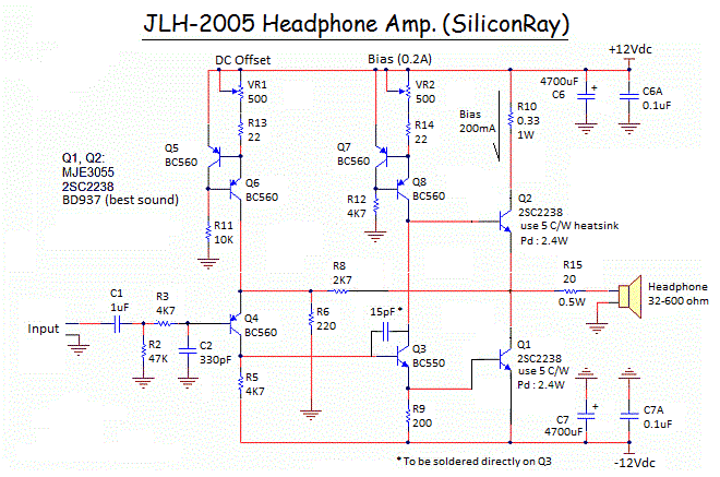

Revised schem based on comments in thread
Hi Ray,
I went through the whole thread and modified the schematic based on issues people had found building this headphone amp, the most common issue seems to be some oscillation and this appear to have been resolved by the addition of a 15pF across B-C of Q3. I do not own the headphone amp. I just hope if can help future builder.
BR,
Eric

Thanks Eric. As I don't want to be forever putting the boards in and out your schematic prompted me to try the first channel that I changed the resistor in before proceeding to the second.
So, I connected the R output directly to the DAC buffer and the L output through the JLH board, accepting that there would be a big imbalance in levels between L & R.
The result (L output); it plays music cleanly and actually sounds quite nice. Bias was rock steady and DC offset was down around 0.01V with only tiny variations so things are looking good. That is without the 15pF cap across Q3 so, arguably, it worked first time.
There's always a but though isn't there. I have a low level hum via the JLH board. The level of the hum doesn't change with volume setting and I'm sure it's grounding related so work to do in that respect (I'm now having niggling thoughts about those ground pads that were such a pain to solder on the PCB). I have no hum on the R output so it's definitely JLH board related.
Next step is to change R13 on the second board and test and commission it so I can compare the two channels and see what the overall troubleshooting picture looks like.
Ray
I was about to work on changing R13 on the second board when I noticed I hadn't secured a ground connection. Now, with it screwed down properly almost all of the hum has gone, just a tiny residual level left for another day!

I got my cards and have started to solder the components. For R11 I got a 0 ohm resistor instead of the 10k, I wrote a question to siliconray about it, he claims it is supposed to be that way but I am not convinced. What do you say guys, is R11=0 OK.
I don't understand the theory aboat the current source.
/S
I believe R11 can't be zero ohm.
This current source will varie from about 0.65V/522 to 0.65V/22 so 1mA-30mA
Both variable resistors should be 500ohm according to SiliconRay.

I have build the schematic that was pointed @ 86th post.
Works, everything is stock except outputs --> TIP41 is used.
Oscillates without 15pF capacitor. Soldered 20pf there.
Bias is rock solid 200mA, but DC drifts some times... the problem could be my layout, all transistors are almost tied together 😀
Using ATH-A900 metal blue closed cans, 40ohm imped. per driver.
This schematic drivers them very well, "slam, attack, notes, everything is there"
Could it be possible to lower the gain just by reducing feedback resistor to a lower one ?
DC drift was caused by dirty contacts on solder joints where probes were connected.
Changed the feedback resistor "output to Q1 emitter" from 2.7k to 1k.
Changed Q1 emitter to ground resistor from 220R to 470R
This gain now is perfect for 40R ATH-A900 closed alu. cans. Input around ~0.9V and with the volume max i get no noticeable distortion(clipping or some sort of unpleasant sound).

How is the slam, attack with the new feedback resistors ?
Just wondering because before the Gain was 2700/220 so 12.3 and with your value of 1000/470 only 2.1 so the overall global feedback is greatly reduced therefore increase distorsion and lower damping factor.
Now sure if headphone's speakers are affected by lower damping factor, your feedback would be appreciated.
Why did you lower your bias from 200mA to 160mA, did your TIP41C overheated ?
