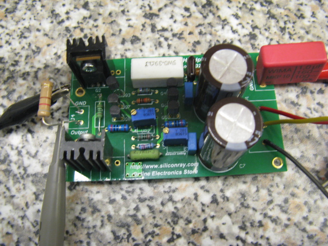

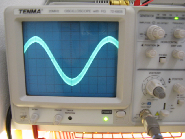

Here you can see some photos, and what I got from the scope.
I can see a sinewave to the Mhz region.
I am thinking to put a small, like 60p, cap between base collector on the 15030.

I already checked the board, will check again, but both channels behave the same.
What about the small cap?
You can try the small caps.. are you sure the pin of your transistor is cbe when looked from the face?
Yes, I used bc550c and bc560c, they are cbe.
Also be voltages seem OK on all transistors.
Tried small caps no change.

With mje340 (be careful of the different pinout) and bc546 it works fine. Have not listened it it yet though.
I used mje 15030 in the beginning when I had problems. These seem too fast for this circuit.

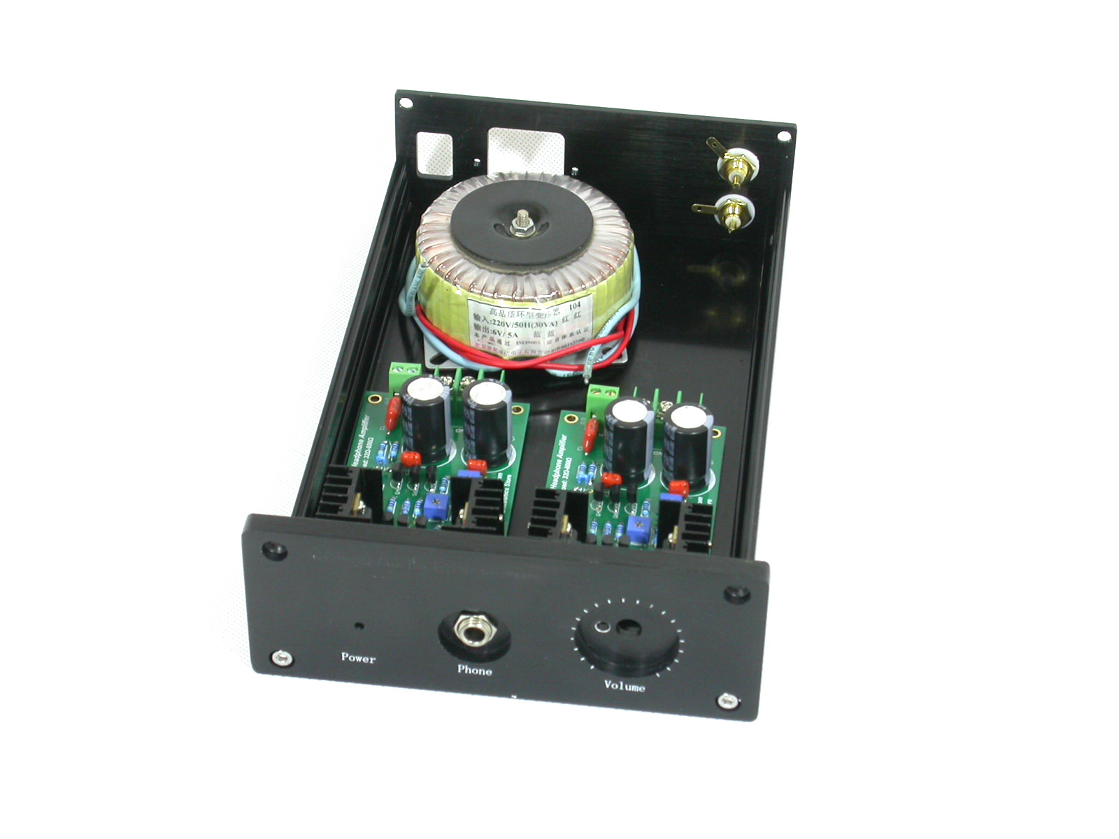

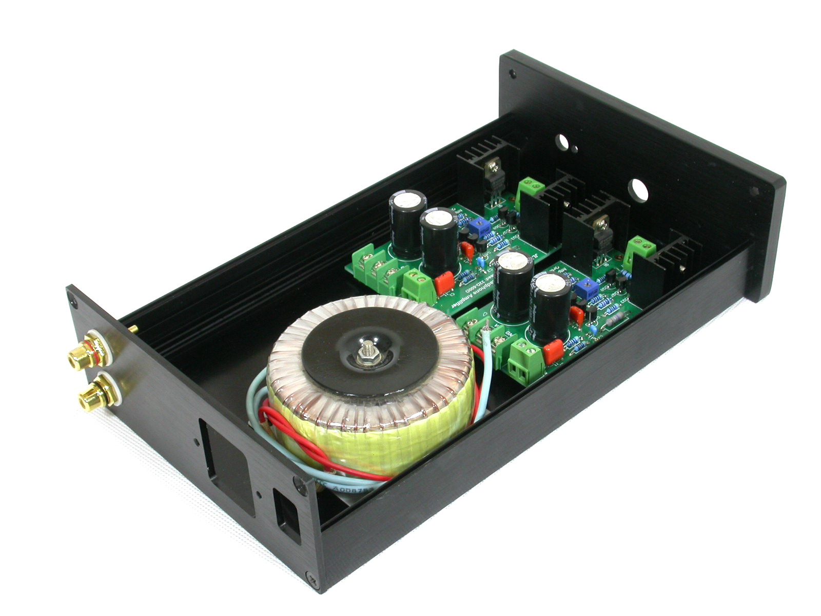

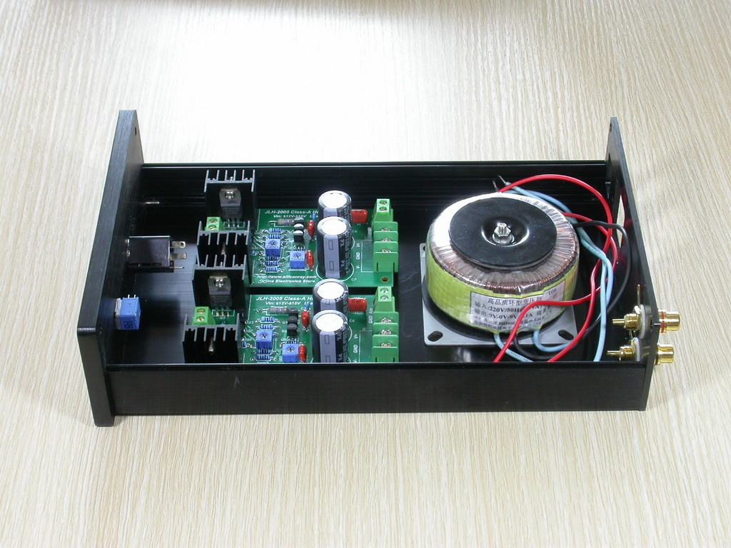

RE1506 is the ideal enclosure for the headphone amp. One 20W transformer, 2 board, RCA connector, ICE connectors, potentiometer, 6.35mm jack and switch can be easily fitted into it without any mod. There's still enough room for a small power board with a rectifier and 2 big caps.
