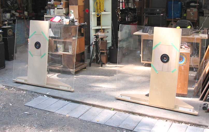

chrisb said:
Somebody must have a picture to post
Here is the stereo pair.
Within the limitations in the bass (as already noted by Jim) the FR125s were excellent on the OBs. In a smaller room (almost any room will be smaller than outside 🙂) with lesser volume demands these would be just fine. If used as an OB midrange or mid/tweeter (from say 150 Hz up) these would be stellar.
dave
I have seen this design quite often and I don`t understand it. Glass has the same wave speed as steel and aluminium and should be fine to take over the magnet/basket resonances. And it is heavy enough to form a solid base for the driver. Wood resonates and can support the driver in bass. So I would do it the other way round, glass for the panel and wood for the wings.
In the past couple of days, I placed the FR125S in a small baffle 1foot x 3foot, close to side walls in a smallish room 10x12feet. How richly sumptuou is the midrange and treble. Could use a bit more bass, though.
How about two drivers per side, either horizontally next to each other or vertically with some distance, i.e. one driver close to the floor? I shall next try a larger baffle for certain.
Did some playing around with my openbaffle CSS FR125S. With the driver at 28" on the 1'x3' panel located about a foot from side walls, the bass falls sharply at 100Hz. When another panel is added for 2' wide x 3' tall, with the edge touch the walls, the bass goes to the high about 75Hz with a gradual roll off. When the singe 1'x3' panel is turned upside down then tilted back, so that the driver is about a foot from the floor, about 80Hz with a less gradual roll off.

Well with boards as wings, the FR125S in the open baffle have bass smooth and strong to the high 50 some Hz and then 3db down in the mid 40s. Enough bass for my listening.
