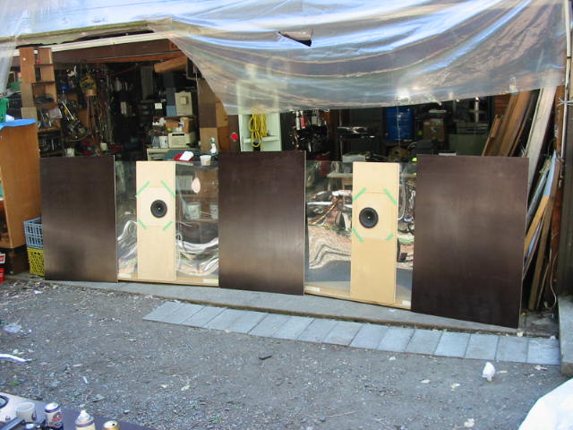

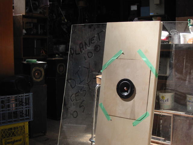

FR125 open baffle
As Tim drove up on Saturday morning, I think I was finishing off the pair of insert panels for the FR125 in Dave's "experimenter O B's" Somebody must have a picture to post, as a goodly part of the afternoon was spend admiring our "joint" handy work, as well as listening to the CSS and a mystery one-off FR driver in the driveway/open-aire lab "wall of baffles"
Also amongst the festivities were at least 5 or 6 versions of mono-pole and bi-pole MLTLs with the FR/WR combo, including a set of not-quite identical twins ( MDF vs baltic birch ply), and Tim's not be ignored 3 way tower ( 2x Extremis, WR125/Fostex dome super tweeter & outboard XO)
There will be further discussion on several threads regarding certain caveats to be observed with regards to SPL/bass tuning issues with the WR/FR125, however a single driver sounded quite amazing. Of course the comraderie and "refreshments" could have predisposed us to enjoy pretty much anthing playing that afternoon.
