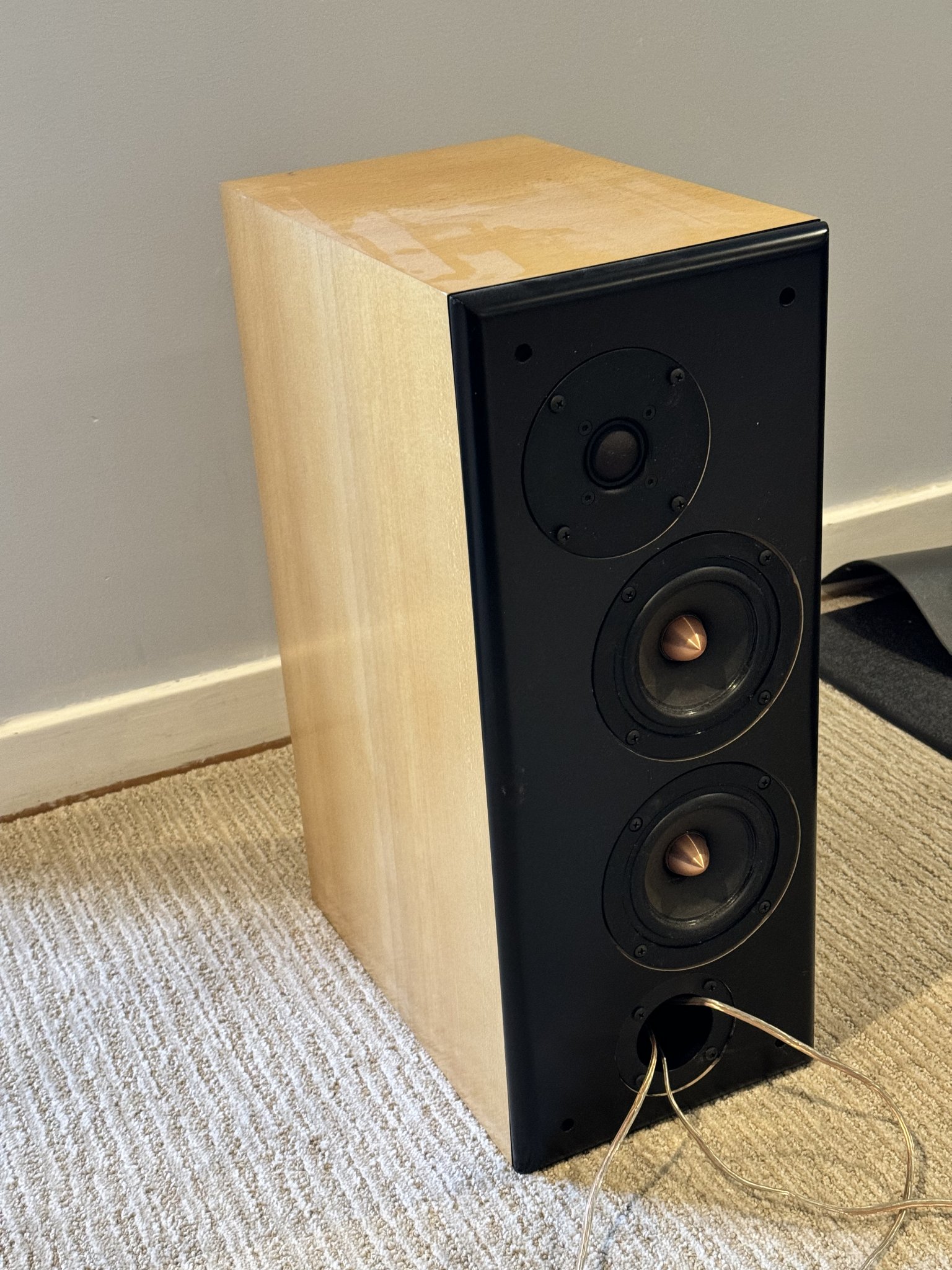

First time poster (I think). I am the OP's brother. Most unfortunately he passed away a few years ago in an accident. The two of us cut our teeth together with various DIY speaker projects decades ago. Life priorities changed for me and I didn't continue to pursue this interest to the extent that he did and never developed any experience with crossover design or bought any equipment for testing like he did.
After my brother's death, I came into possession of the speakers that were the subject of this thread from his workshop. They are not quite finished. It seems that he moved onto a different project and never finished the crossovers for this pair despite what seems to have been a decent amount of tweaking and testing. I requested that the mods reopen this thread so that I could solicit help in completing his design.
Unfortunately, I do not have anything remaining from his original crossover work years ago. The speakers are pretty much fully assembled but with no crossovers installed - just wires to the components hanging through the ports, presumably for continued tweaking. He mentioned earlier in the thread that he had done a two way mini-monitor design with the same components. I have access to those speakers as well and can disassemble them to figure out their crossover design. However, there will need to be some changes, presumably, for the TMM version given the additional mid woofer. I also need to confirm that the baffle widths, etc.
I would really like to finish this pair up for someone in the family to enjoy knowing they were his design. It's not his last project but it's the last incomplete one that I can realistically finish. For the benefit of clarity, the tweeters are Seas 27TDFC and the woofers are CSS FR125S.

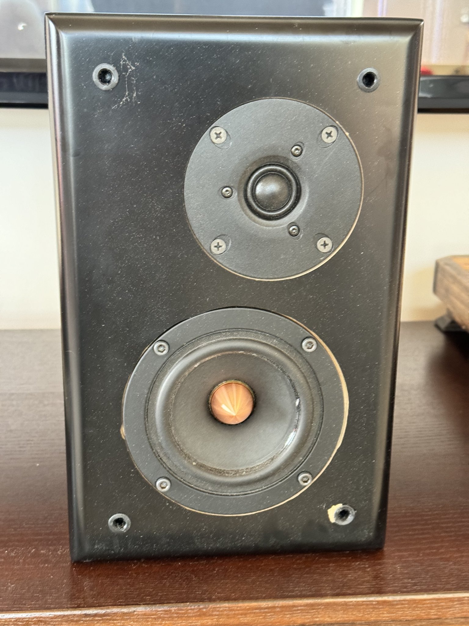

Upon a closer look at the pics, it appears that the monitors are using a different tweeter. Will need to pull them to confirm what the model. The mid woofers appear to be the same as the TMM that I am trying to complete. I thought these were the monitors that ABS was referring to in this thread but either he changed the tweeters or it is one of his other designs that he is referring to. I am not sure. I may have access to the others but not as easily.
