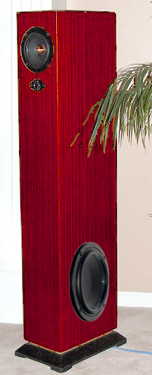

ABS said:Two FR125's in a bipole configuration both mounted slightly off-axis on their respective baffles and positioned directly in line with one another (front to rear).
With as narrow a baffle as possible (6") there is no room to offset the driver side-to-side -- see pic.
Option 2 - Using a 1.0 cu ft ported enclosure for both FR drivers with a downward firing port tuned to around 50 hz.
Be wary trying to get too much bass out of the FR125, you will. When modeling go for a higher F3 with a better F10 and a more gradula roll-off.
Option 3 - Add a tweeter to the front FR125 (if needed) in conjunction with 1 and 2.
1. For the bipole FR setup, how close can the rear of the enclosure be to a wall and still provide decent sound/imaging? Does the requirement change if the rear driver is just doing BSC versus running full range (also see #2 below)?
Room dependent... as a bipole (given some toe-in) at least 2 ft out from the wall. If just a 0.5 then it needs to be out at least the width of the cabinet. With no baffle-step, any room gain will be more obvoius.
2. For the bipole FR setup, what changes in overall system performance should I expect by rolling off the rear firing driver (BSC only) versus running it full range?
They will throw a different soundstage. (ignoring the issue of how your amp behaves into the different impedances above & below the XO point.
3. If I incorporate the sub-woofer into the design would there be any negative impact to its being side fireing?
That is where i'd put it.
Am I correct in thinking that they must be wired in phase to get the push-push/pull-pull operation mode?
Yes. They both load the box the same way.
Do I need to worry about wiring them in parallel versus series - my amps are not 4 ohm stable but I have read that the FR's wired in parallel still have a high enough impedance that amps won't complain?
How your amp behaves determines series or parallel wiring... keep in mind that if you series wire you need to use a shunt cap to roll off the back driver for use as a 0.5.

Since my amps aren't 4 ohm stable I am now thinking that I might have some issues running two 8 ohm FR drivers in either parallel or serial since it will result in either a 16 ohm or 4 ohm load.
Would it make more sense for me to go with a rear mounted WR125ST driver which I could wire in parallel with the front mounted FR driver? Of course my concern is whether or not that would that still provide the same baffle step correction or if the two drivers need to be identical to acheive the desired result?
ABS said:I am thinking that placing the drivers somewhat off-center will result in possible improvements to the baffle diffraction. Since this is going to be a .5 setup, the dispersion off the baffle from the front firing driver is going to be important in the upper frequencies - do you concur with this logic?
Yes... just keep in mind that the narowist possible baffle means there is no room to offset the driver,
In regard to getting too much bass out of the FR - is it your thought that room effect will effectively increase perceived bass between the F3 and the F10?
Yes... and it is very easy to get heavy bass out of the FR that is over-the-top.
IWhat is the shunt cap you mention on the rear driver? I was expecting to run the bottom end of the rear firing driver with the same tuning as the front driver and then to use an inductor to roll-off the upper frequencies creating a 1st order low pass passive filter. Are you suggesting I should go 2nd order instead with both an inductor and a capacitor? Also, I am expecting to need that filter regardless of parallel or serial wiring, no?
If you wire in parallel you use an inductor to roll off the 0.5 woofer, if you wire in series that doesn't work, you have to use a shunt capaitor across the 0.5 driver.
dave
happy.gringo said:Any suggestions about what value to use for the shunt cap?
A value that has the impedance of the cap down 3 dB at 0.707 times the -3dB of the -3dB of the baffle step frequency is a good place to start
