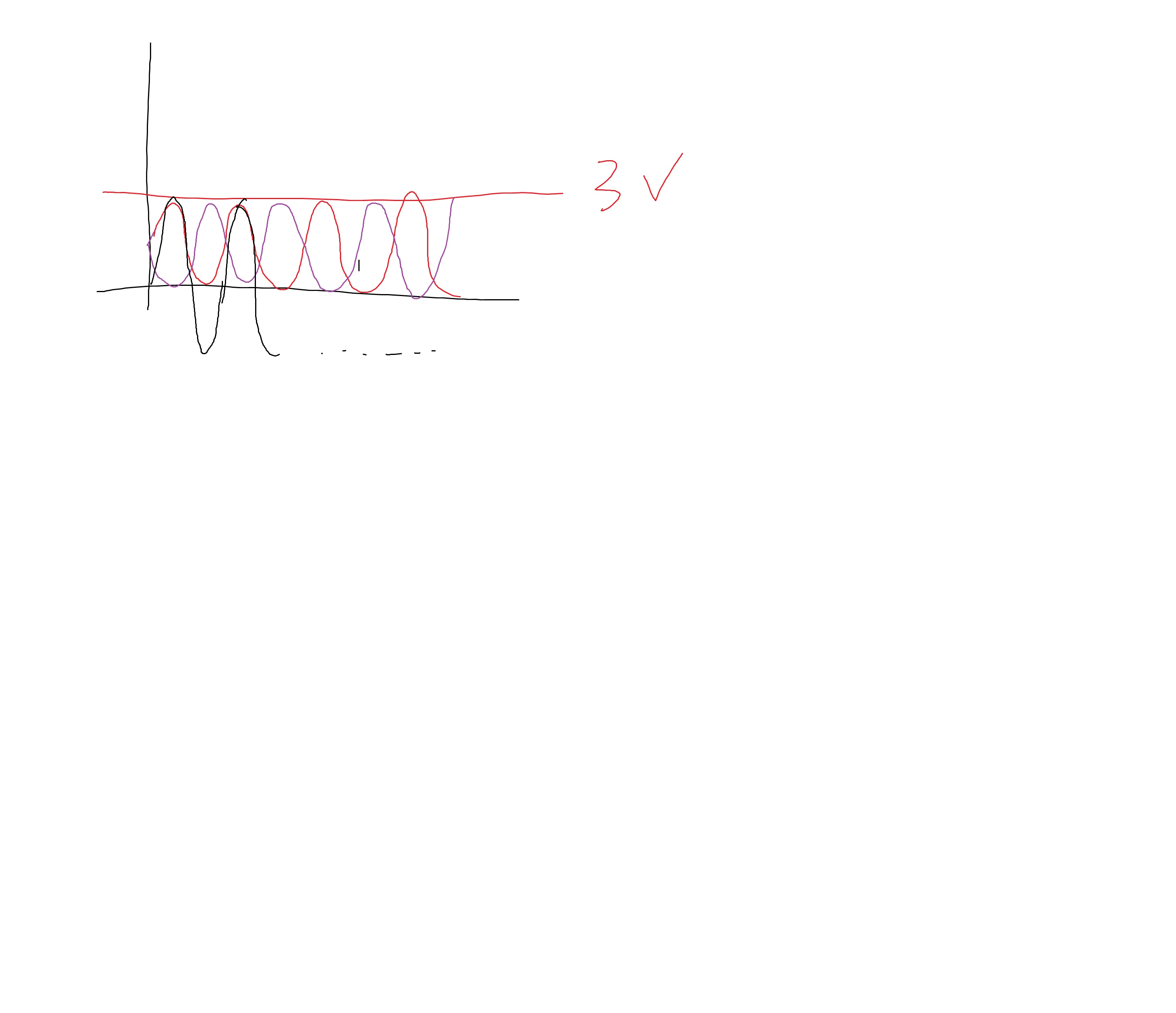

DS out is 0 or 3V, so DC offset is a half.
So each channel, output will have 2 signals.
You can see my draft for more detail.
* I draw too bad ...

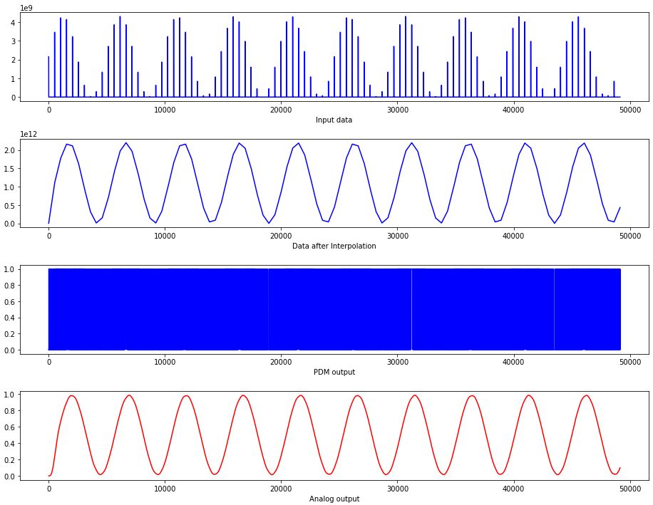

Simulation of interpolation and DS DAC by Python

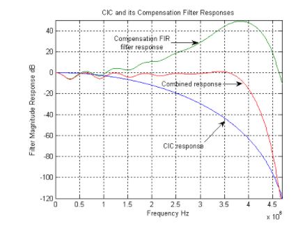

It looks like you use linear interpolation. If that's true, then how do you compensate for the sinc^2 roll-off? It's quite substantial at low sample rates, for example -6.3356 dB at 20 kHz at 44.1 kHz sample rate.
In my project, CIC interpolation need add FIR compensation

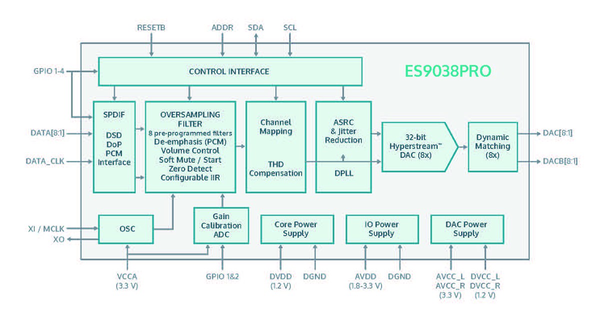

ESS 9038Pro is already a very powerful DAC chip. If you use a cheap version of FPGA to implement the DAC, I would not expect yours to be better than the DAC chip. Chord DAVE uses the LX75 version of the Spartan 6 FPGA and three more.
https://www.newark.com/xilinx/xc6slx75t-2fgg484i/fpga-spartan-6-268-i-o-fbga-484/dp/32AC9780
Iancanada's the reclock module uses Altera Cyclone IV. So if you want to implement a much more complex DAC, you can only use a larger and more advanced FPGA, right?

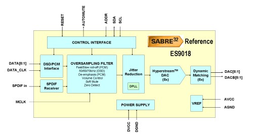

According to the BLOCK DIAGRAM of 9038PRO and 9018, it can be easily seen that in order to achieve better sound quality, a larger FPGA or even more FPGAs are needed to accommodate more complex logic units.
In other words, if your FPGA-based DAC only uses a relatively small FPGA, it is not difficult to know that you do not intend to design the performance to be stronger than the existing DAC chip. In other words, it's just for fun, not to get better sound quality.
