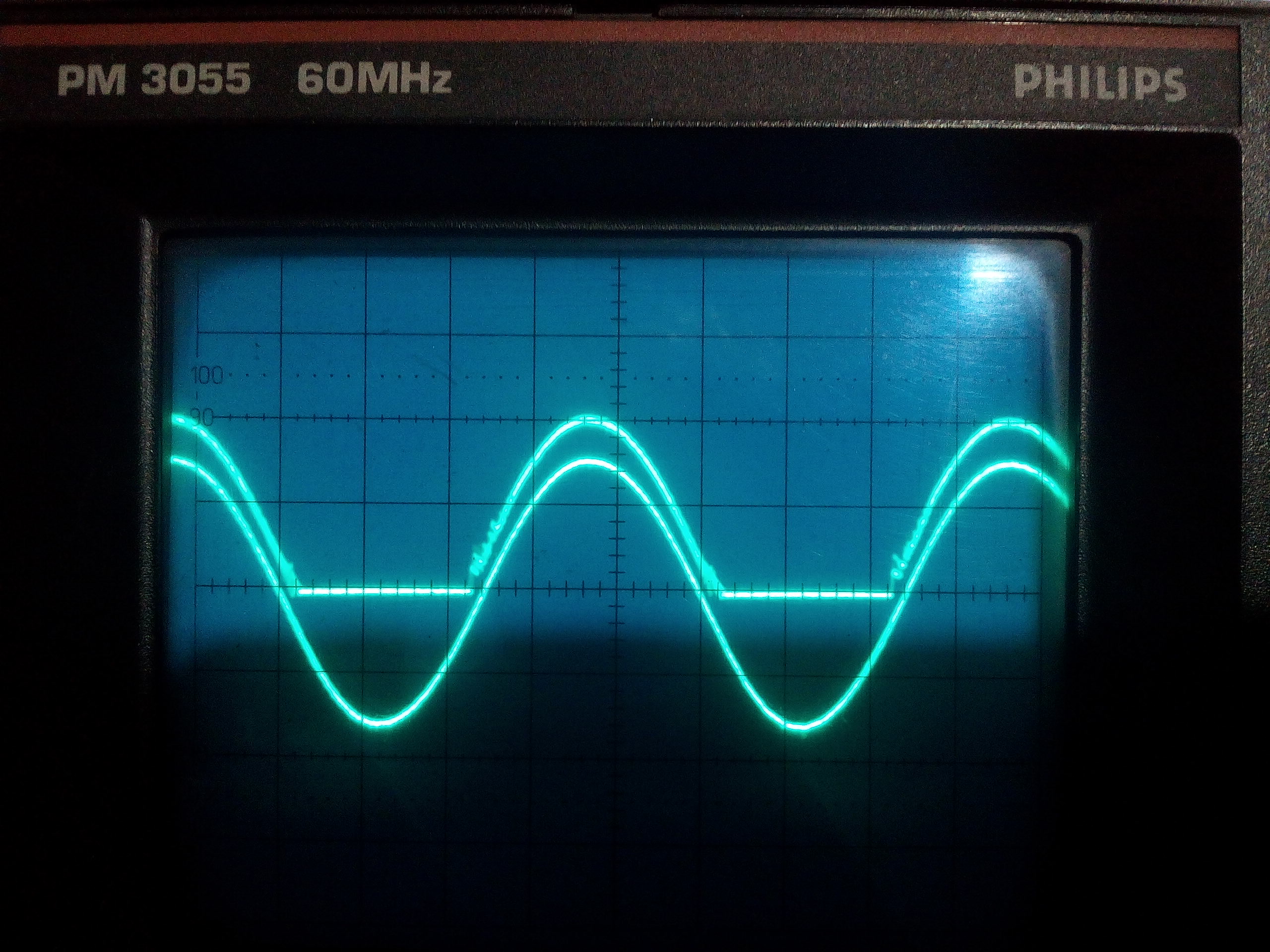

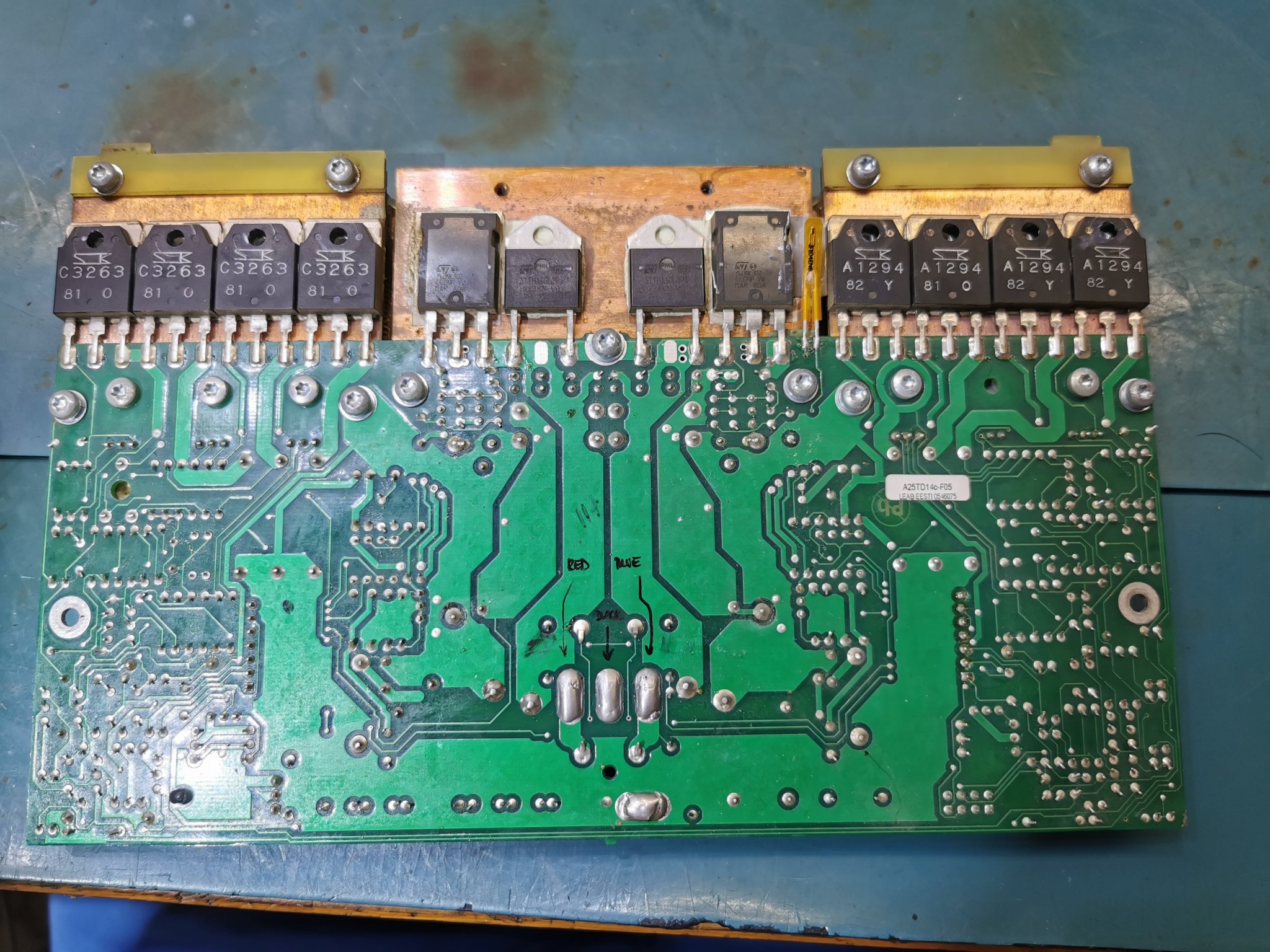

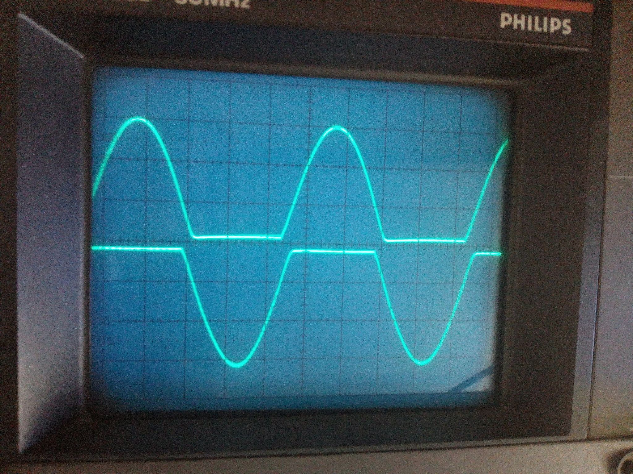

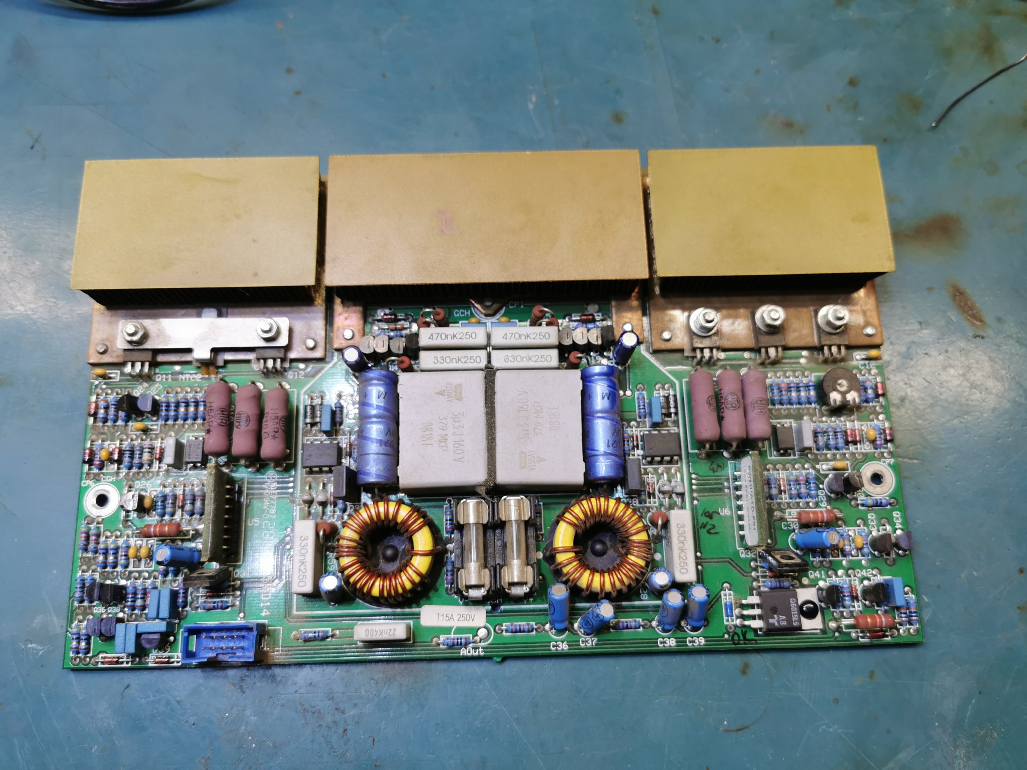

i need your help. I have a clone of fp10000q on my bench with a strange problem. On channel 3 when there is any signal it immediately starts cliping, the VPL/Clip LED come on and the output is low and distorted. I have checked the output with scope, you can see photo of good channel and bad channel. I looked the board for some burned resistors, measured all capacitors and everything seems fine. The problem is on the amplifier board, i tried switching the outputs from pre amplifier board and the problem was still on this amplifier board. Can you please direct me on what to look for or did someone have a similar problem that he solved out?
Thank you

I have one of these clones and the PC board is pretty darn similar to the Lab Gruppen schematic.
"Class TD" is really Class AB with a tracking switching power supply for each rail. Looks like the negative supply is failing to track on the bad channel. That should give you a place to start. The rails from the main power supply are +/-150 VDC or more, so be careful!

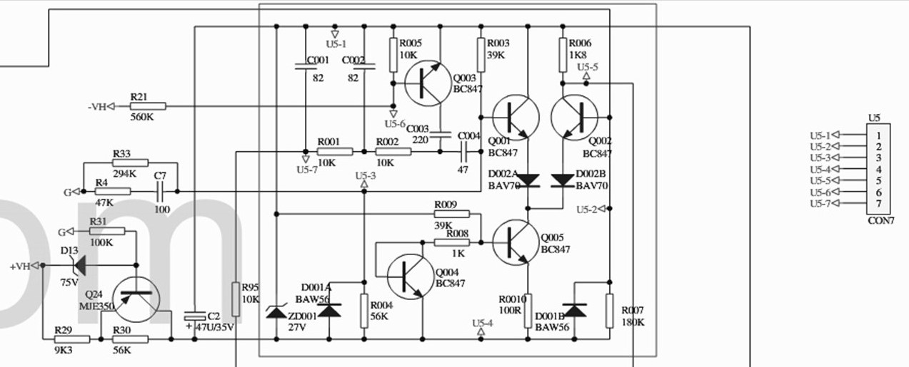

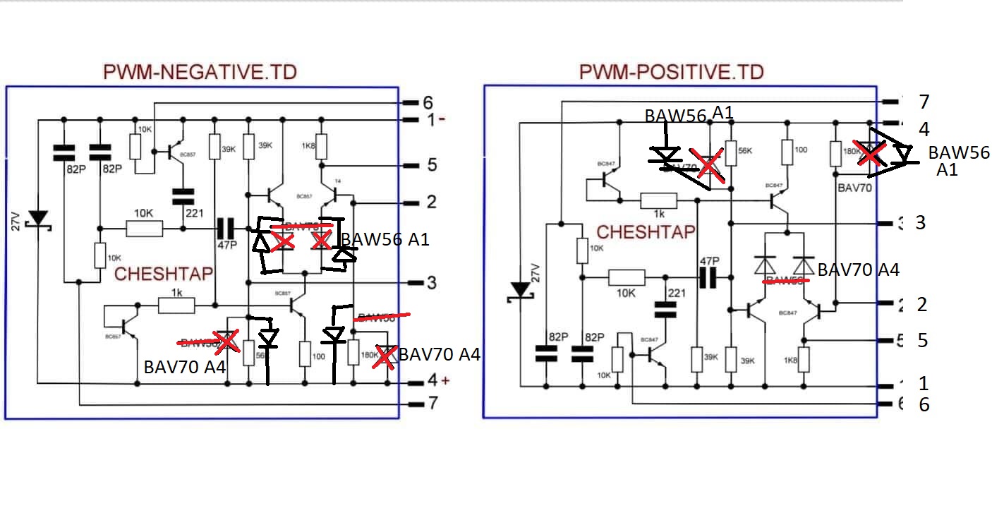

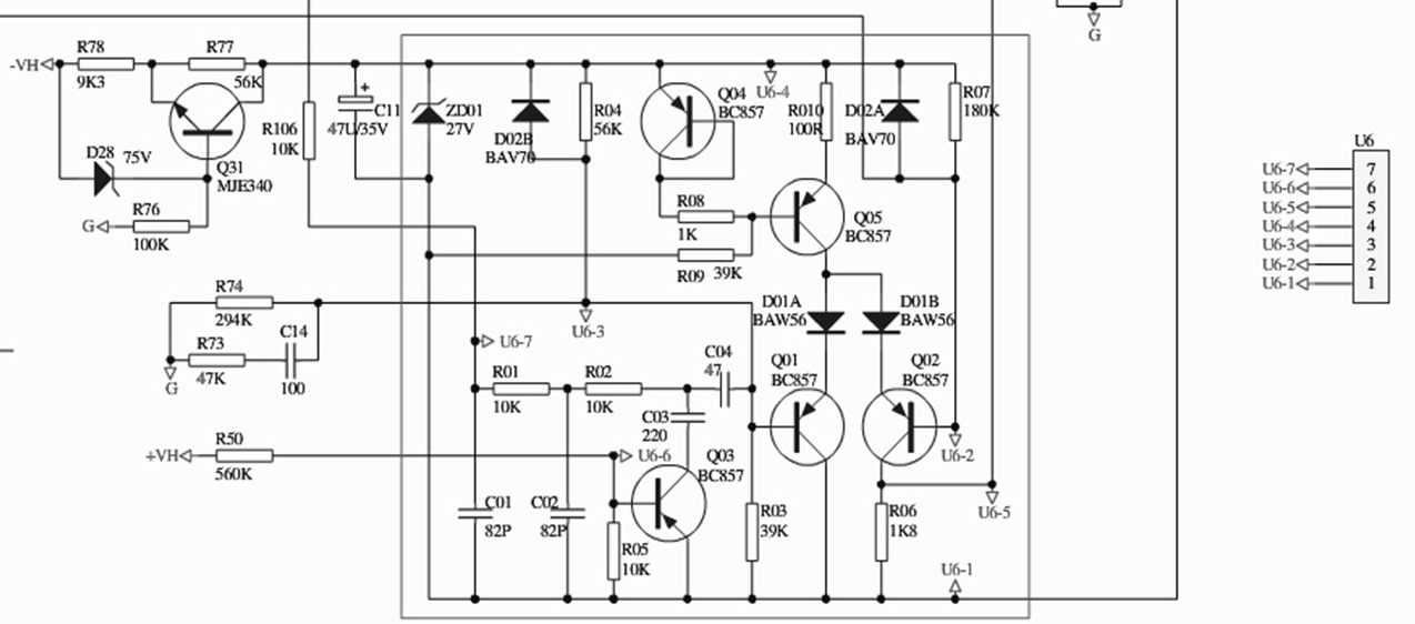

At rest the frequency is 60khz, and when the power is increased, the frequency increases to several hundred khz.
The schematic of pwmnatd and pwmpatd.

As I said the Td1800 does not work well because the PCB design is not correct.
I attach photos with a Yamaha PCB diagram designed by me, it works perfectly as shown in the pictures.

It seems that this PWMNATD is failing often. I have one ORIGINAL LAB.GRUPPEN FP10000Q on my bench, where on one Channel, the U5 board has already been repaired. The amplifier though came into the repair shop as the other channel is failing and as I'm now figuring out it is most probably for the same reason as the one that has already been repaired.
So I soon found out that the main suspect was the PWM board as the Negative PWM was working intermittently, and when it died out the distortion and channel PEAKING symptoms (as described above) appeared.
So I first replaced the U5 board with one of the good A25TD14 amplifier boards and wasn't sure if this solved the problem. Now I soldered the presumably bad U5 board to the "known good" A25TD14 amp board and it is exhibiting the same issues. Therefore I would 99 % say that the problem is in the PWMNATD board.
My question: Has anyone pinpointed what is failing on the PWMNATD board since the fault seems to be repeating across the products?
