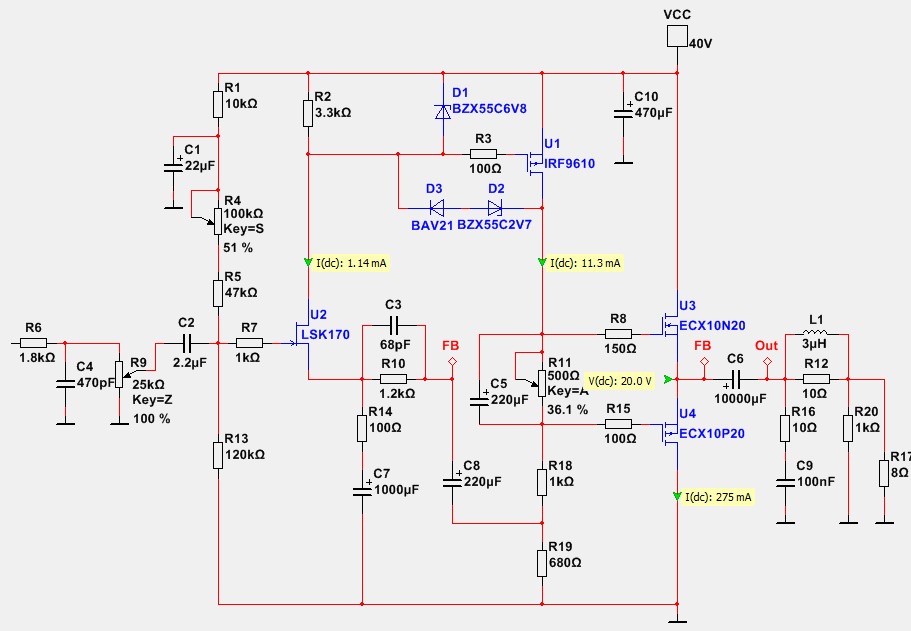

The idea is intrinsically sound, but since then I've seen that crossover distortion seems to be a bigger problem.
A constant V drop between the gates is quick and easy, but the price is the class-AB style switching. Maybe something non-linear could be deployed for the VAS, like a CCS that's slightly modulated with full-wave rectified audio? In principle, the gate voltage would be at a minimum in the middle, and increase slightly at both extremes, a la cube-law class A.
So in Class A, perhaps with the top MOSFET in a current source role and the lower MOSFET doing the work (or swapped roles), it would be nice - but then Voffset would really need some feedback.
Or SRPP? A MOSFET with gain on one half, and an Aleph-like negative resistance / modulated CCS for the other half. It sims well, but it's a bit fiddly. With a double Sziklai push-pull arrangement for the CCS (on mobile so I can't attach a pic right now) that's 5 transistors already. But the lower half could theoretically be a SIC JFET, using a battery in series for the negative voltage.

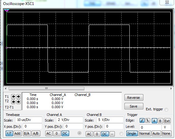

It is the most nice squarewave I have seen.
Notice: 20kHz square
I like the overall flow and intent of this design, and I think it is well worthy of discussion and suggestions, which is what I understand the forum's intent to be. Of concern to me is the bias setting pot on the output mosfets. I always ask myself, "What could go wrong?" The most likely failure mode (and I have seen this happen often in sensitive measurement and instrumentation systems) is that the wiper fails as an open circuit. When this happens, the bias on the n=mosfets will go to a maximum, and may lead to excessive current flow before the system can shut down. I am experimenting with using a shunt regulator in this spot, an AZ431L.
https://www.diodes.com/assets/Datasheets/AZ431L.pdf
I am not sure how it will work out yet, but it can be configured such that if the pot wiper opens up, the bias voltage will be minimal.
I think that one of the earlier posts was spot on in that it is exciting to explore minimalist topologies just to see how far they can be squeezed. I am not asserting that they are always the best possible, but is also not clear that an amp with 20 transistors is 5 times better than one with 4! Besides, experimenting is fun.
Good luck with it.

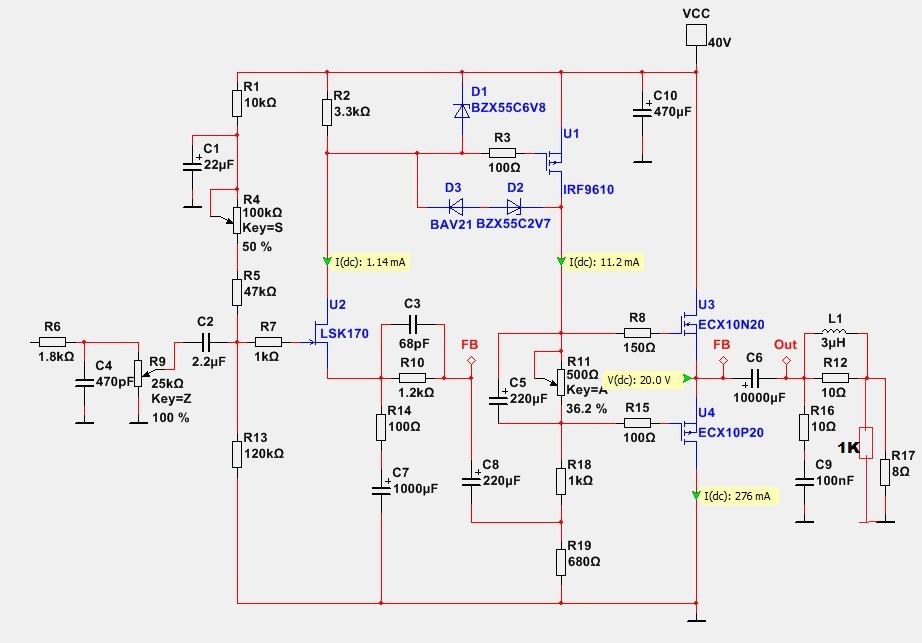

I will add one 1K/2W resistors from negative side of C6 to ground line , just to keep that coupling cap fully charged in the case that speaker cables was from some reason disconnected and later connected again.

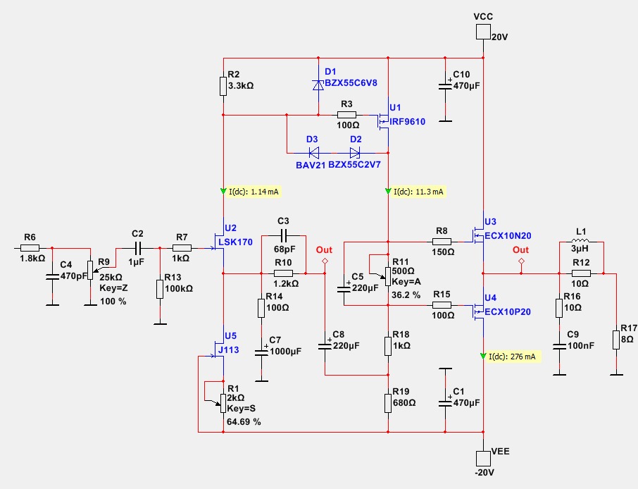

@lineup Would it be complicated to rework the proposed scheme to +/- 20VCC to avoid capacitor C6 at the output of the amplifier?
Here is the dual supply version.
I added one current source JFET U5.
This version performs identical to the version in first post.
But the PSRR should be better thanks to the input.
FIVEFET it is with this version 🙂

I plugged the dual supply version into TINA (with slight mods but mostly the same).
It seems a bit too dependent on ideal capacitors, and trimmers that can be micro-tuned to a fraction of a percent.
C7 looks like it can be removed altogether.
In my version if U1 is increased from 20°C to 40°C, Vout moves by about 150mV. Therefore the single supply version seems more practical..
Reactions: lineup
I have done a few headphone amps that use a capacitor couples output, and one thing that I "threw in" was a small relay connected directly across the output to ground, with a small, i.e. 10 ohm or so, resistor in series with the contact. The coil was wired with a time delay of a few seconds to allow the circuit to stabilize before opening the contact. This kept the output at ~0 volts during the startup and minimized thumps at turn-on. a Simple 555 timer can do the trick remarkably well. R20 above is also an excellent idea.
