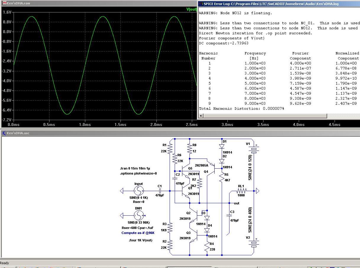

Something more to chew on...
I've realized the Taylor/WCF circuit is really MJK's Anti-Triode totem turned
inside out! So you can abuse the same stOOpid AB pet tricks with Schottky
shaping diodes. Its hyperbolic A, not AB, but you know what I'm driving at.
Extreme opposite of JLH misbehavior, way too much bias in the center...
You know, because it an Anti-complimentary follwer on the flip side, you
ain't never gonna get rid of 2nd hamonic merely by the SRPP transistor
appears to offer a compliment... The "anti" transistor behavior is shaped
by external maths more than its own curve. Insultramentary architecture...
Anyways, if you want to get rid the 2nd harmonic, just get rid of all of em.
Fix an emitter's current, and you fix its voltage drop. Make the "anti" do all
the grunt work, so the one doing the follower function is prevented from
experiencing current variations. I can nail -120db 2nd -140db 3rd in full
Taylor mode. Though its not particularly power efficient to do so.... Its
sorta like an emitter follower with a CCS. Except the emitter never sees
any load current variations either, thinks load is much higher impedance.
But my drawings today are about HyperA, not full Taylor.
I probably only confuse things by talking about both in one post...
I don't understand what this means 😕
As far as I can see, this is well beyond what the front end is capable of doing, so do you think the tradeoffs (you mention power efficiency) are small enough to ignore ?
If you can put one of these distortionless A's in parallel with an AB, B, or D....
Either open loop, or as a current dumper... Yeah, then maybe the wastefully
biased Taylor stage wouldn't need so much Iq as to carry the full load by itself.
What's not to understand about JLH overbias in the center? The sum of two
base currents is held to a constant under all conditions. But the base currents
needed for full output current swing are much higher than required for normal
class A quiescence. JLH has nowhere to dump this excess of quiescent base
current when it isn't needed, so output transistors idle hotter than necessary...
In my most recent schematic, Q4 is the shunt that bleeds off those excess
drive currents. Is also why it doesn't need a constant current source, drive
currents are shunt regulated instead....
OOpss.. I got it backwards. Q4 is a modulated current source, not a shunt...
Been looking at this thing standing on my head too much.

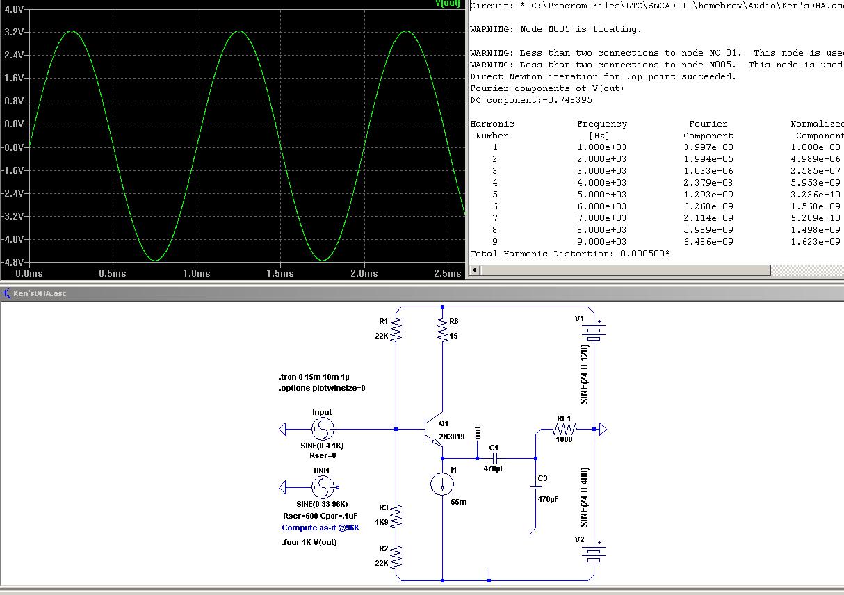

Call me a wet blanket if you like, but the improvement over a plain current source isn't that huge: about 2.1ppm against 5ppm.
BTW, a number of HP instruments of the seventies used a similar scheme for buffers stages.

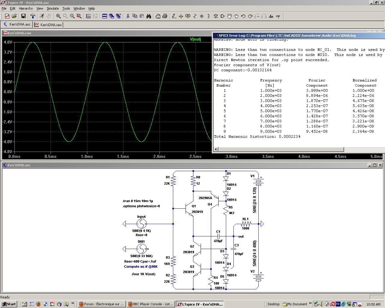

Taylor only hides emitter distortion, does nothing to fix the Early effect.
But every time I try to wrap Taylor around a cascode... LTSpice breaks
into wild oscillations.
I don't have an oscillation problem. However, it doesn't bring any improvement either: distortion stays stuck at 2.2ppm.
Bootstrapping the collector of Q1 looks much more promising: distortion now drops to 70ppb (I hope in a month's time, we'll be talking in ppt).
  • Ken'sDHAcascBoot.asc.txt
Q1 was the Early I meant to cascode away, the comparator is what matters.
I don't know how much matters having another cascode in the taylor circuit?
I abused a JFET rather than C2 to lift the base of the cascoding transistor in
my attempts that broke into oscillation.
