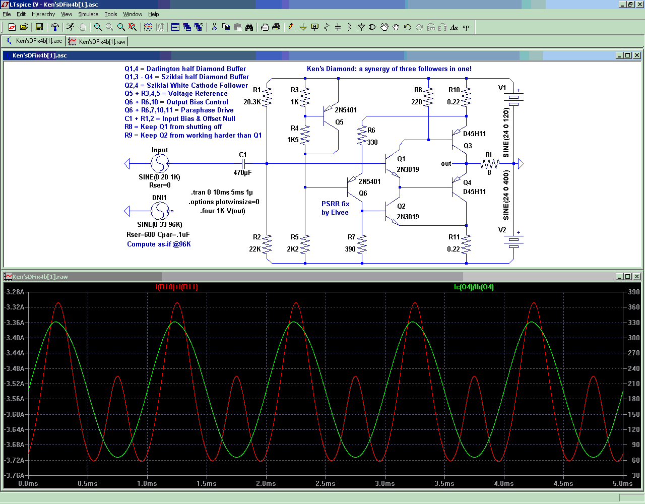

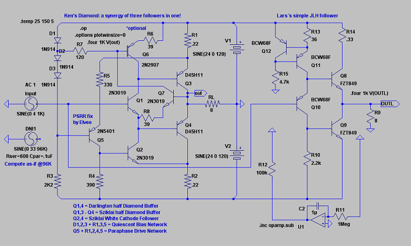

Had to give my simplistic NPN-version another try. Used devices from LTs std library.
Checked Ken´s with 1V/120Hz ripple and got 0,5mV out, mine got 1,5mV.
About distortion they are on par with both having 2nd order dominating.
No problems with temp on any of them.

OK, but we are getting WAAAY beyond 4 transistors now.
There has to be a simpler way to correct a small offset.
Whats the op-amp U1 for?
Why is R14 on Q8 collector, instead of Q9 emitter?
I see regulated current diverted to one or the other
output bases, but what regulates quiescent in hot
output totem if current gain begins to run away?

Hey Ken,
From my previous post:
Adding the servo (and in this case a cap) can be a possible fix.
Just remove the ground-connections add a cap and connect to the amp instead.
About tempcomp it looks great. Don´t know though if both BJTs in the CCS needs to be on the heatsink. Haven´t dug deeper into this since I copied it from the JLH site.
The temperature behaviour looks OK in the sim because Q12 and Q9 are kept at an identical temperature throughout, but in the real world, it will instantaneously run away.
I find Ken's circuit interesting, because it differs significantly from the same old designs, rehashed thousands of times with minor modifications.
I am pretty sure it has a great potential, there is just a small detail to iron out, it's the second harmonic thing.
The circuit is functionally symetrical, which means it has the capacity to cancel most of the even order distorsions.
there remains to find the root cause of this asymetry and to eliminate it.

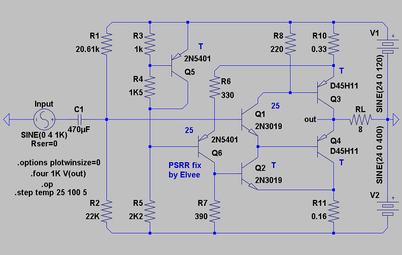

Was about to edit when the diyaudio-server went down an hour ago.
Anyway tempcomp is negative from 2,2A to 1,8A going from 25 to 100 C when Q12 is on the heatsink. With only the output devices on the sink we get 2,243A to 2,260A.

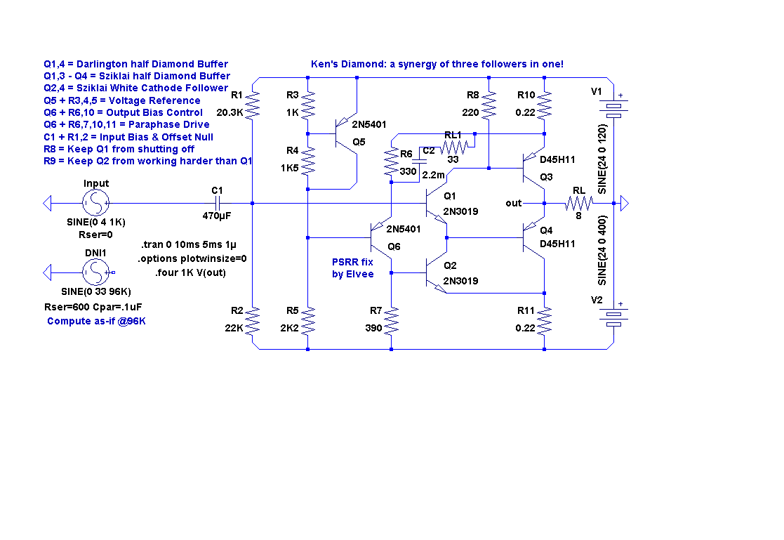

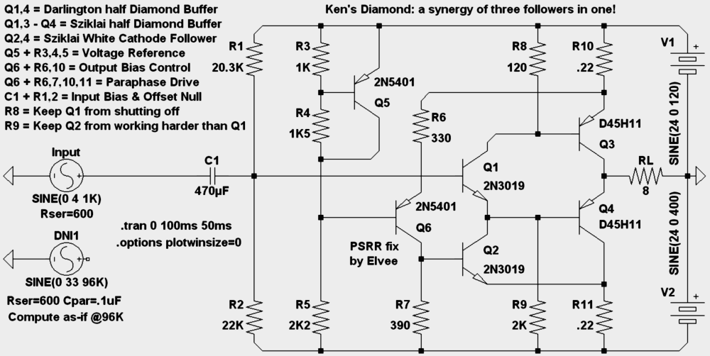

If I gotta use three parts to build a voltage
reference, might as well be an adjustable one...
If I gotta bias my input transistor, might as
well fix the voltage offset while I'm at it...
This sims much better without 600 ohms in
the signal generator. I just wanted to prove
to myself the 1000x current gain was real.

Joined 2009
Yar canna fix 2nd in that way, me bucko... Juma proves why.
But keep tryin. I still don't know exactly why the 2nd doesn't
cancel with equal resistors. But its probably just the emitter
of Q1's non-linearity you are observing.
The sum of voltage across R1+R3 is held constant in paraphase.
I'm messin around with class AB, by puttin Schottkys in series
with R1 and R3, to make a constant sum of non-linear devices.
This trick wouldn't work if R1 and R3 were greatly different...
The value of R2 also seems critical in achieving equal current
swings in the balance.

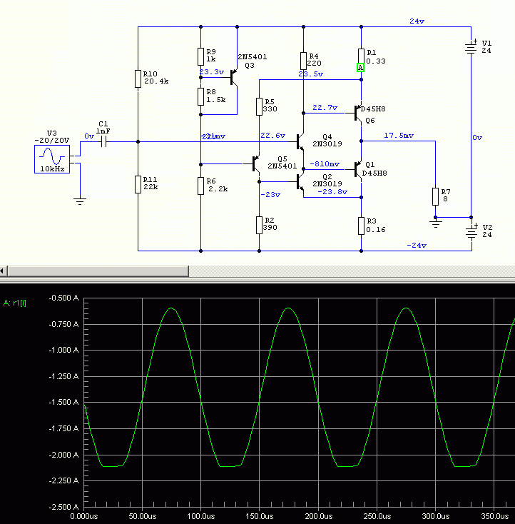

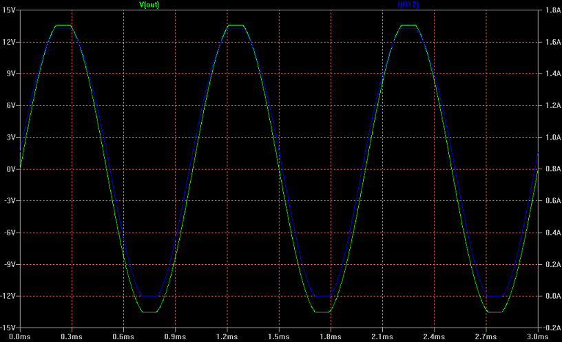

This is my idea of how to use the "JLH-follower". By setting the driver with a little offset you get zero out.
The plot is for output-voltage and current through R12 at onset of clipping.
This is just a concept, feel free to adjust the driver to work IRL, if possible.

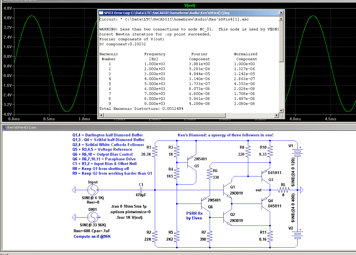

By making the ratio of R10 to R11 exactly 2, the second harmonic practically vanishes.
Hey Elvee,
Tested this with the NPN version and there the second-order is still dominating. Question is if that is negative. In the tubeworld chasing odd-order is the main concern.
I got rid the 2nd harmonic by lessening the 390ohm and replacing the
missing voltage drop with yet another transistor (strapped as a diode).
This fakes some I to V nonlinearity at the collector more similar to the
emitter circuit.
The weakness with JLH circuit is that drive current is held constant.
Way more drive current than needed for the quiescent state, just
to insure sufficient drive to swing rail to rail. I'm assuming this must
make the output transistors idle hotter too?
I still don't get the point of R12 in the collector?

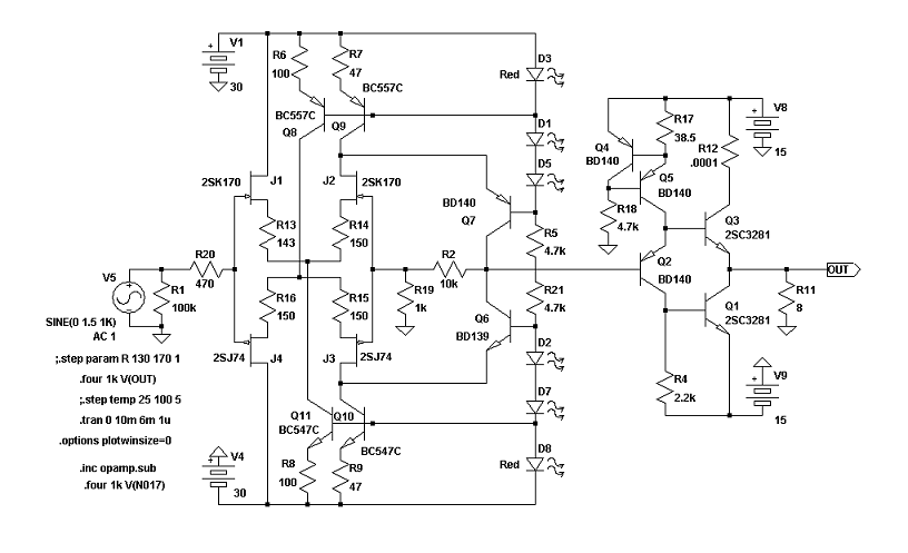

Initially, I had used different values for the collector and emitter resistors of the translator to compensate for series parasitics in the emitter and parallel loading in the collector. A E12 step was clearly too much, E24 would have been more accurate.
But instead of balancing the paraphase you can go the opposite direction and get good results too: here is an example with R6 practically shorted: H2 is below the ppm, and the overall THD is 15ppm. Unfortunately, it affects the dynamic as juma noticed, and is therefore not usable.
It is interesting to look at how well the paraphase manages to keep the sum of currents constant: the red trace shows the results, and it is pretty bumpy.
The green trace is the dynamic hfe of Q4, and it shows substantial variations, a 1 to 5 ratio, and also an asymetry near the top, meaning there are dynamic effects too.
For me, all this means the D45H11 are stretched beyond their limits, and most of the unwanted effects could eliminated by substituting half-decent devices.

Have been running som temp simulations on Ken´s and my follower.
By exluding some of the devices from the heatsink a quite good behaviour with just a few mV drift can be reached. The T-marked devices should be on the heatsink the 25´s should be kept at constant temerature. My needs some kind of extra comp as offset is ca 60mV from 25 to 100 degrees C.

Excess drive currents, not needed by the output during quiescence,
are bled off. So it isn't ever likely to run away...
- four transistor emitter follower (diamond buffer) as power output stage?
