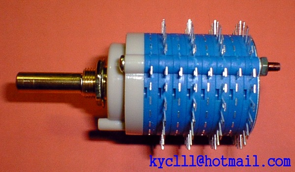

<IMG SRC="http://tw.image.bid.yahoo.com/users/0/6/6/8/kyc_111-img600x350-1068937145dsc00004-2.jpg"><br>

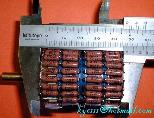

<IMG SRC="http://tw.image.bid.yahoo.com/users/0/6/6/8/kyc_111-img464x525-1068937182dsc00006-2.jpg"><br>

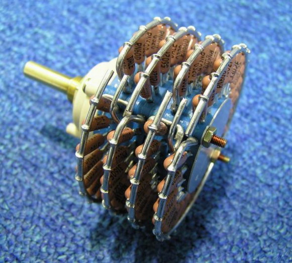

<IMG SRC="http://tw.image.bid.yahoo.com/users/0/6/6/8/kyc_111-img600x464-1068937227dsc00008-2.jpg"><br>

Hard stop or continuous revolution?
I saw something in the construction manual about using only 23 of the 24 positions so it won't have a 'full-revolution' design. Does anyone know if there is a hard stop at minimum volume to keep you from going past minimum to the maximum position (going directly from position 1 to position 24/23)?
-Greg
"Does anyone know if there is a hard stop at minimum volume to keep you from going past minimum to the maximum position (going directly from position 1 to position 24/23)?"
Personally I would not mind, I could probably make a mechanical stop however I think these are full rotary selectors without any dead stop...
I hope I am wrong but some year ago I saw similar rotary switches that were actually made for pc use being sold as readdy to assemble attenuators with the resistors in HK (very very cheap in store)
J-P
For info, I bought one of the EBay ones and received it in just over a week from Tawain. The build is excellent - it is certainly as good if not better than the picture. I know that given enough time and patience, I could solder one up reasonably well but I do not think I could come close to the quality of this work - it looks like it was done on a jig. I haven't tested it yet but if it sounds as good as it looks, I will be ordering more.
(No, I do not know the seller nor have I even communicated with him).
The rotary switches used to build those attenuators are nominally 24 make before break pos. switches.
You give up position #24 by putting a mechanical stop there, often just a small blocking screw.
I don't think there's a way to have all 24 pos. and have a stop at the same time...
Not having a stop there would be risky as you could go from dead quiet to full blast by just one click.😀
