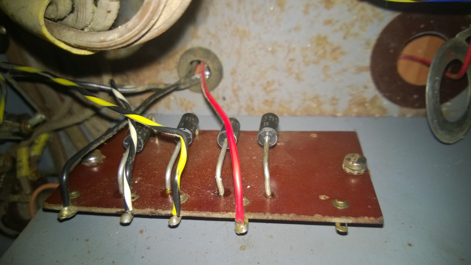

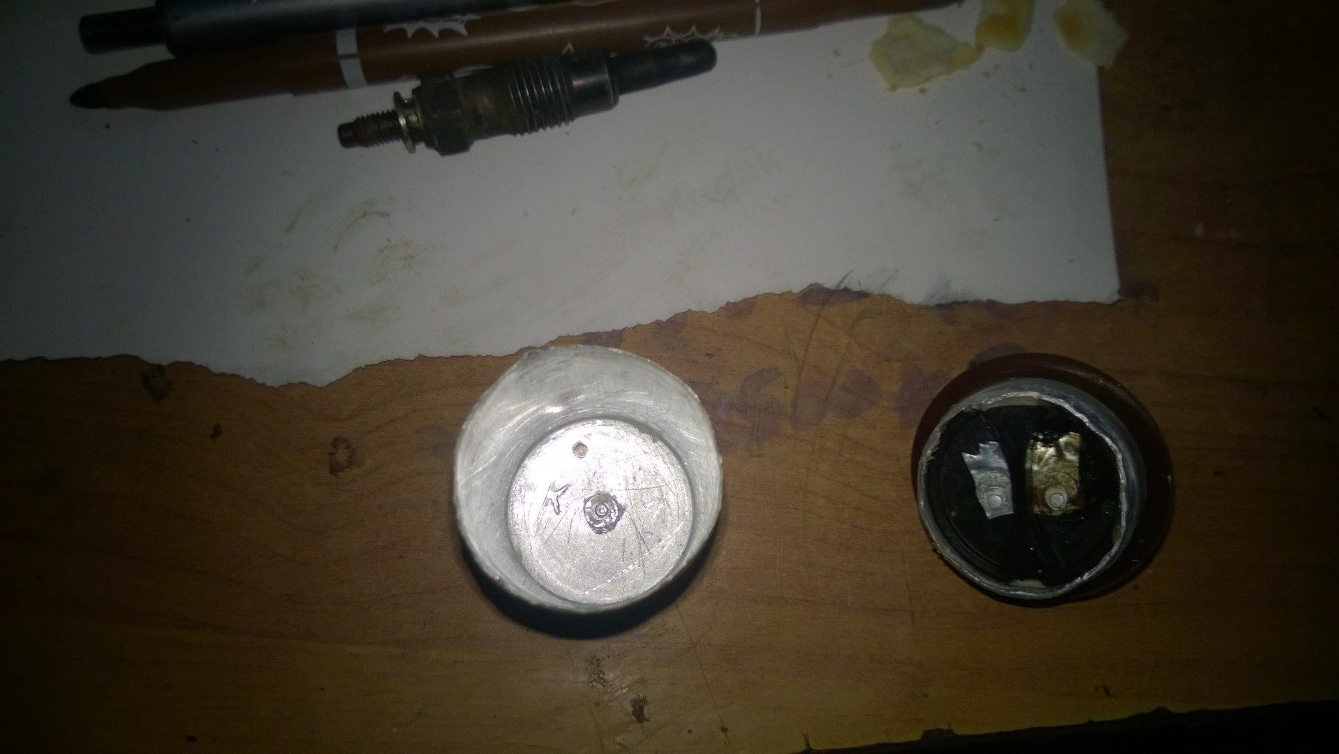

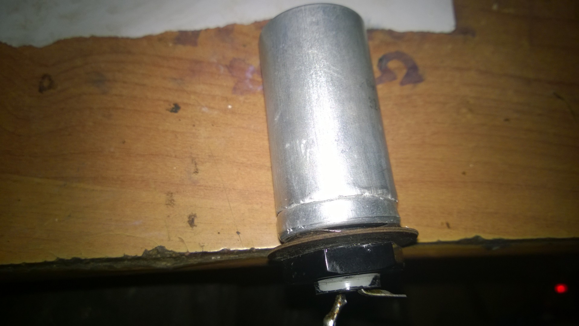

hi everyone
today i had a spare hour and replaced the rectifier with some new 1n5406 diodes i had laying around. they are rated 600v 3amps and peak surge current 150amps
i thought this unit had a selenium rectifier but it has a bridge of 4 si1.2 siemens diodes wich tested good on the dmm but were all badly rusted.
also started on repurposing the can caps
cutted them open on a place were they make now a "click-fit" and removed the guts and washed them.
fitted some 47uf old caps in place under the chassis just so i can still power the amp while new caps are ordered.
in spite this things the amp still hums like crazy....somebody told me it could be a bad tube but it hums equal on both channels. also its volume dependant and when i power it down the hum disappears and the sound is great for 3, 4 seconds before fading away
any thoughts?
tomorrow will try to take some voltage measurements etc and post
best regards
hugo

Hello hugobarbedo,
First get these new electrolytics in.
Use a light bulb in series with the mains to start up the amp.
If there is that hum again, Switch the amp of.
Remove tube Ro 9 and 10.
Switch on again.Still hum?
Switch of, remove tube Ro 7 and 8 and reinsert Ro 9 and 10.
Switch on again. Still hum?
Either there is still a problem in the power supply section or you have several bad power tubes or several bad cathode resistors.
Check the voltages in the power supply section.
That's at C50b, C50a, C11b, C11a.
Then at the power tubes,
Pin 7 - Anode, Pin 9 - Screen, Pin 3 - Kathode.
Do this for tube Ro7, 8, 9 and 10.
If these are all as in the schematic,
Remove RO 9 and 10.
Insert a signal in the amp, wich channel dosn't matter.
Check the signal at the din connector (at the bottom left of the schematic)
Pin 1 and 4 first (Signals A and B) - Preamps and mixers
Then Pin 3 and 5 (Signals C and D) - input to the phase splitter
But these signals are probably hum free. Why?
Because having two seperate preamp sections producing hum in both channels is very unlikely.
Let us know what your findings are.

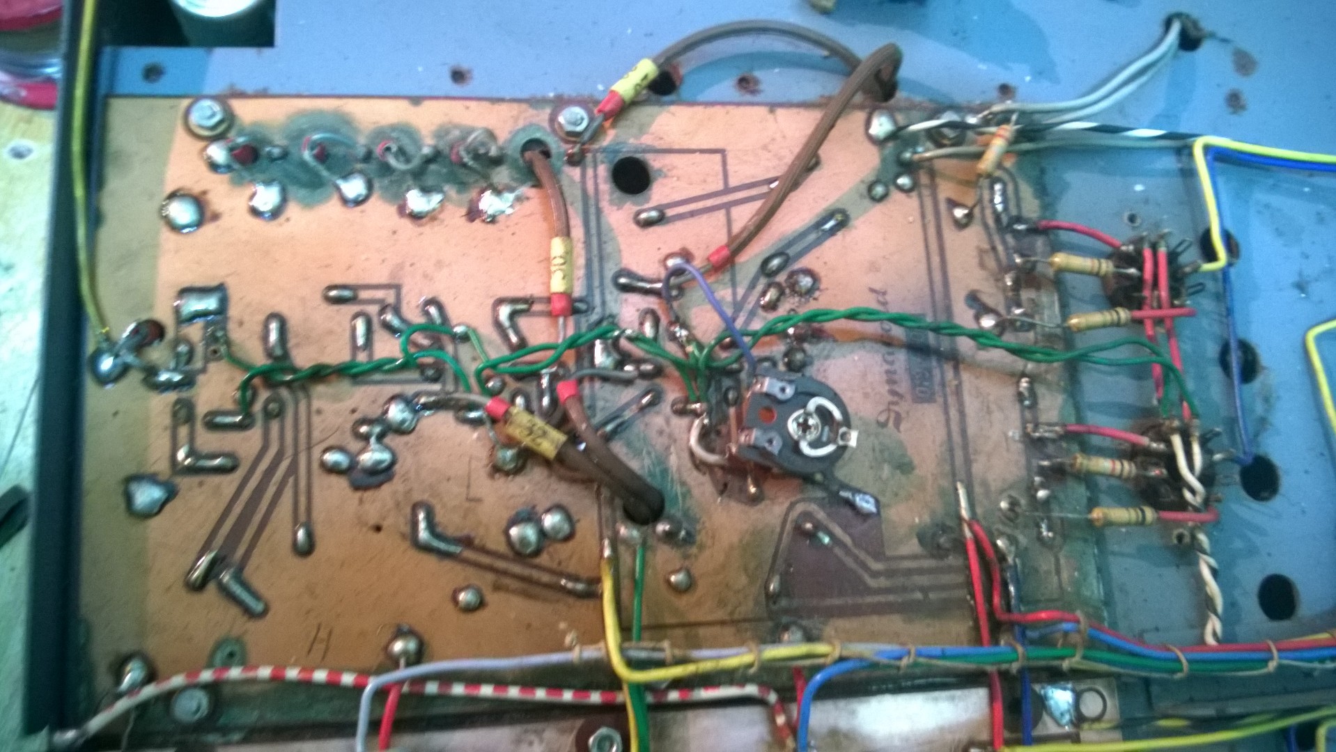

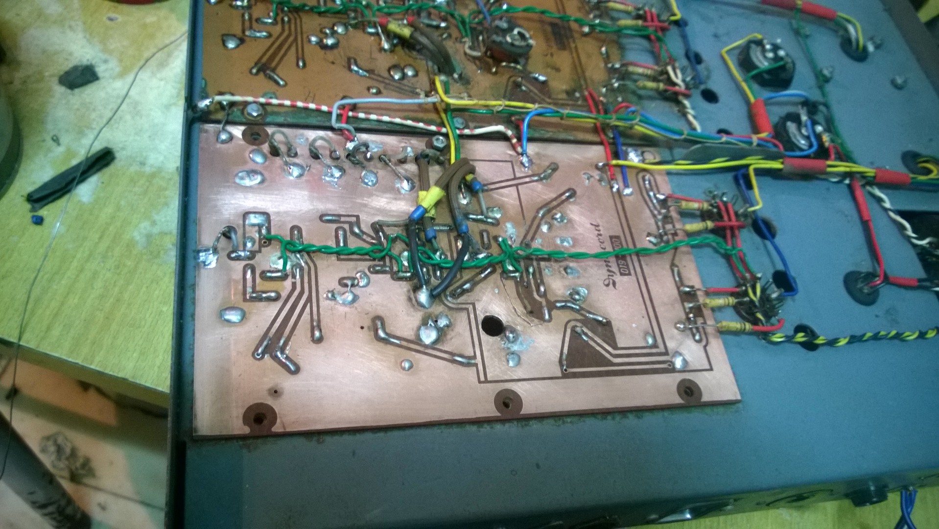

Hi everyone
this project has been sitting for 2 years now because my child was born, i had to move into a new house and make some construction work etc
anyway the tips you gave me will be very usefull when powering the amp again because i decided to fully restore it instead of chasing the problem.
i started the work at the time of my last post and now i have the amp on the table ready for some final wiring...
it was a massive pain beacuse i had to dessolder every wire in order to remove the components to paint the chassis because some components go out to the back and some go out to the inside of the case.
i will leave photos of before and after
i replaced every single capacitor and resistor for equal value ones
although all old resistors tested good but some were very burnt
before
now
before
now
