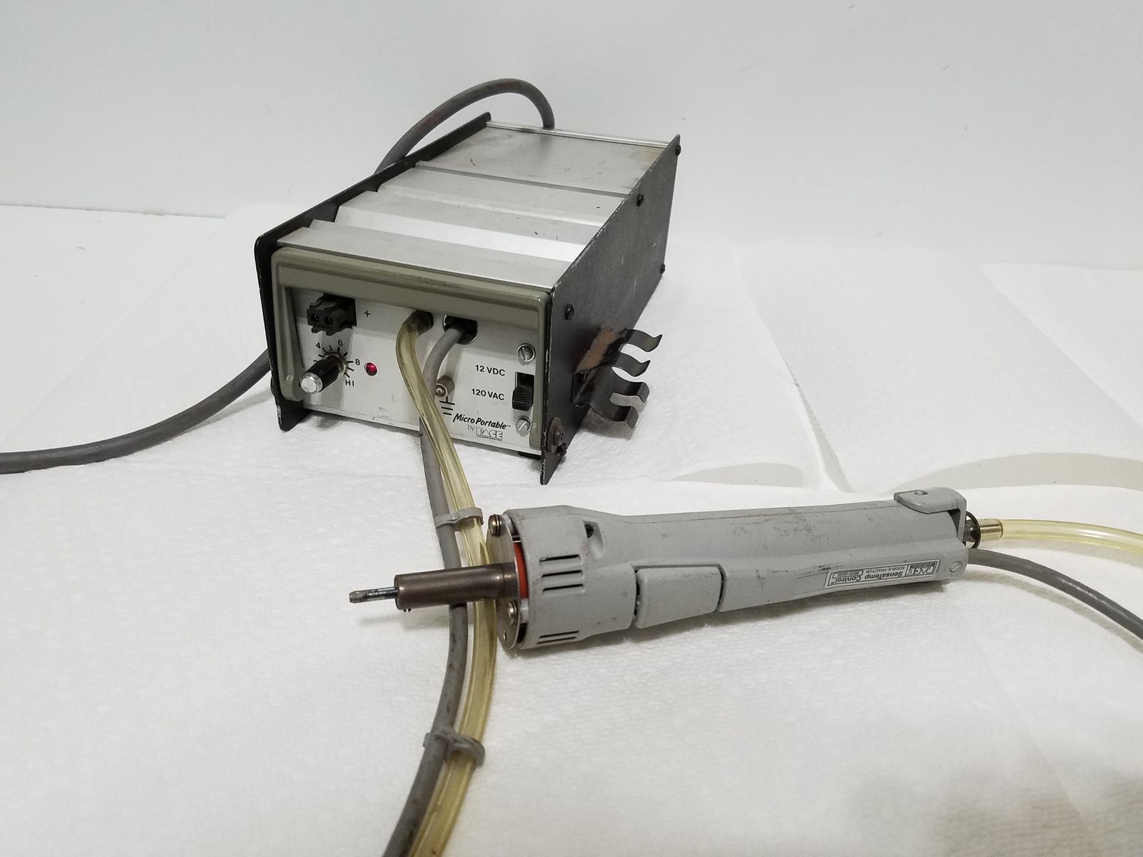

So I found a Pace MP-1 desoldering station w/ SensaTemp SODR-X-Tractor Handle for $75 shipped to my door. I know that Pace is considered by many to be one of the best desoldering branded tools on the market and rarely do they show on Ebay in any type of working condition. I figured even if I can't get the desoldering station to heat up the tip, I can easily get my money back with just reselling that upgraded handle/iron. That is if the problem isn't in the iron itself (I really hope not), but based on the quote below, I believe the issue is in the desoldering station.
The seller stated: "Tested to power on. Suction appears to work. The tip did not get hot. The main station makes a rattling noise when turned over."
I should have it by the end of the week and I wanted to go ahead and reach out for any info someone could provide if they have worked on this unit before. From what I can gather, this unit has not had any attempts to repair it once it stopped heating up the tip. I assume this because of the quote above, if they know something is moving around inside the case, but don't what it is; that makes me assume it has never been opened/worked on.
Opinions are welcome, even if you have never held this unit in your hands. The theory of operation of a normal soldering station should hold for any desoldering station aside from the vacuum pump. I figure another option is to get an affordable desoldering station off Ebay (station only w/o pen/handle) and use the MP-1's iron. This may obviously require some adapters/modifications.

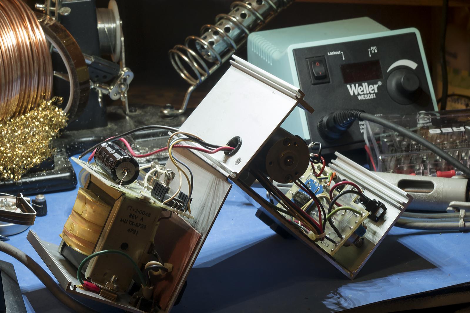

1. There are two bolts+nuts/washer on the back of the unit that holds the transformer in place. These two parts were gone and the entire transformer was sliding around inside which damaged the main filter capacitor on the PSU board. Where does the green wire (assuming ground) go by default running towards the rear of the unit? I assumed any of the two screws to anchor the green wire/(assumed) ground to the chassis would work.
2: The same green wire was floating around inside the handle. I need to know if this is a general ground where any of the 3 mounting places in the end of the handle, all should be the same unless I am missing something.
Noting else in the entire unit looked damaged except that capacitor from getting hit. The previous owner of this unit didn't even bother to inspect the cause of the "moving parts inside". Those moving parts were replacements tips in a storage area near the center of the unit, about 14 different tips in total in the magnetic storage bay.
I am confident I can repair this unit, especially if I can get pics of the stock wiring at the rear of the desoldering unit along with the end of the handle/iron wire that is again green.

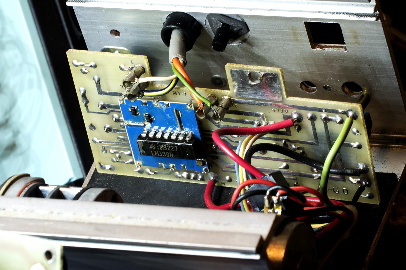

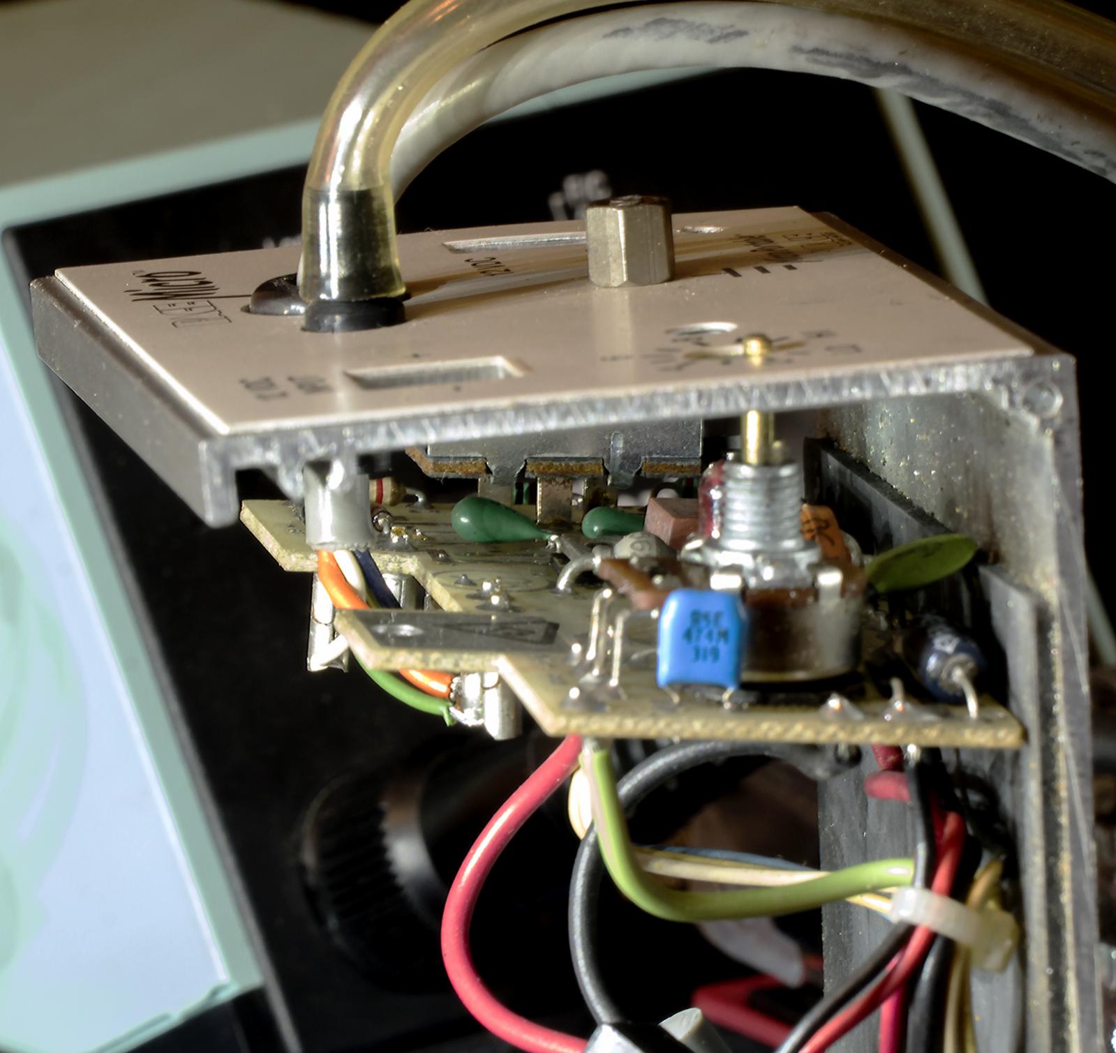

I changed out that primary power cap (4700uF/25V) and now the handle/iron is getting a lot hotter (using AC+Trans), but still not hot enough to desolder. It's probably 100-150F, I have attached a few pictures showing the internals of this unit.
The IC found on the Blue PCB looks to me like it is nearly melted, so I ordered a replacement (TI LM339N Voltage Quad Comparator) just to be safe. It is insanely hard to get a picture of the circuit between the switches/dials.
Does that Blue PCB (pic #3) look like stock parts or something someone tried to repair? I can't find internal shots of this unit to compare anything to. Also, I took out the diaphragm before taking pictures to allow more room.
So the question now is, what could prevent the tip from heating up past 50% of it's normal operating temp? I'd think either you'd get almost no heat or full heat, not sure how I fixed it 50% of the way w/ regard to tip temperature.
If anyone would like more pictures or better pictures of a specific part of the unit let me know.

The heat is a controlled circuit, not an on/off switch. There is a thermal sensing circuit in the iron. If that is compromised, it tells the base to stop heating when it is not actually hot enough.
Or it could be trying to heat, but the circuit that controls current to the heating element is compromised so it cannot turn fully on.
