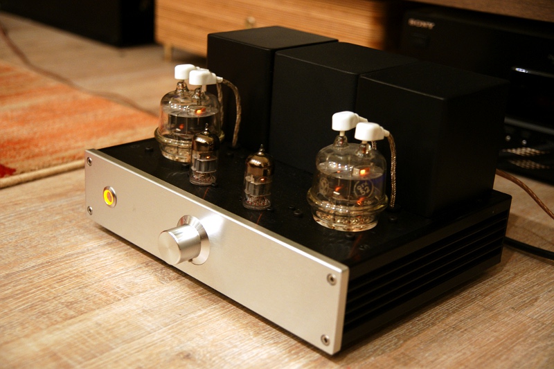

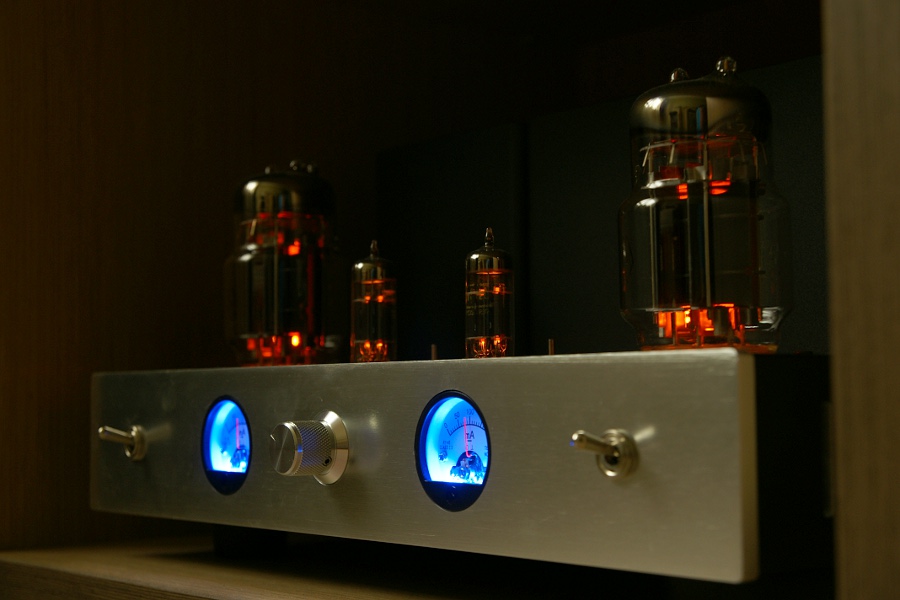

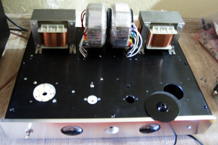

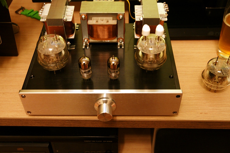

i used TGL series : TGL 20/003 for 6c33c SE and TGL 20/002 for GU32 PP . I also used power transformers from indel - all of them you can see in pictures.Only INDEL technical information could have been more detailed (weight, size etc)
regards. oskars
