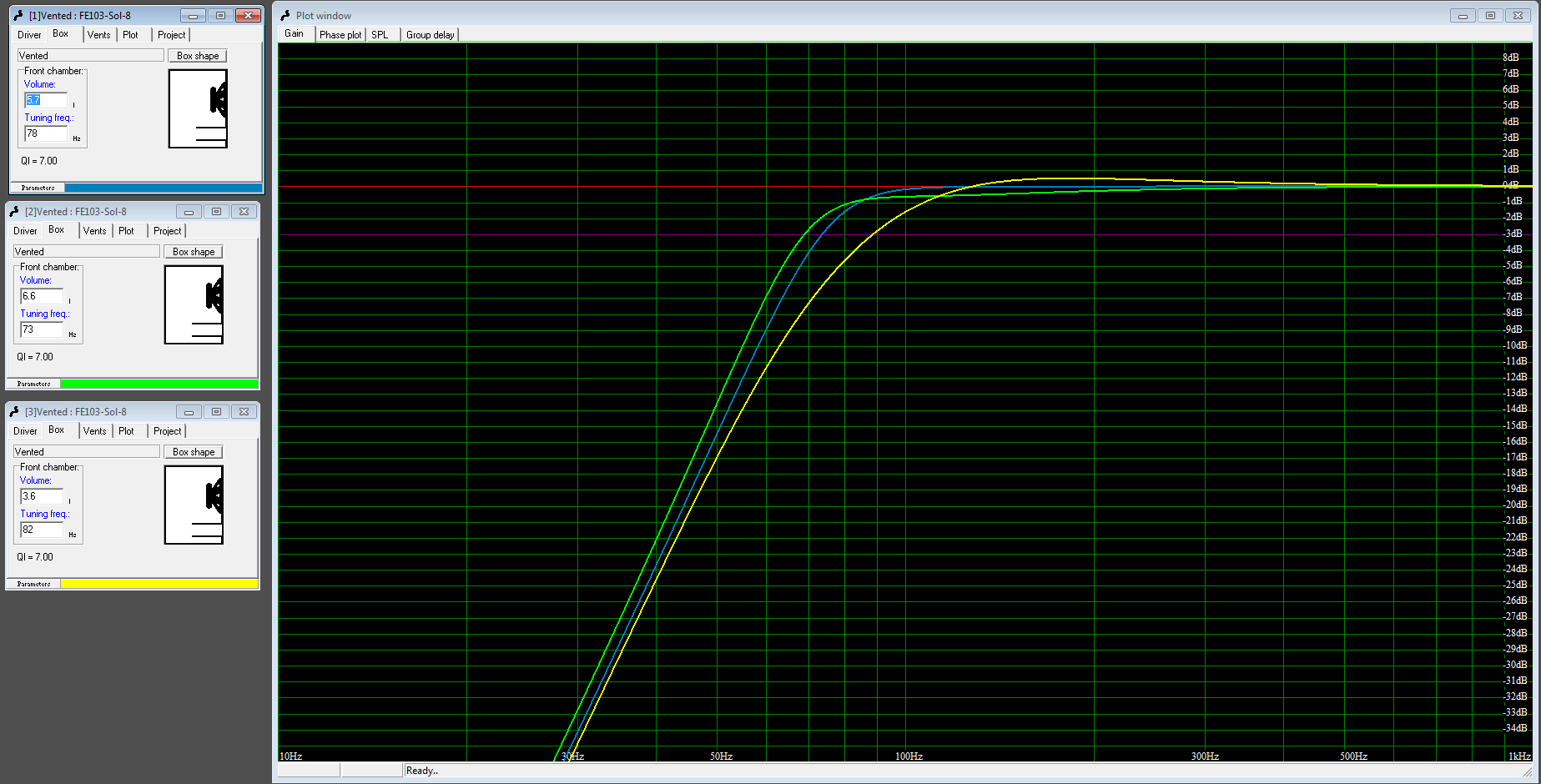

The Fostex recommended enclosure from the spec sheet of 6.6L tuned to 73Hz dimensionally works for me size wise.
(for the 8 ohm driver)
Unlike many Fostex recommended boxes that isn't too bad. 5.7 at 78 looks better if you use a round vent.
Should work fine in a standard millSize box…. that might well be where ours end up

6.6L looks better to me.
smaller boxlooks better to me… with BS droop the larger box is going to start getting a bit lite in the bottom.

I meant that the 6.6 litre design looks better than the 3.6L one, which has a bit of a hump.
bs has not posted any 5.7L sim with 78 Hz tuning yet.

Yes, i know that. The 3.6 L sim looks better than the 6.6. With a small speaker I'd rather have a tiny bump than a roll off that starts too high.

Thanks . I am relatively new to this all so I very much appreciate the thoughts.
The 5.7L as you suggested certainly seems flatter without the early roll off of the larger 6.6L cabinet. Which do you prefer the 5.7 or the 3.6L?
What are your thoughts about rear porting if the cabinet is close to the wall?
Reading some other threads I picked up on some suggestions that this can help a small box.
With a round vent (not something i'd personally use) the 5.7 litre box. With the high ratio vents i use (they add an R to the vent) something a bit smaller that models with a slighly bigger bump, but the R knocks the bump down with the added benefit of greater tolerance to dynamic T/S changes.
Given that it fits into themillSize box we already have, i'd make it work in that.
