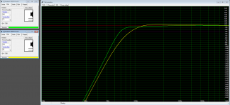

Ill probably build some basic Bass Reflex boxes. The Fostex recommended enclosure from the spec sheet of 6.6L tuned to 73Hz dimensionally works for me size wise.
To be honest I'm even tempted to go smaller - like the Fostex P1000E cabinet which is only 3.6L tuned to 82Hz.
I do wonder if I move the port to the rear of the cabinet and place the rear around 4 inches from the wall if the boundary effect would be beneficial for this use case?

Can you pls share the sims you are getting from 2 box designs you've mentioned?

Sure thing. Please find it attached. 🙂
I assume the smaller box could be tuned a little lower to flatten and extend it a bit. These are Fostex's designs and tuning frequencies.
