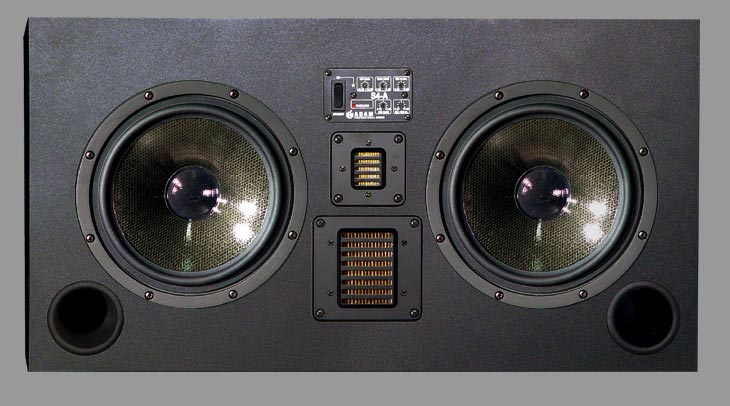

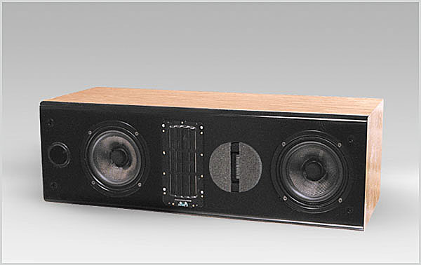

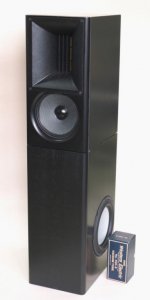

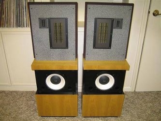

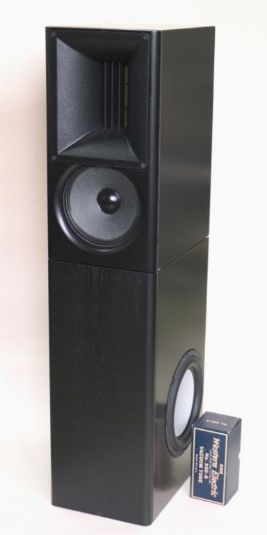

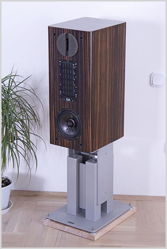

Found some pictures online of similar designs.
This first picture shown below is of the Fostek rp-1001 which seems to use same ribbon mid-range and tweeter combination as the RP-9 set that I have. There was another higher model with larger ribbon elements which I decided not to post.
The second and third pictures are of VMPS speakers that seem to be using the same size and possibly same make of tweeter and midrange. I put pictures of both styles to see what options I had for woofer styles and mounting.
The last 2 pictures I am too lazy to look up where I got them. But I do like the idea of a ribbon with a wave guide.
Still have not found any specific information on the older Fostex speakers. But this is a step in the right direction on figuring out what to build for my next project using these drivers... I won't know what to do with them until I know what I have. I have never owned anything with a ribbon on it. 😀
I am using this thread to collect info on this model of speaker, and similar designs for the most part. I will start another thread when I figure out what questions to form regarding actual design options as I start working on the "project".
If anyone has seen speakers using similar driver set ups, please post pictures and details. The more information the better.

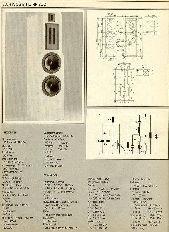

These units (couple of Fostex RP9) borns for car audio use.
In italy the price in the firsts 90's years was $ 6.000,00 circa and ideal mounting on back panel.
Excellent sound and very low distortion, isodynamic technology, dipole function (mid and tw).
The kings of car speakers.
I think better listening use in home.
Nice to see an old RP-9. Its an old CarAudiosystem from Fostex, equipped with a FW220 Woofer, a FS21RP midrange and a RP7 Tweeter. They were launched in the mid of the 80ties and were the NO.1 of the CarAudio scene for a long time. I have heard them several time, a friend runs a ACR (former Fostexdistributor for Germany) Store and he has it installed inside his 7 BMW, together with a pair of 18 inch Woofers in the trunk! The front was equipped with some Boston stuff and driven by Alpine Electronics. That was a fun system, and one of the rare cars that are not only loud. It was incredible loud but it also sounds great! Really a pleasure to hear music in it!
Sorry, a wrong notice: in the past in italy price was $ 3.000,00 circa.

Todd,
This is a direct replacement for your bass mid driver Fostex FW 220 by ACR (discontinued).
Volt BM220.8
You can use the same crossover (is it available/not broken?!).
As I was saying, they are very similar and if I find a better one (driver in production) I will post.
The drivers are very similar but as you know (and between good drivers also) it's difficult or expensive, or impossible like in this case, to find a very high sensitivity driver that matches the Fostex because those are generally the most sensitivity in the world "aux pair" with TAD's and others.
So, this Volt driver has about 07.dB lower from the expected with the Fostex speaker. Try to experiment and if it misses something and you need that extra sound swap the inductor* in the woofer section of the filter (if it has one) with one with the same mH but lower DCR.
If not and if you are going to use another woofer make it (driver) flat in frequency to ~2K0/2K2Hz and Re 6.6 Ohms. You can always use a pair or 4 woofers but use the same impedance for the crossover and try to get ~91.0 dB/W/m (or up, that has to do with system Q/crossover/alignement and is possible to calibrate/simulate when designing new speakers). If not you will have to make a new crossover. 😀
*)This is an example:
2.0 mH air core Jantzen from Parts Express = $11.00 each = 0.80 ohms DCR
2.0 mH iron core Erse from Parts Express = $ 7.49 each = 0.26 ohms DCR

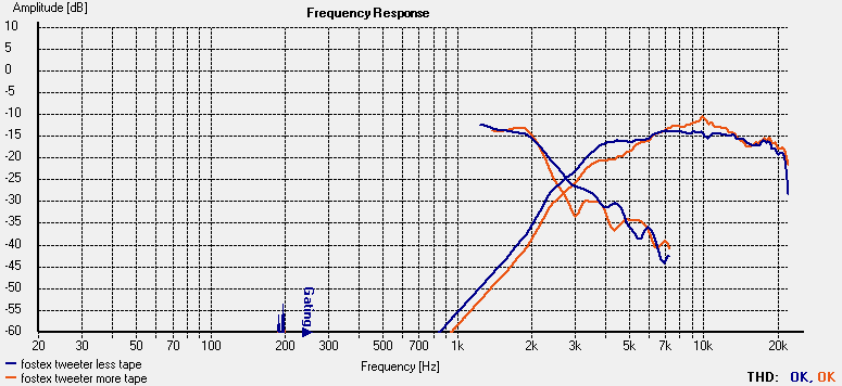

After measuring them on holmimpulse, I am not happy with what I see.
The distortion is plotted as well on the graph.
One tweeter has some issues. Not sure what it is. I did see that one of the magnets has a crack in it, but it has not moved and is where it should be. Since the tweeters are so different from each other, I may just take one apart just to see what is up. I don't plan on using it now, anyways.
I definitely can't afford new fostex ribbon tweeters right now.
I can buy these in the future: The Madisound Speaker Store (fostex ribbon tweet)
Or look at other less expensive tweeters. My hearing is crap above 7k on my right ear, anyways.
I may consider looking to see if there is a replacement diaphragm available.
The good news, is that the frequency response for the midrange is where it should be, and both are completely identical. Absolutely no variance between the two.
