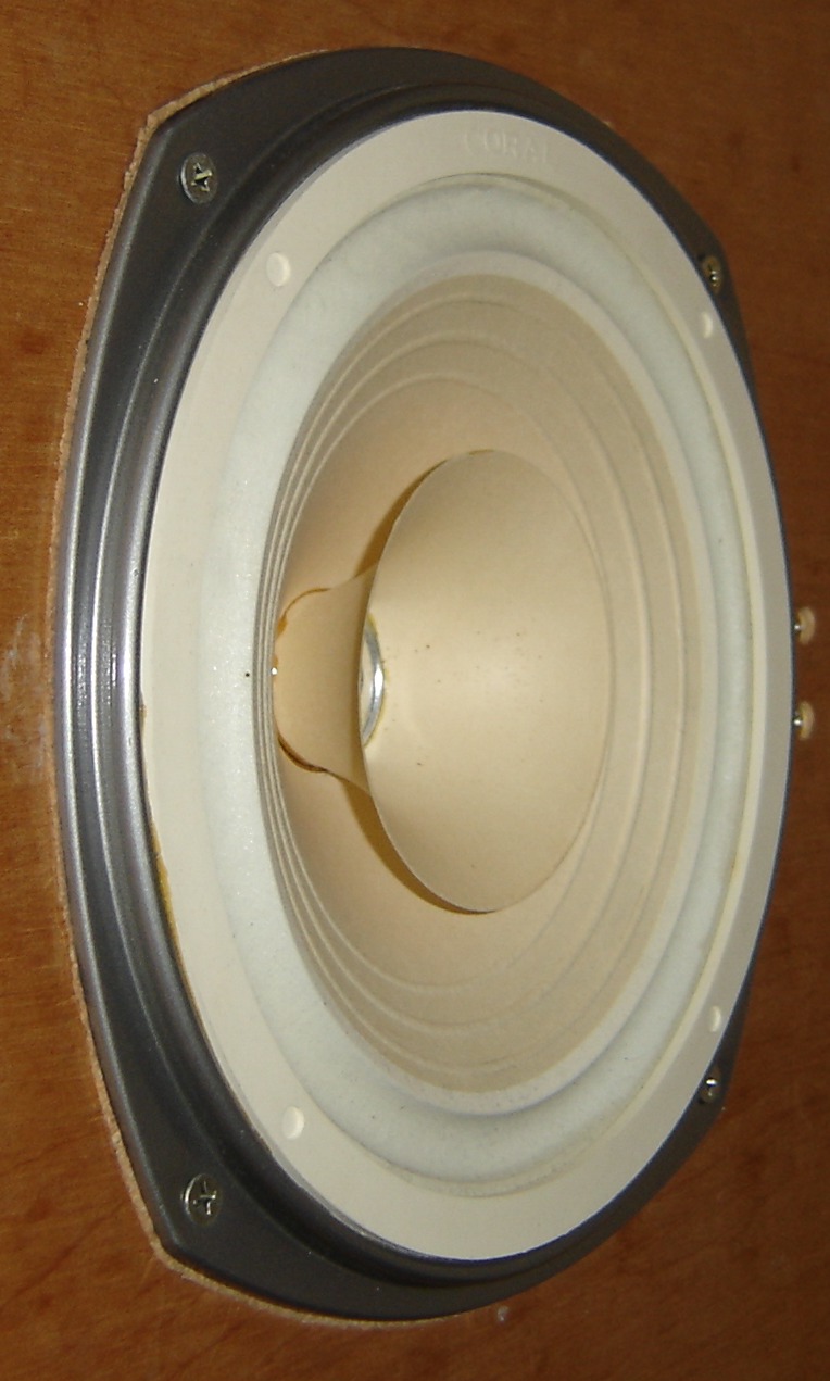

My MkII's are a yellow not cream colour as well, and look very much like yours. (Most Flat 8's are white/cream) I've attached a couple of pics of how they looked when I first got them. They still look much the same now just slightly dirtier 😉 There is also a little bit of cracking of the rubber gasket around the edge for no apparent reason...(I notice the important gap between the dust cap and whizzer cone I mention in the previous message is quite apparent in that picture...)
