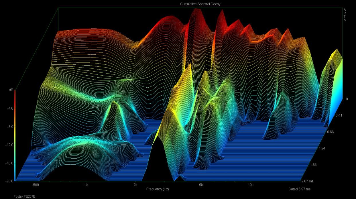

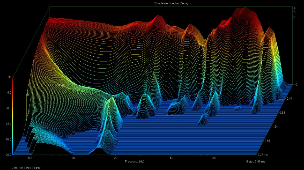

Anyway, that's about all I know about cone tweaking on Flat 8's, so to finish off and provide something quantitative I've attached some CSD plots of my two tweaked Flat 8 MkII's, and to provide a frame of reference I've included the CSD of one of my Fostex FE207E's to show just how much cleaner the Coral's are.
Ignore the humps below 2Khz which are diffraction effects due to mounting the driver on an open baffle during the test. The Right Coral is the better one of the two in every way, there is very little resonance at 2.4Khz or 3-5Khz or 8-12Khz for that matter. It still has the dust cap (albeit dented) fitted.
The Left Coral is not nearly as good and is suffering from a minor(ish) 2.4Khz resonance due to the dust cap being glued directly to the whizzer cone, and it's perfectly obvious on the graph. However to put it into perspective compare that to the severe resonances at 2.8Khz and 4Khz of the Fostex driver.... 🙂

It's important to not just measure the frequency response, but also to measure the CSD to see when you are really targeting the resonances. On a driver that's large for the frequencies it's producing you can get peaks and dips in the response from non-resonant phenomena, and you can't easily tell these apart on just a FR graph without also referring to the CSD, so you can end up chasing resonances that don't exist, or making the response look flatter (at one point in space) whilst actually making a resonance worse. The CSD always tells the truth.
As I said, of all the tweaks I think this one is the most beneficial, and it really "cleans up" the response of the driver to a very high standard if done right. (It is tedious, time consuming delicate work though, as peeling the strips off to reposition them has to be done very carefully to avoid lifting the surface of the paper...)
