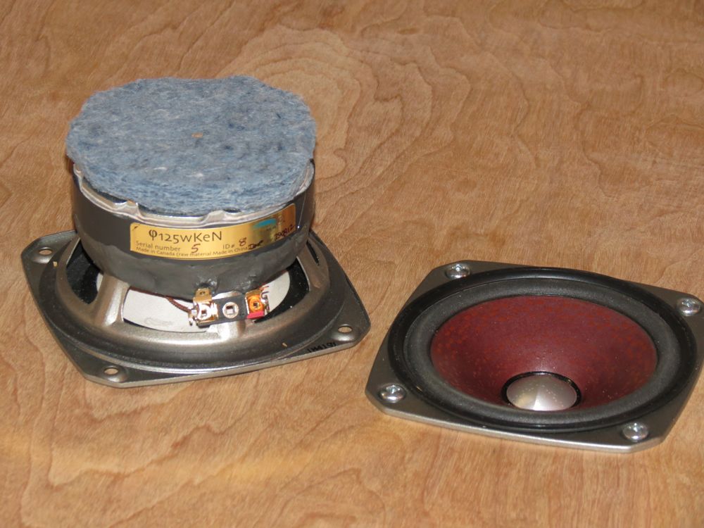

The cone treatment mine received leads me to believe the harshness has been removed.

So did you hear any improvement with those drivers? What about Zig glue around the rim of cone and surround?

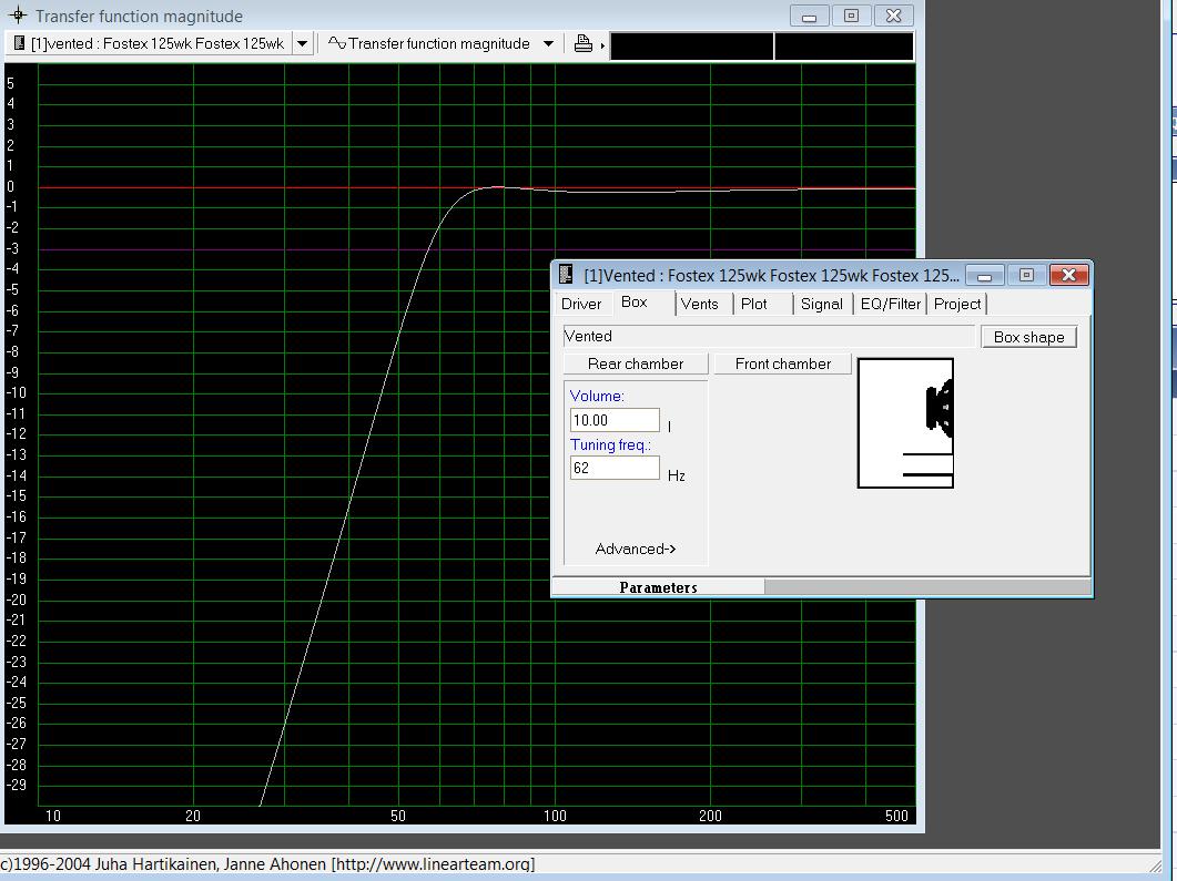

Also wondering if someone can tell me what should be the tuning frequency of box for FF125WK.The data sheet says 67 but may be it is a little higher like in 70?
