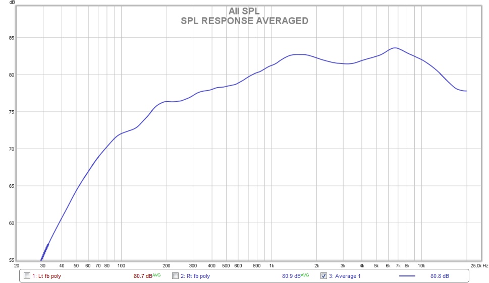

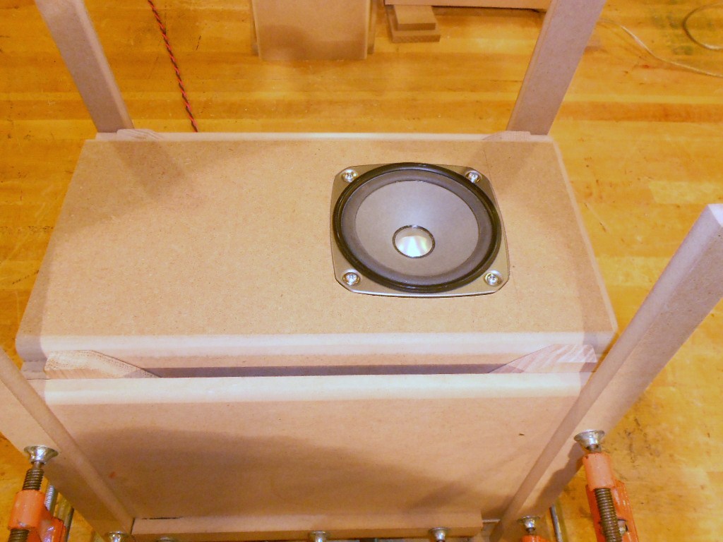

After brief discussion and getting tips, I went ahead and build a FF125WK BR enclosure using datasheet measurements for enclosure provided by Fostex in Datasheet/Manual.
I was looking for a better midrange reproduction for vocals ,violin and male voices.I have to say I have not been disappointed with first few hours of listening.
As expected it has slight harshness at around 7KHz region but can avoid by keeping speakers off axis. Bass response is not bad for the tiny enclosure but may need help with BSC filter.
Very mellow to listen to vocals,not good for plays with lot of instruments playing and not for heavy rock.
I am wondering what should be the baffle step correction to use?
Please see the SPL response 1/1 octave smoothed for easy interpretation.

Honestly, I haven't had much luck using any type of Bsc filters before, but you can try an inductor (around 1mH) and resistor in parallel (around 8 ohms) to flatten the treble response. Or for a more notch type filter to cut around that 7kHz region add a cap (around 4 mF) in parallel, so Lcr type filter. Perhaps, worth a try if you have the parts lying around.
However, I prefer to let the driver run unimpeded by any crossover components in the electrical path. Instead I would run a woofer at 700Hz as recommended in the Fostex lit that comes with the driver. Quite clever I may add for Fostex to sell more drivers, but with the smoothish response of the 165wk or 225wk plus the single inductor albeit largish, it should sound pretty good. Also, I do like how they leave the "main" driver unmitigated/pure. Overall a pretty good compromise for "singlish*" driver type speaker.

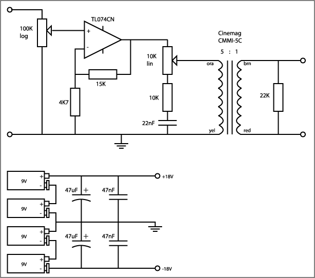

IG,
Thanks for the link to the very simple line-level BSC circuit. I have all those small signal level parts already - saves me from buying a pair of pretty hefty speaker level inductor coils and high power resistors (which would end up costing more than the drivers) - not to mention fact that amp power is being wasted on heating the resistor at higher frequencies.

I've built more than a couple of Fostex "recommended" enclosure designs over the years, and with the exception of the larger BLH for 6" & 8" FE series, most have been remarkable in their shortcomings in LF extension - which will certainly exacerbate the need for BSC in this size range.
Certainly there's no argument that as many things as a 3-4" FR driver can do very well, there are few that couldn't benefit from HP filtering and bass augmentation (call it FAST, or just 2 way with low XO - whatever you like)
Fostex FR drivers are beloved / notorious for long break-in periods ( as much as SEVERAL hundred hours) before they fully "open up / smooth out", but even then, for many folks the 4" size particularly retain some issues of narrow band peakiness / harshness in the upper midrange that are not well addressd by wide band BSC or EQ. While there are some physical cone treatment regimes that can mitigate those issues, in many cases narrow band digital EQ is the most expeditious method of correction.
BSC "balances" FR response works by attenuating above selected frequency, and certainly can't improve the driver's basic excursion limitations - regardless of whether at line level or passive, you'll lose overall SPL capablity
If kinku's application precludes larger enclosure volumes than the 9 liters of the "factory" BR design, there may be little option but careful EQ (i.e. more than just the BSC) with the resultant reduction of maximum SPL / excursion capabilities, which in very near-field situations is not necessarily a deal breaker.
If on the other hand there's space available to accommodate larger monitor size or even floorstanding enclosures, there are many designs that could substantially extend this driver's LF performance:

Thank you guys.I am wondering which one would be better line level BSC or outputlevel correction or Digital EQ which will take care of slight peakiness around 7kHz.
PlanetM ,IG any more details like a circuit diagram with opamaps available?
Here is what I built.
I started with a TL074 and then switched for an LME49740. The 100K pot is the volume control and the 10K pot is the adjustable BSC control. The 10K and 22nF are calculated with Rod Elliot's method, depending on your baffle width. The output transformer was there because I had it for a while and had no other use for it. It solved a hum problem in that specific system though and boosts impedance for the BSC circuit, but is not necessary. A 2:1 or 1:1 would have been better in any case, as I barely had enough voltage swing to drive the amp. I ended-up using a mains power supply as batteries did not last very long.

Thanks IG. But the circuit is still complex for me to assemble.Will it be possible to get something detailed to the final level like where input /pot goes ,where the power goes? I have never been good working with basic level ideas.hope you can help?
I saw MJK zobel+ BSC for Lowther,which will be better,working at line level or at speaker level?
