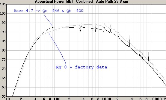

My sense is everyone is awaiting a more firm Zout number from a measurement to best provide commentary. If you have a couple dummy loads (maybe 10W R's, pref non-ind, or 5W if you are fast), all you need is a quick delta V over delta I for a couple values of dummy load. It's just too dicey for these lower-Q driver + SET amp pairings to go in blind and hope. It need not be a highly accurate Zout for this, people just need to know if the thing is closer to 2 ohms or 5 ohms or whatever. Then the box tradeoffs can be juggled more confidently. I don't know those drivers at all so I'm not the guy to ask regarding balancing compromises.

BTW, just saw your Keithley & loadline Python stuff -- nice 🙂 Did you build the amp? If so, I'm feeling better about asking you to get a couple AC voltages across a dummy loads. If you are a spice-head, maybe you already have that amp modeled and can just drive it backwards (w/ and w/o the Schade strap) and plot V/I to verify veracity of my swag. The way I see it (could be wrong), the Schade 200k is just another thing in parallel to the plate resistance and the OPT load so it drops Zout to maybe 4.2+ ohms. Adding back some (say) half an ohm for a bunch of wire (another question for you to answer--how far/long), the Qts' is .42 (Qes' .442). If I'm right, no matter what it is, the Fostex recomm reflex box wont have the LF you seek for a single driver only type speaker but you could easily grow the box some as mentioned by others.

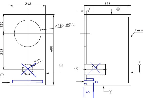

Thank you @grindstone. No tweeter will be used. This is for a small living room area. 20 square metres approx.

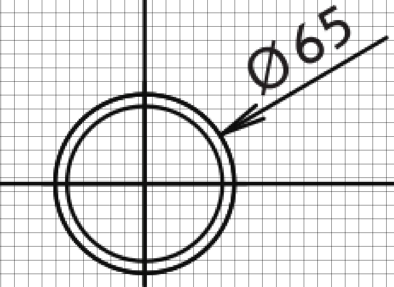

Regarding the circular vent port. Can I just replace it with a square (full speaker width) front vent at the bottom?
The circular area is rather small. If replaced with a square vent, full box width, I imagine the height of that new vent would be really short. What's the math behind this? What about the length of the port?

Yes. I assume so, but not that simple if I'm following due to major differences in pipe end correction, high aspect ratio acoustic resistance losses that usually requires some fine tuning (critical damping) of the vent design.Regarding the circular vent port. Can I just replace it with a square (full speaker width) front vent at the bottom?
Output impedance seems 1,59ohm. (signal of the Sig Gen is 1Vrms at 1Khz).RL=120.4ohm,A1=1.457Vac,A2=1,438Vac)
Perfect--thanks. So my impedance theory of single-stage loop feedback was crap because it inverts 🙂 Thanks for that.

After a look, the slot port along the full width of the bottom (with your driver move to the wide side) would get too thin/high-aspect to be functioning similarly, so here's one the shorter way (depth direction) that should get close to the same tuning that the round port in the plan achieves if you still seek such a thing. It's still pretty thin/high-aspect ratio but requires no fancy work. The net size of the reflex box in the plans is basically a cubic foot, give or take so the factory reflex tunes 37-ish with the driver param adjustments.
Hi @emartine - I don't know that it was a suggestion, just an effort to make an equivalent tuning to the plan that satisfied a slot shape and bottom location. I just eyeballed the port to be ~55mm/23.8cm2, flipped k-factors for bottom slot tuning and shortened it until it was the same as what the recommended VB was with the 1R59 source-resistance-modified numbers for the driver, the 37.some indicated above.
