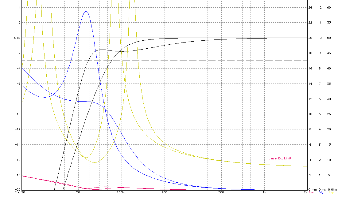

I never trust Fostex’s reflex boxes.
Checking this one, looks like a pretty ugly alignment (not as bad as some i have seen). The nice sim is 12 litres, does much better thzan the previous FE206.
dave

T/S max flat alignment (no Rs):
Vented net volume (Vb) (L) = 20*Vas*Qts'^3.3 = 11.78 L
(Ft^3 = (Vb)/~28.31685) = 0.416 ft^3
Vented box tuning (Fb) (Hz) = 0.42*Fs*Qts'^-0.96 = 68.42 Hz
F3 (Hz) = Fs*0.28*Qts'^-1.4 = 82.51 Hz

you suggest this speaker on a 12litre box?I never trust Fostex’s reflex boxes.

is that the black curve? whats the yellow one? cannot really see it
yes, thats the main variableReally curious why you chose that particular driver for a small BR enclosure? Must have something to do with efficiency.
The black line without the whoops*. Yellow is impedance, red is excursion, blue is group delay.
The FExxx drivers typically want to be in a horn if you want bass. Or you put it in a selaed box (7 litres) and cross to woofers at 120 Hz (Bottlehead style).
dave
*(a guidline i follow is that the 1st derivative of the FR does not cross zero more than once. Quality over quantity [or in actuality, LF extension]).
I looked up the T/S parameters of your Fostex & plugged them into the WINisd beta simulator. The program processed all the parameters, selected the vented bass-reflex as the best choice...as shown by an obvious Efficiency bandwidth product pushing one-hundred. The "factory suggestions" of enclosure volume & box tuning frequencies (fb), I felt could be reworked slightly to get some extended bottom end abilities.thank you. what software did you use for sim? do you have the same pair in Bass Reflex?
By manipulating both box volume and frequency, one can get better performance. By paying attention to the response graphing & manipulation of the numbers, one gets a larger box as your attempting to increase low-end performance.

What would you suggest to get a little better bass performance?
May be changing vent tuning?
F3 at 82Hz might be a little too high for my taste.

It seems like Fostex recommended box is designed for use with high resistance amps like SET or similar. That gives higher Qts, so vented box aligment can be shifted to bigger box and lower tuning.
If you have low resistance amp like standard transistor type, just add 2-3 Ohm resistor in series with driver. That will boost the bass and smooth the response. At expense of some efficiency.
Yes, that's the usual. Until the NV series the baseline assumption was that they were on the end of a SET or similar with about 2ohms - 4ohms output impedance depending on driver model, or were going to be used in a fairly typical small Japanese space, potentially leaching LF that might disturb neighbours & the like, hence some of the alignments that can look a bit odd to others, often entering some form of EBS or similar trending. With the NV series, that's changed a bit; they're a bit nearer to the values of the old FExx7E series units. Still better, at least in the case of the 206, with a higher amplifier output impedance than a typical SS amp etc. provide. A series resistor as suggested, or resistive speaker wire can help if you don't have a suitable amplifier & want one of the larger cabinets but with a slightly more linear alignment trend.
