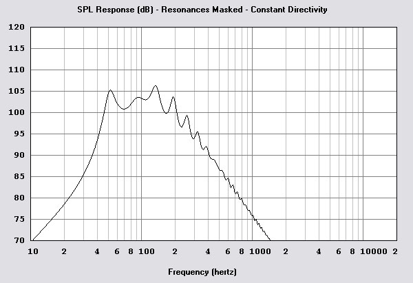

Hi there,
I've been simulating a horn in hornresp and have a problem. Hornresp requires Cms in m/N, but if i do that, i.e. 0.00000182 for the fe166e, the results seem very strange and not what I expected. If I repeat but change it to 0.00182, as if it was asking for mm/N it seems fine, the spl result of which ive shown below. Any thoughts?
Steve

Hi;
You can double click on the CMS box and fill in the values that it asks for and then the program calculates CMS. When I tried this with the values for the 166e, I get 0.00182, so I think you are right to use that value.
Hope that helps.
