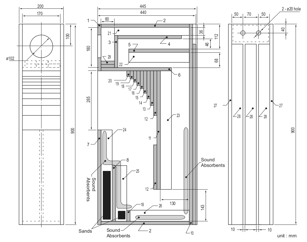

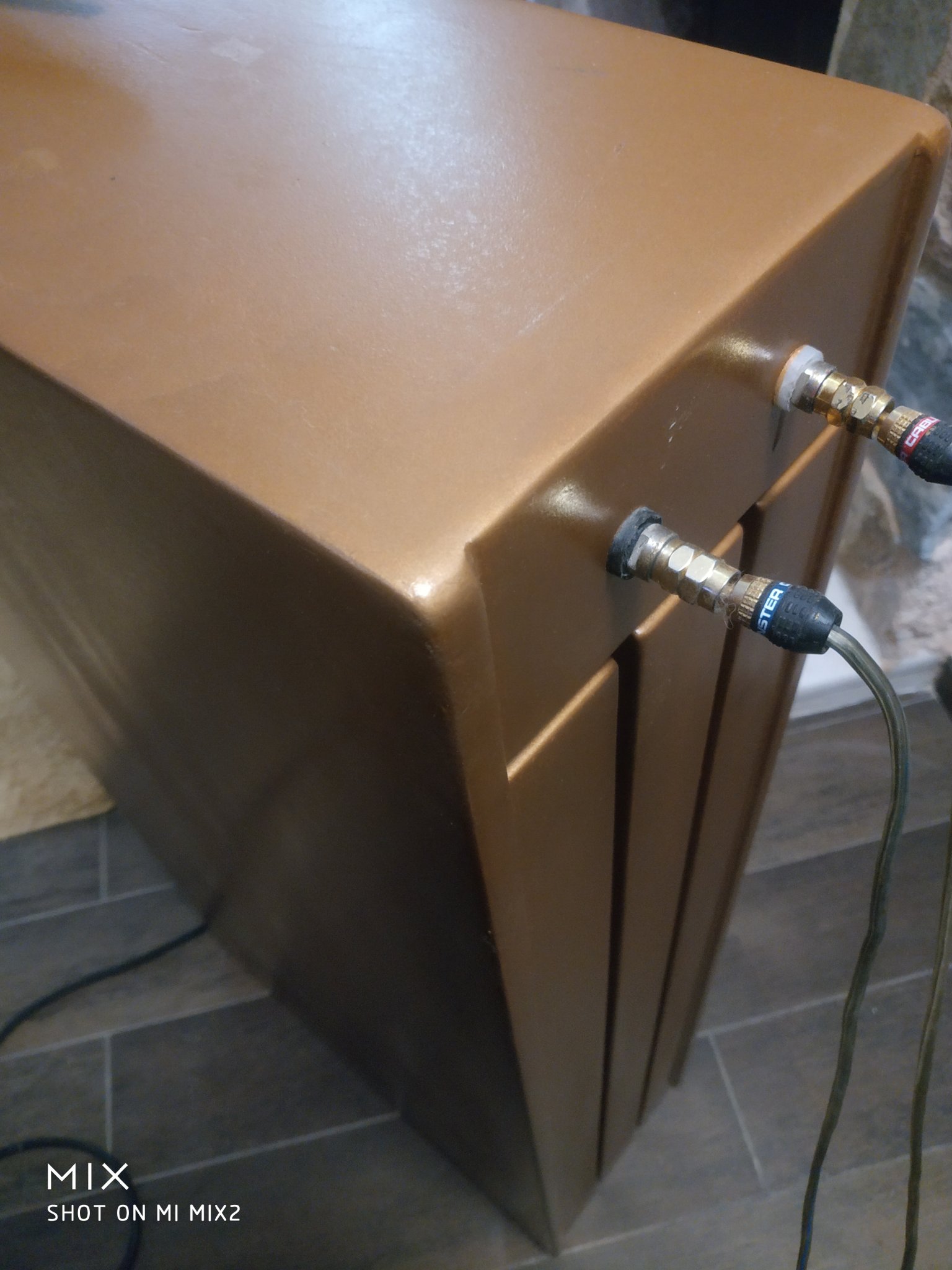

I am very proud about my DIY backloaded horns based on the FOSTEX FE 108 EΣ sigma 4"inch fullrange speaker.
The cabinets construction plans were downloaded from Fostex.
I have Recently modified them in a two way speaker replacing the Fostex 4inch with an ETON 4 ohms midwoofer and adding a 4 ohm tweeter.
My crossover is divided in a 4th class for the woofer and a 3d class for the tweeter.Still expirimenting on these crossovers but the results up to now are excellent.
Fostex FE 108 EΣ sigma 4"inch are great speakers but a little bit harsh in the mid and higher frequencies.
Now the lower frequencies have more warmth and power and the mids are warm and sweet sounding.
When i am placing the speakers close to the back wall the bass production becomes huge and fills the room 40 (sq.meters)
Please show some consideration about the appearance of the units (marks and scratches) .I will update with photos of the final painting, veneer etc
Any questions or thoughts about these speakers are well accepted.
Thank you

Seriously, w/o at least links to your Eton and the backhorn that we might/not recall/mix-up with others, it's hard to comment.
For those with less time than me today, it would seem to have been this encl.
The factory horn is mediocre.
Also your mid comment is a bit unusual, it is noted for its glorious midrange.Usually only the suck-out at 1kHz is commented about.
They are hard to get bass out of, and the top is noted as “soft”. What amplifier do you have?

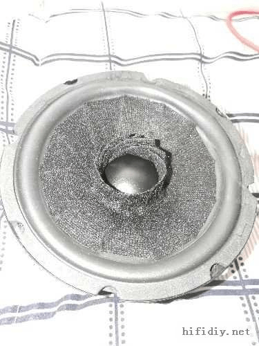

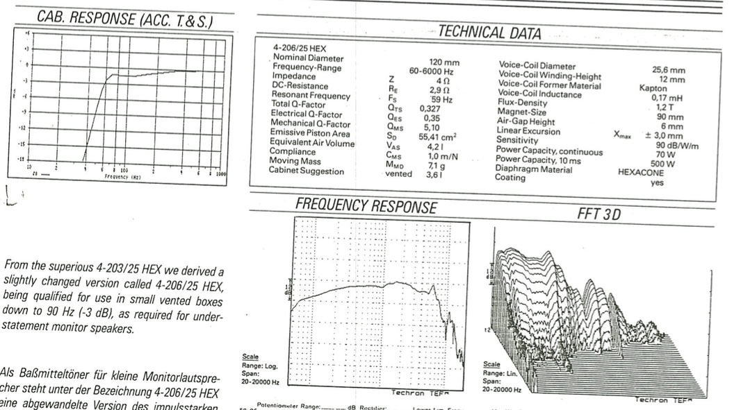

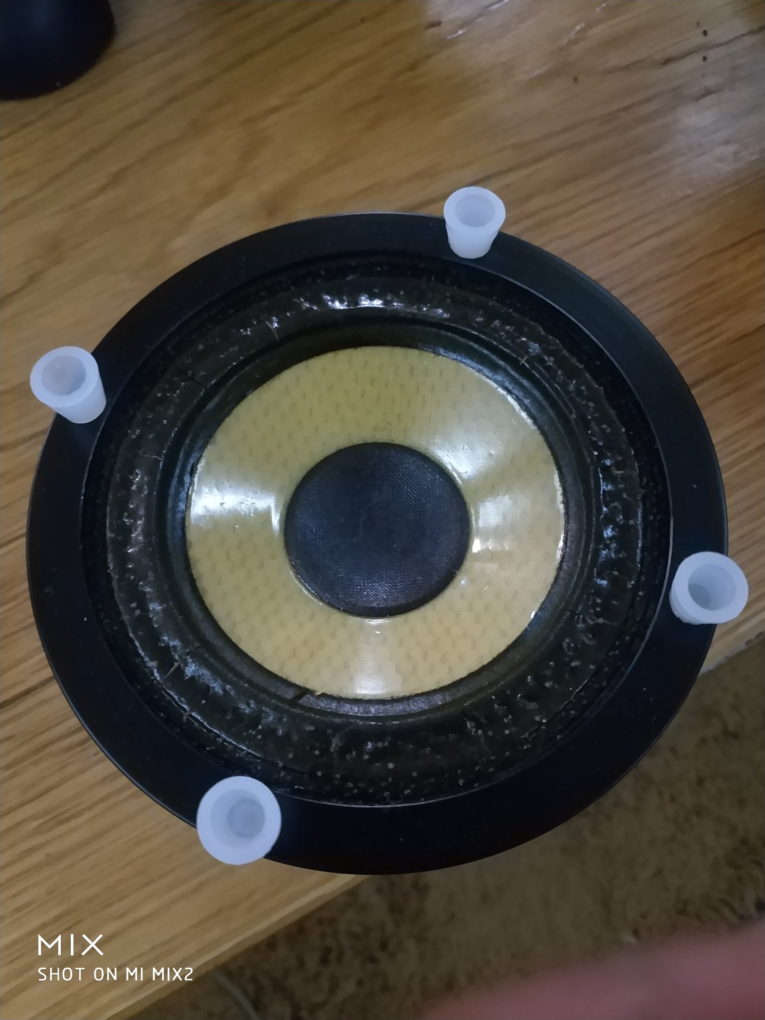

These ETON midwoofers are not produced anymore and are really hard to find.I happen to have a few pairs (new old stock)but they all need refoaming.I have managed to put new rubber membranes on a pair and try them on.
Here is a photo of one of the units as they came out of the box with the destroyed membranes .
Colour me not a huge fan of Eton units. Decent cones for the most part, but the motors are typically mediocre (or worse). Which doesn't mean I don't think some (many) other units aren't up to much either of course. 😉 Glad you're enjoying your speakers though -that's the point at the end of the day.

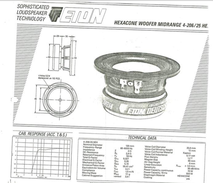

With these enclosures the bass production of FE 108 es is satisfying but with the ETONs the deep bass this enclosure produces is really amazing.
Hmm. Well, notionally Qt and Vas are similar, with the former a touch higher for the Eton (the Fostex having been designed primarily for use with high output impedance amplification or equivalent compensation) though nothing major, the main difference being the nominal midbass's Fs being rated at about 18Hz lower, which will extend the LF gain BW a little.

The honeycomb material in the fuzzy pic looked like Eve Audio / Mivoc / Jamo C-series / Eton MAS80 and not like the usual Eton Hexcone? I've done a few with Eve etc. fiberglass honeycomb but not Eton, and would sometimes wonder what I'm missing. I've also done the FE108eΣ several ways, neutralizing the sharp rise to 2khz and firming/supplementing bass of course.

Hello i have adde two pictures on the post but please dont judge the appearance of the cabinets yet due to not finished.
Also please dont judge the appearance of the Etons and the glue residues after membrane change.
