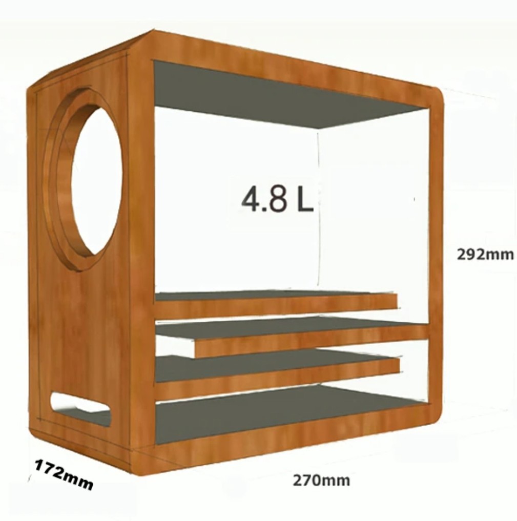

Out of curiosity, does anyone know what sort of design this cabinet is based on?
I came across it in the search for something that would fit. It's less than 5 liters so probably not suitable but I'm not sure what the idea behind the physics is here?
Cabs like this are sold ready-made (so very cheap) in China's Taobao stores, and generally referred to as "labyrinth". Bass is definitely enhanced (low and strong). I like to mod them by inserting slanted dividers to lengthen and taper the "transmission line". There are a couple of threads documenting my "TLonken" efforts.

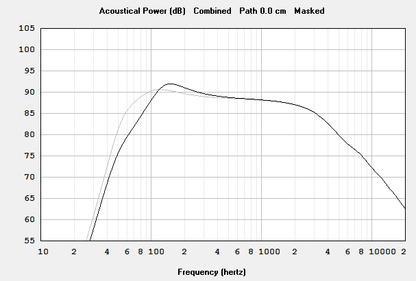

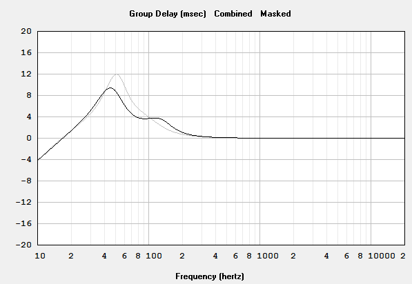

Hmm, T/S max flat using HR's slightly modded specs and assuming OEM specs are quite close:
Vented net volume (Vb) (L) = 20*5.48*0.59^3.3 = 19.2 L
Vented box tuning (Fb) (Hz) = 0.42*79.07*0.59^-0.96 = 55.1 Hz
F3 (Hz) = 79.07*0.28*0.59^-1.4 = 46.3 Hz, obviously only for very low power, nearfield apps, so presume of no use to you..........
Pioneer's classic BR = 5.48/1.44 = 3.8 L tuned to actual Fs makes for a mildly under-damped pronounced mid-bass, lower mids, i.e. typical classic party speaker, 5 W/1.0 mm, damp to 'taste'.........
Probably a decent compromise = the mean of the two = 8.54 L, 66 Hz Fb, wider BW classic variant, so extra LF = only 1.0 W/1.0 mm
All of course ideally need a hi-pass...........
Comparison of classic, averaged..........
Group delay ('ringing') comparison...........
