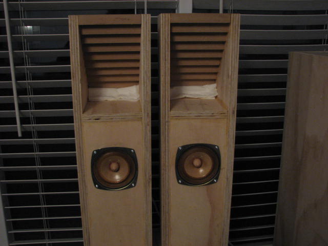

Actually Cal has the Coral's in the Jimmy's. The Foster 10F3's ended up here. I use them with the Shadow woofer. They are shown with the temporary aperiodic loading booger rags.

What do the rags do in the picture of the horn above?
That enclosure is actually a BVR, i'm sure Cal was playing with what happened when you aperiodically loaded the ports.
