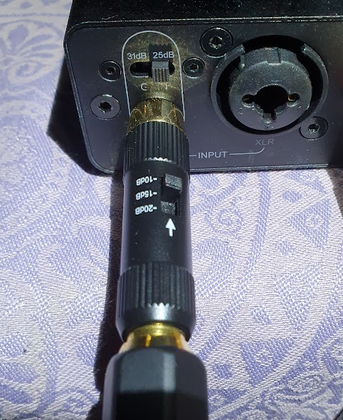

The same Monacor line attenuator as I used before.
To get -10 dB, I switched to four Vishay dale resistors ( two for each channel ) 10K in series and 2K in parallell ( to earth ), soldered the resistors inside the amplifier at the RCA:s and the sound became much clearer , better than using Monacor.

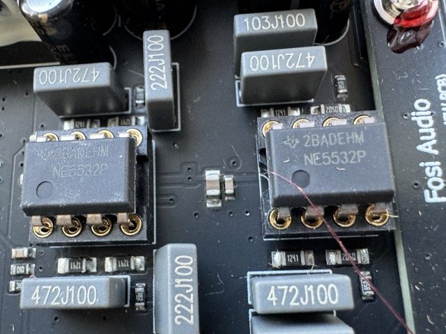

Doing this you both get better sound and dont have to mess with the op amps. I would personally switch opamp 2 and 3 to opa1612 or opa1642 , I think those are better sounding than ne5532 .
Audiophonics is a good seller.
Well, what you did is this - you removed two points of contact resistance by excluding:
1 one RCA plug<->socket contact (removed the "banana" gain-select adaptor)
2 removed another point of contact resistance (gain-amount select switch)
... no wonder the sound is better... not to mention the better-sounding resistors you used.
So, well done.

What are the signal levels of your sources and what is the input sensitivity of that Fosi? Does the Fosi work with correct volume when connected to a normal (younger than 20 years) source with built in volume control? If the answer is yes it is a fools decision to change the Fosi. You then need a preamp that has less or even no gain. A buffer, signor! Possibly you only want source selection and volume control. Choose a nice relay based version and possibly an output buffer and it is solved. You married 2 incompatible devices and now the marriage is over. Finito, there were no winners in this marriage. Let's hope there are no children.
A way better marriage is to switch over to XLR/balanced pre/buffer/source selection/volume.
I learned about gain and impedance after buying. 🙄
Most people would just reduce the source volumes (streamer+DAC, CD player), but that would be too easy. 😉
The recommended use of these amps is directly with a DAC with volume control. XLR in and out. For example Fosi ZD3 (came out later).

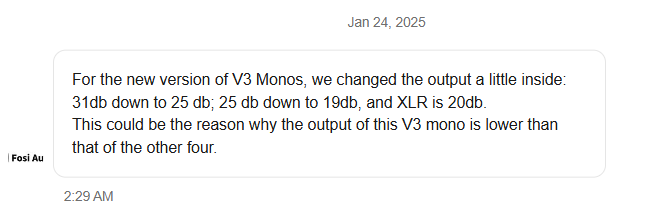

V3 mono:
input impedance RCA 25KΩ (XLR 5KΩ)
input sensitivity RCA 2V (XLR 4V)
