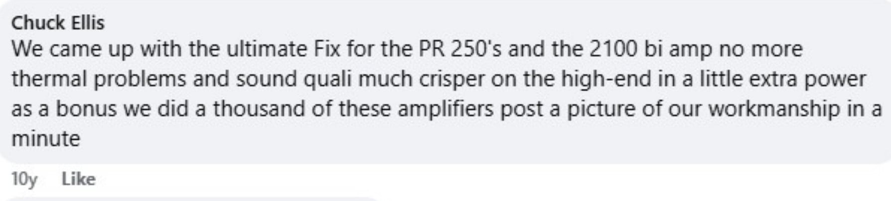

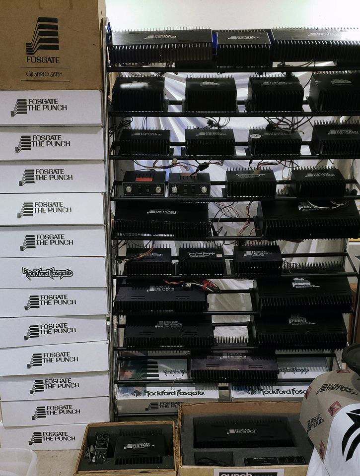

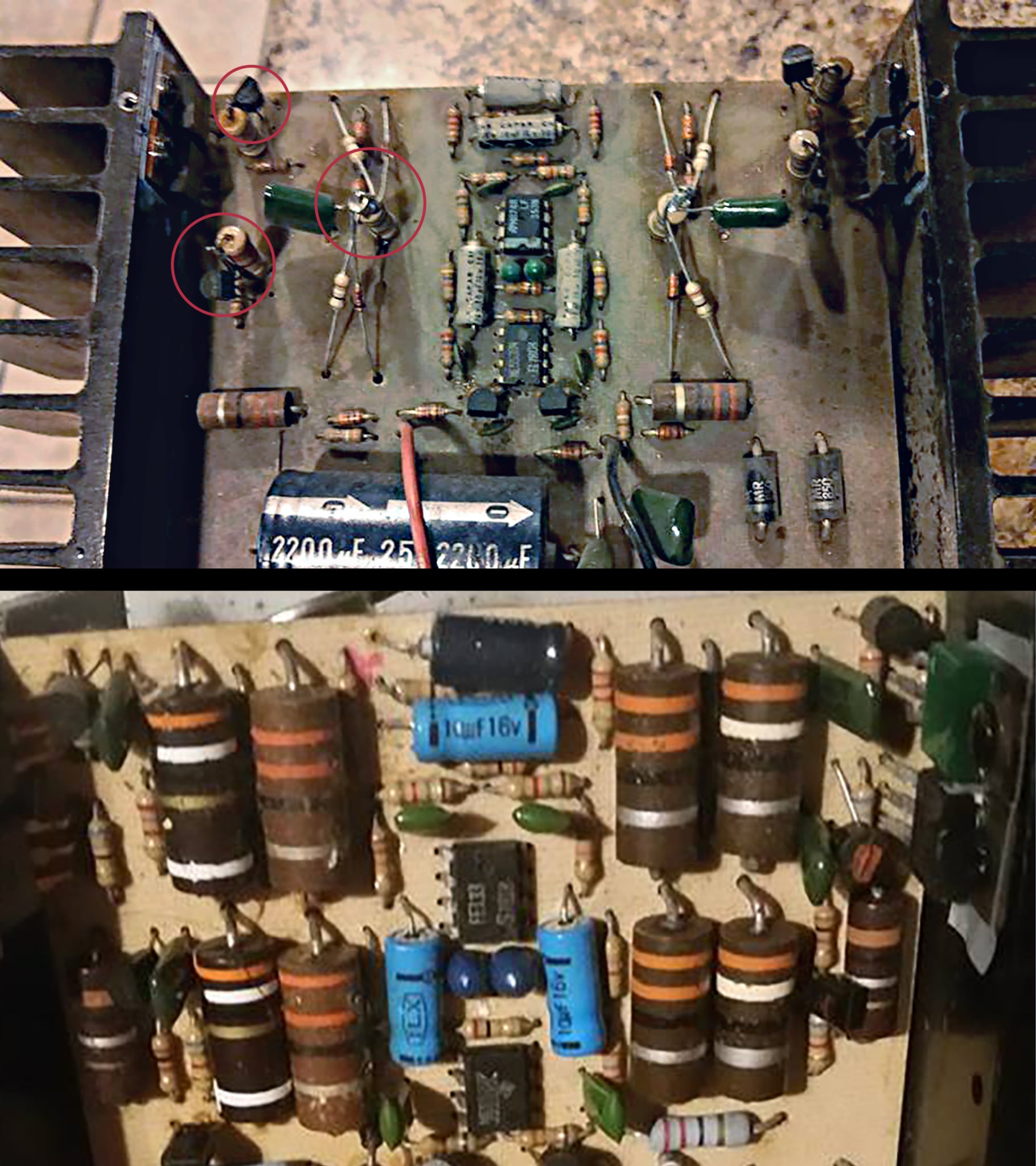

I have gotten my 2100 serviced also and working!!! sounds beautiful 🙂 wondering what you all know about this mod (see pic) hmm do you think this is the type II update they talk about? I grabbed this on a old thread and he says they have serviced 1000s so I got to believe it's is legit..

I do not know sorry. My example is the only one I have ever seen. I do know the one I have has an update(or possible from new) on the underside of the circuit board. A resistor and capacitor on each corner. Something to do with the amp coming on in cold weather? Perhaps Anatech will respond to this?

I was restoring the PR2100. Upgrades to this class B amplifier aren't the same as the later models. Most of what we saw were the PR250 model, some type II.
There were two really major issues with the type I. The case screws were tiny, self-tap types that allowed the chassis to flex, breaking all the power transistor leads. Drill and tap for 4-40 screws. I learned you had to replace all power transistors or you would have the odd one breaking later. Also the regulator transistors ran far too hot, so a larger case style with added heat sinks are needed. Servicing this one reminded me of this issue.
Some amps did have an issue turning on in very cold weather. I think the fix used to be replacing the value of resistor across the diode feeding the B+ out lead (turn-on) with a lower value one sorted that out. It also depended on the load (radio) you were using. I didn't do that simply because we only modified units that had reports of a problem.
Then there is the famous tantalum short / burn issue. This was the capacitor near the transformers. Install one rated at much higher voltage, or an electrolytic designed for switching supplies, or a new Poly-Aluminum (which is what I did). There are other tantalum capacitors that were also replaced. Upgrading the op amps is of little help. Maybe in the preamp, but it won't buy you much - if anything. The distortion of the main amplifier dominates, it isn't horrible. Then there is the distortion in the head unit (tape and FM) that easily exceeds the amp and preamp. Then of course ... the car speakers and environment.
Upgrading these amplifiers (or any amplifier) has to be done intelligently. You can't waste the client's money with the promise of better performance unless you can prove it. The average person is very susceptible to the suggestion that something is better, and they will hear it. Emperor's new clothes. What was done was the new outputs, invertor and driver transistors were matched so they shared current equally. Matching the invertor transistors greatly aids reliability. Since there are no emitter resistors, matching in the output stage can be very important as well. If it wasn't class B, the lack of emitter resistors would probably cause all of them to fail. None of these improvements show in pictures.
