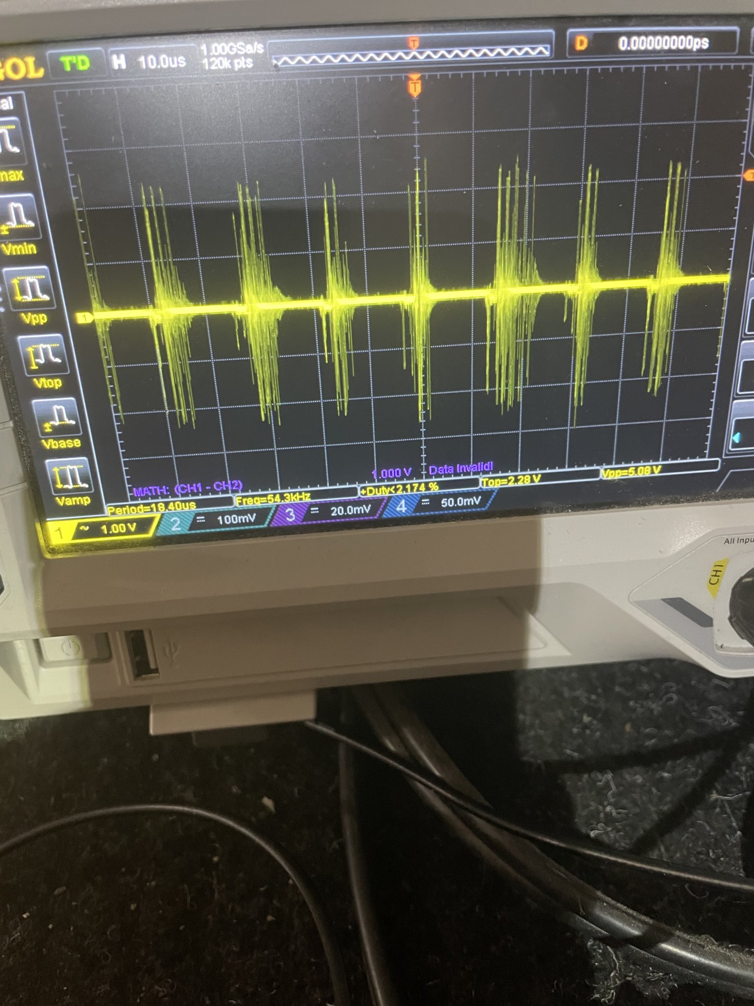

Used psu again at 14.4v. Noise is continuous outside of heating. So voltage had something to do with it maybe. Found noise on rail voltage, attached
Ok… so, found wonky 2-4 channel switch. Idle current would bounce all over when the post was wiggled around in place and the noise would warble when doing so as well. Removed and temporarily shorted the pads to select 2 channel mode. Ultimately noise still there may explain some stuff with noise changing on physically putting pressure on board and just the randomness of it.
Removed r52/53. Speaker noise gone. The noise on rail is still there. Rail noise is normal ?

Where was the scope ground connected?

Scope test signal ground connected to psu case. Probe ground to speaker (non bridged terminal) ground. Once it’s back in the heatsink I’ll try again

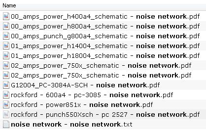

It seems yes, that resistor/cap network was responsible for the noise. This is a board 3085 600.4…. The 500x pc3084 has a place on the board for the resistor/cap but is missing. Maybe someone at Fosgate experimented for a short while.
Ground the scope to the ground terminal of the rail cap and probe the other terminal of the cap. Use the short probe ground clip.
There were about 3 or 4 diagrams that show the network but they show them as not used.
