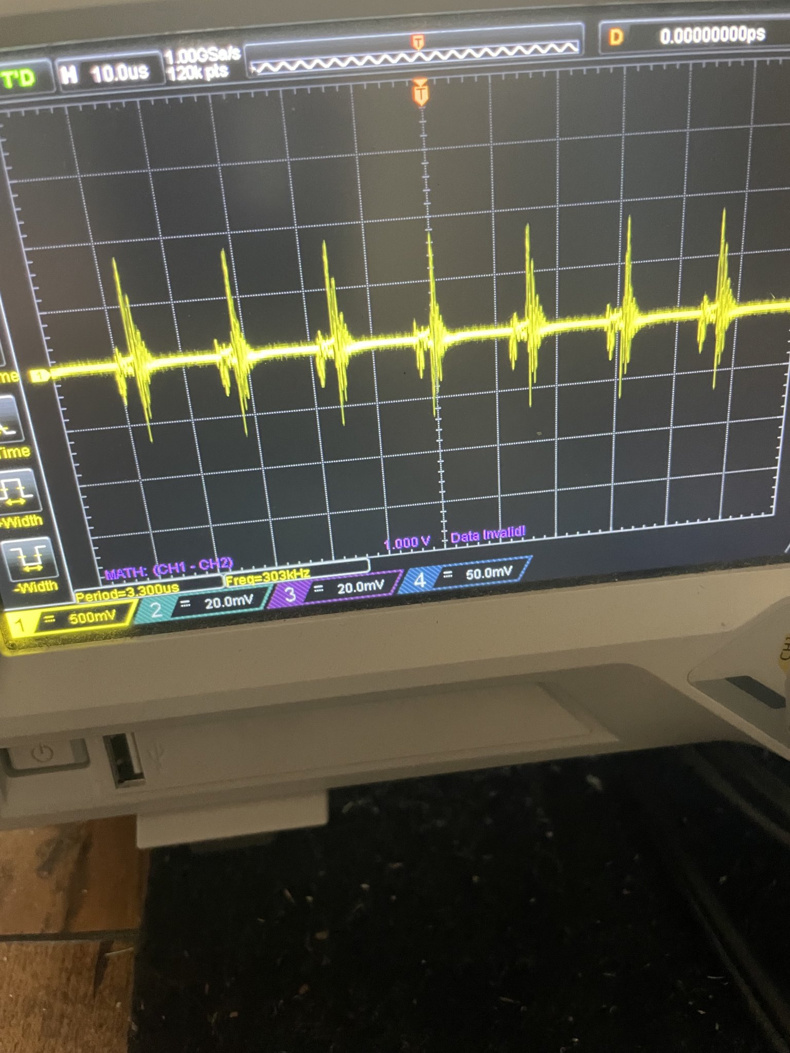

Ok, all ps fets replaced with irf3205. With just remote and ground, no battery positive, the gate signal is a really clean 32khz square wave approximately 43% on. With b+ it is the mess that is pictured. I’m not expecting it to look exactly the same but that looks noisy to me.

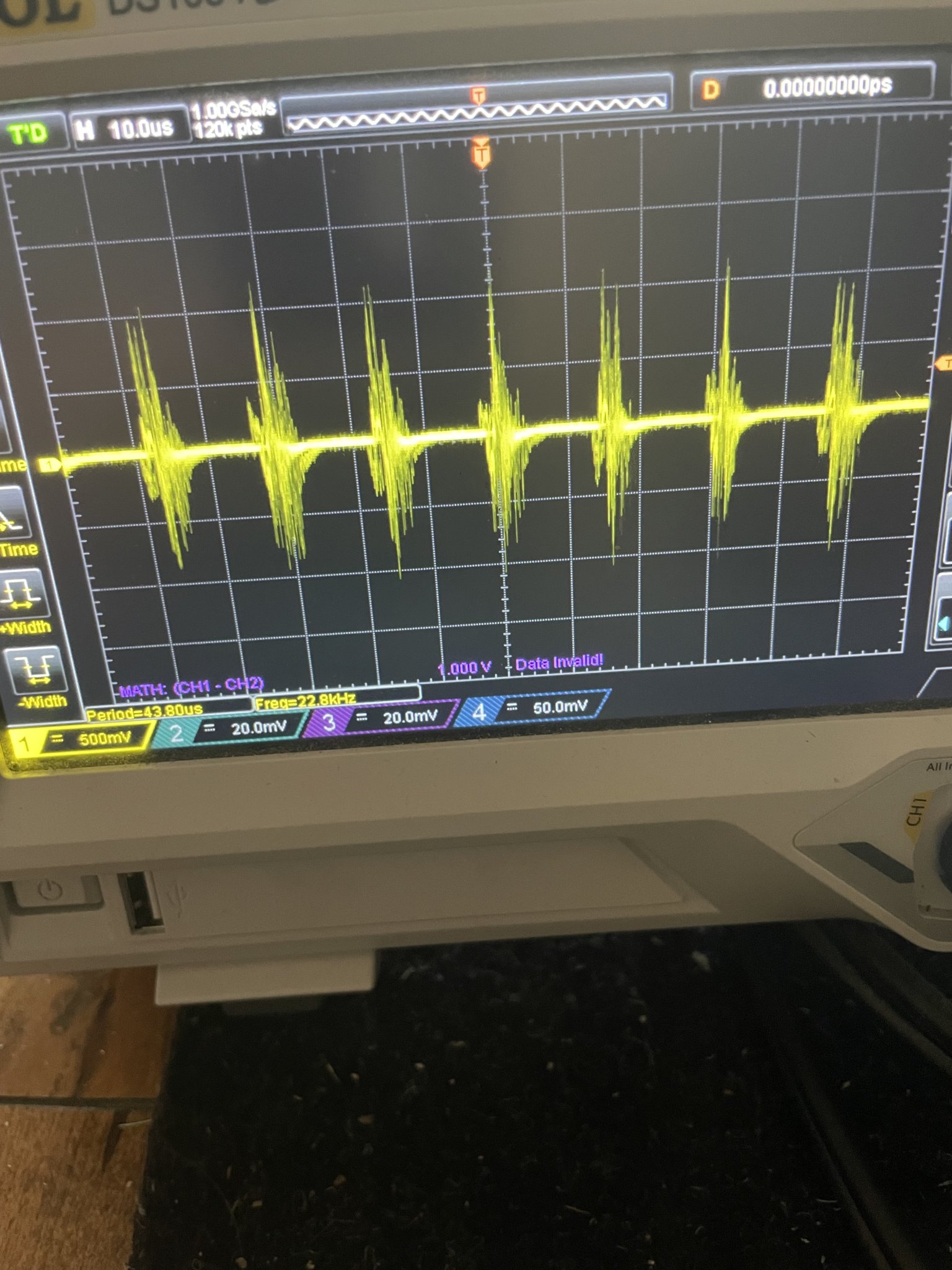

The amp works but the switching noise is bleeding to the outputs. Pic attached. If you decrease the period to zoom in you can see the 32khz psu switching riding the output.
I don’t think it’s the scope setup. The other 500x I was measuring had clean output. I went as far as powering the scope off a battery/inverter. It’s there load or no load on the output. If this is normal can any mods be done to improve it?

Was the scope grounded to the non-bridging speaker terminal when you checked the output signal?
The other amp rear channel noise was fixed by connecting the front/rear rca shields. Looks like it uses “I” and “j” grounds with the 100ohm resistance. This amp has the rca shields tied together internally without any resistance.
I tried it with the scope test signal ground lug tied to the psu running the amp. I removed this ground and then tried the probe ground on the channel being measured - just measuring single unbriged channel. I also improved the noise in my setup a lot by using a car deck on the same psu as the amp per one of your past tips (vs the portable AA battery cd player before).
I also tried a second probe feeding the math function to do a differential measurement. One probe on channel + one probe on channel ground. Also tried it on the bridged ground. All same result.
That noise is well out of the audio band. Do you think it's a problem? Some amps are a bit noisy.

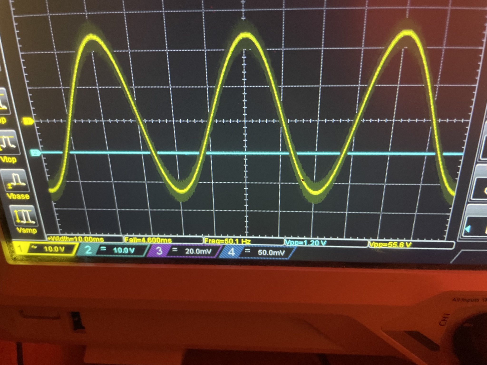

I may have had the bias too high. I turned the pots all ccw again left the amp on for a few min (after being off overnight) zero load, and reset each channel for 50ma idle current increase. Source resistor voltage barely measures anything. They were all 0.0-0.1-0.2mv…. Pretty much measurement error of 1 count on any dmm. Maybe I should go a bit higher?
The output looks much cleaner now.
I got it to start cutting out again to point where power light went off but it was really hot. Will have to get temp gun out again but if I’m following schematic right pin 2 on lm339 controls the over temp protection and it was at 0v

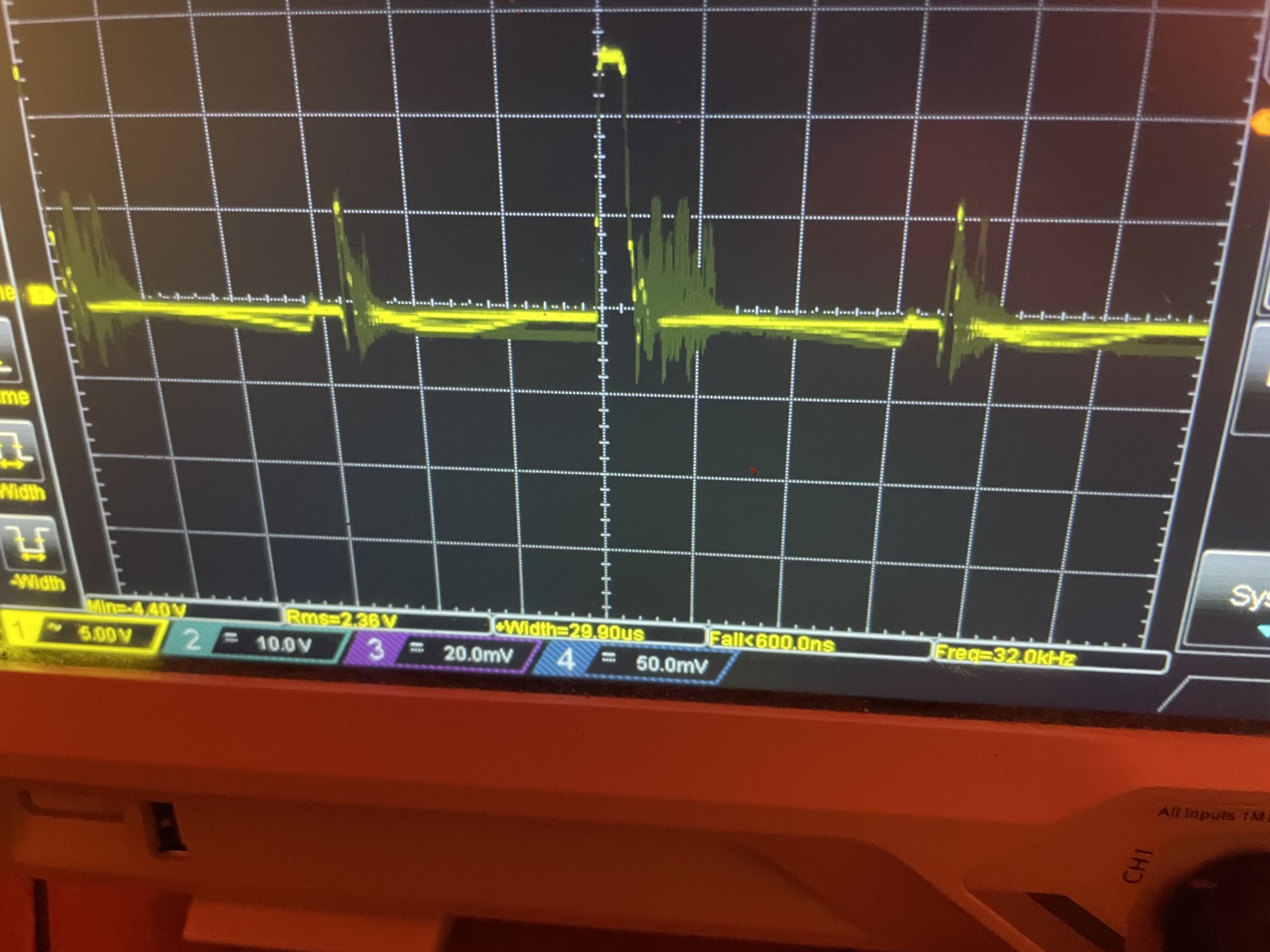

Man… this thing is killing me. Up until now I’ve been testing with dummy loads and occasionally a scrap 5” I’ve had laying around. Today I hooked it up to my living room mains.
There is static coming from all channels. If I turn up the bias on any ONE channel until it’s absurd like 20mv and idle jumps from 2.3a to 3.5a the noise goes away on ALL channels. It doesn’t matter which channel I turn up, all channels become quiet. I can also turn up each channel until I get 7-8mv at the source resistors… as long as the idle rises to 3.5a or more
I think I just never noticed it before because no tweeter was ever involved. Scoped each channel - they all look the same. First attachment is while staticky with normal bias. Second is the high bias clean sounding. This is with no input.
Of course I’m not expecting it to be flat as this is at 500mv/div but just illustrating the difference between the situations. It’s as if the psu has a minimum load. The trans whines a normal amount and manipulating the coils doesn’t make a difference but with the high bias/idle the trans also quiets down.
