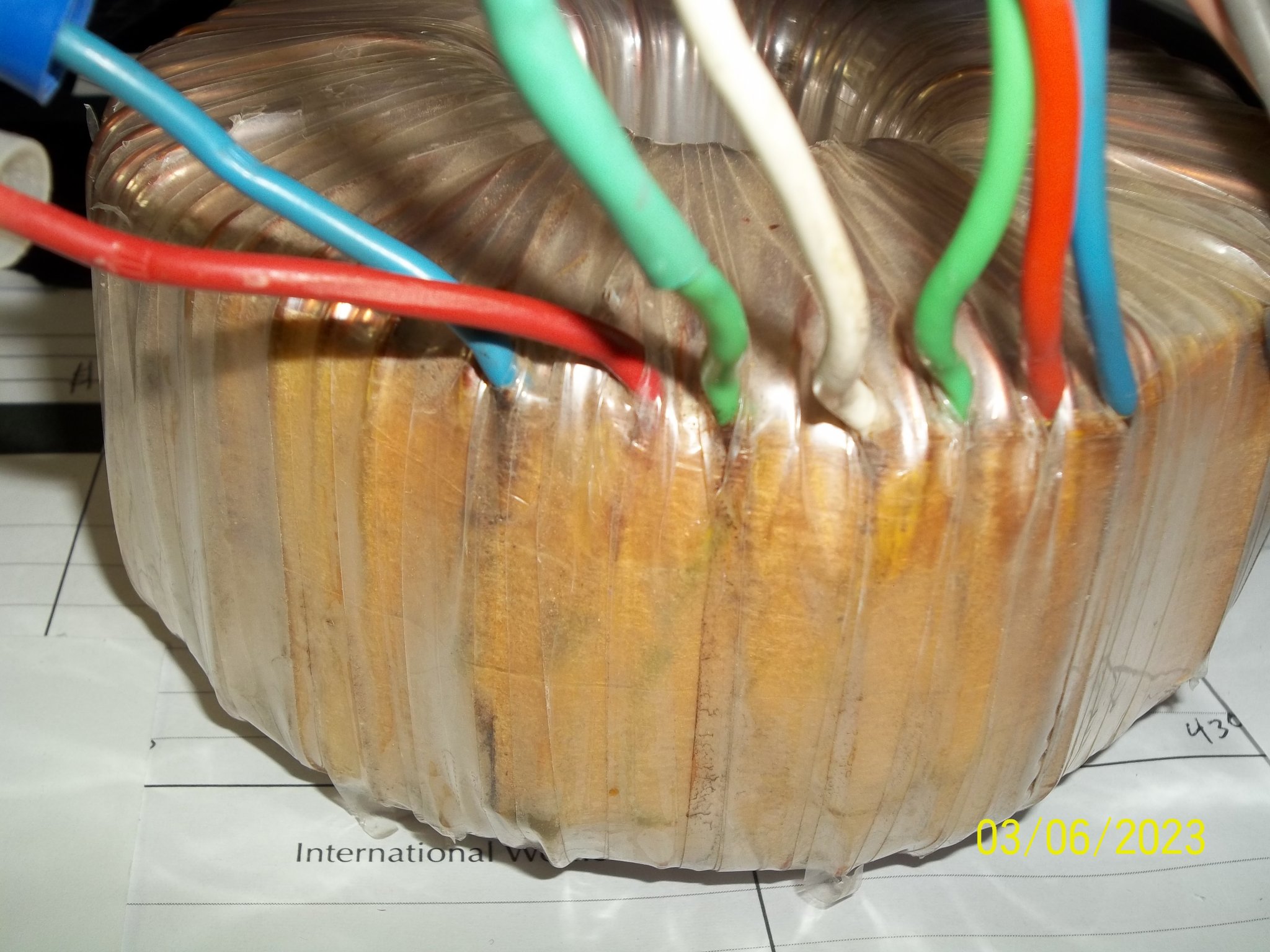

So looking closer , What your saying is to wire , short blue and purple on one side and gray and brown on the 0v side, Wire 115volt parallel and cap the white wire . For the Primary? I tried the parallel and my voltages were wrong? ( the white wire) if you read it from blue to brown or brown to blue?
Maybe the Transformer is defective? Before I think about replacement,
I'm going to try this configuration- So I short Gray and Brown cap white and use Blue and Purple as my 120volt main , The 2 secondary green wires are 29.5 volts going to the Bridge rectifiers with my secondary white going to ground , Right.. Thank You..

Please use a ohm meter to measure all 5 primary winding wires the resistance among each other and post the result.
Gray - Blue = ? Ω
Gray - Brown = ? Ω
Gray - Purple = ? Ω
Gray - White = ? Ω
Blue - Brown = ? Ω
Blue - Purple = ? Ω
Blue - White = ? Ω
Brown - Purple = ? Ω
Brown - White = ? Ω
White - Purple = ? Ω
Then we can determine which wire belongs to which winding.
Before you connect it to the mains, next step is to determine the polarities of each winding, that will avoid "bigbadaboom" as @Zen Mod mentioned on post #14.:whazzat:

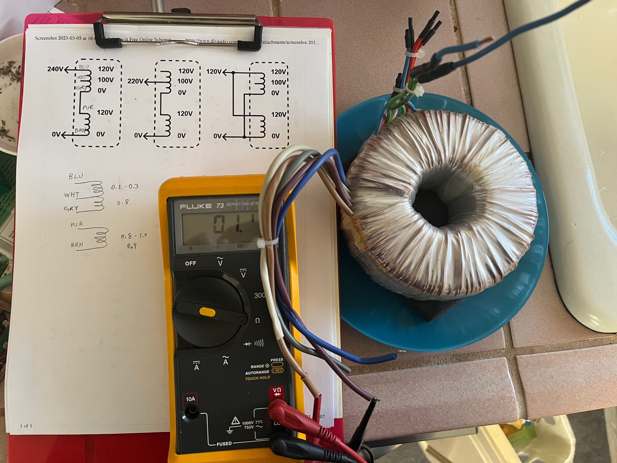

After using 2 different meters one of them being a fluke set on the 2 lowest settings, Primary
200 ohm/ 2k ohm
Gray-Blue 1.5 / 0
Gray-Brown 1.2 / 0
Gray-Purple 1.5 / 0
Gray-White 1.3 / 0
Blue-Brown 1.6 / 0
Blue-Purple 1.4 / 0
Blue-White .3 / .4
Brown-Purple 1.0 / 0
Brown-White 1.4 / 0
White-Purple 1.2 / 0

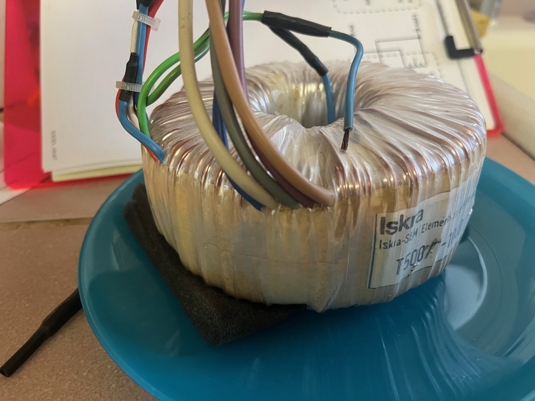

No the measurement are has accurate, I could get on the lowest resistance setting, They fluctuated a little I used 2 different multi meters
Primary // secondary

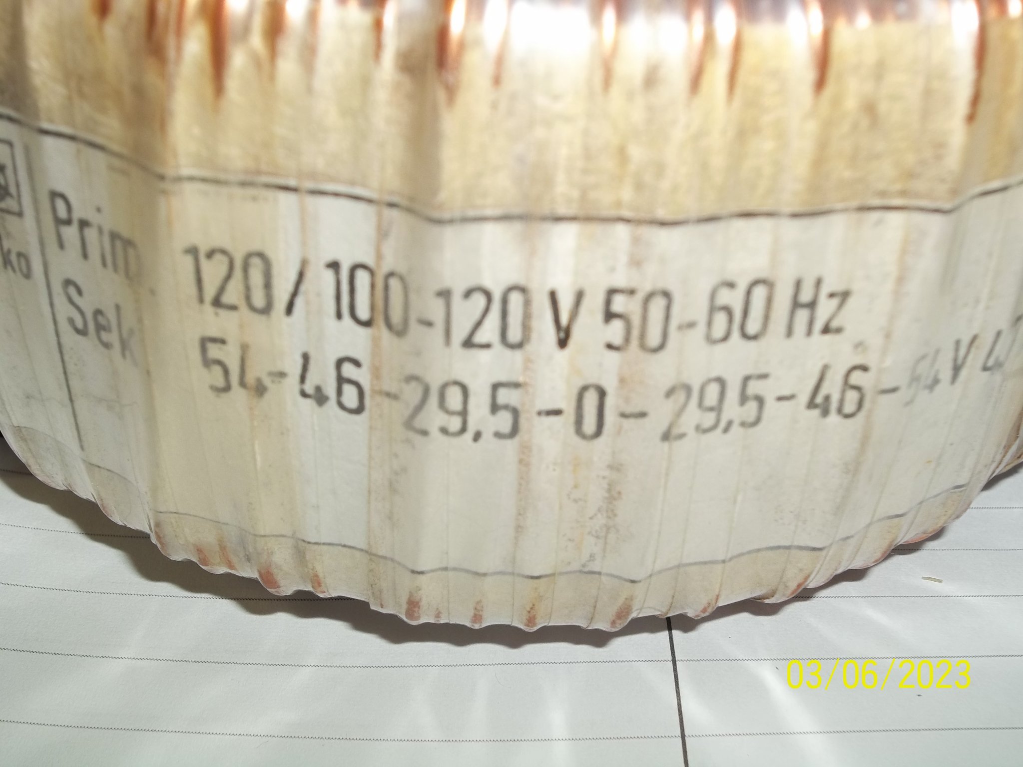

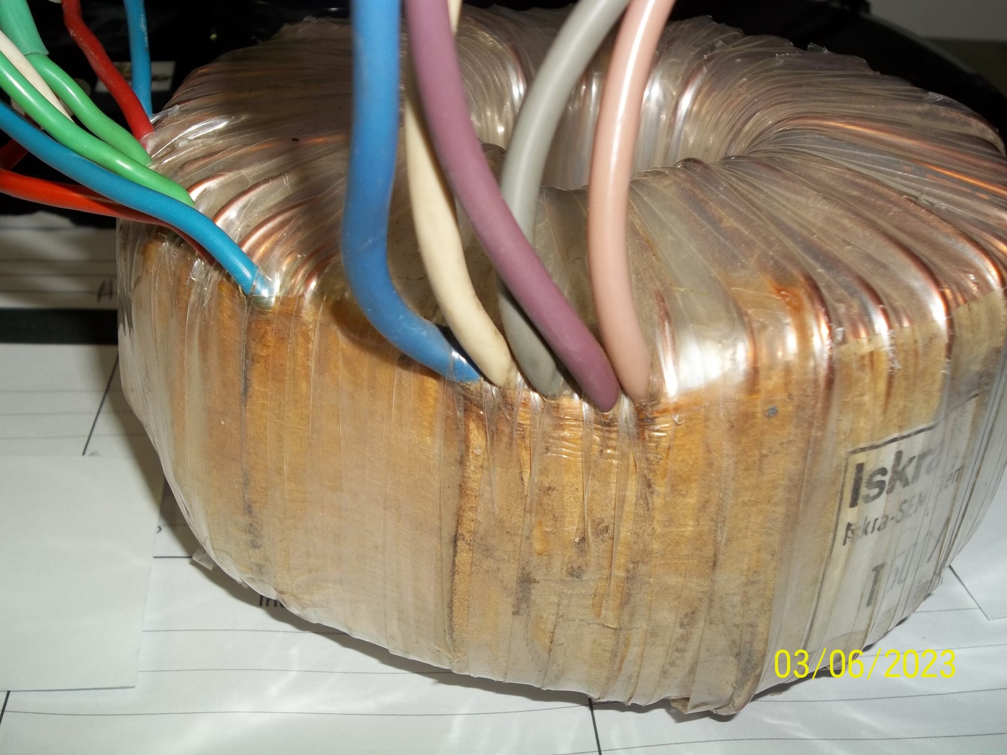

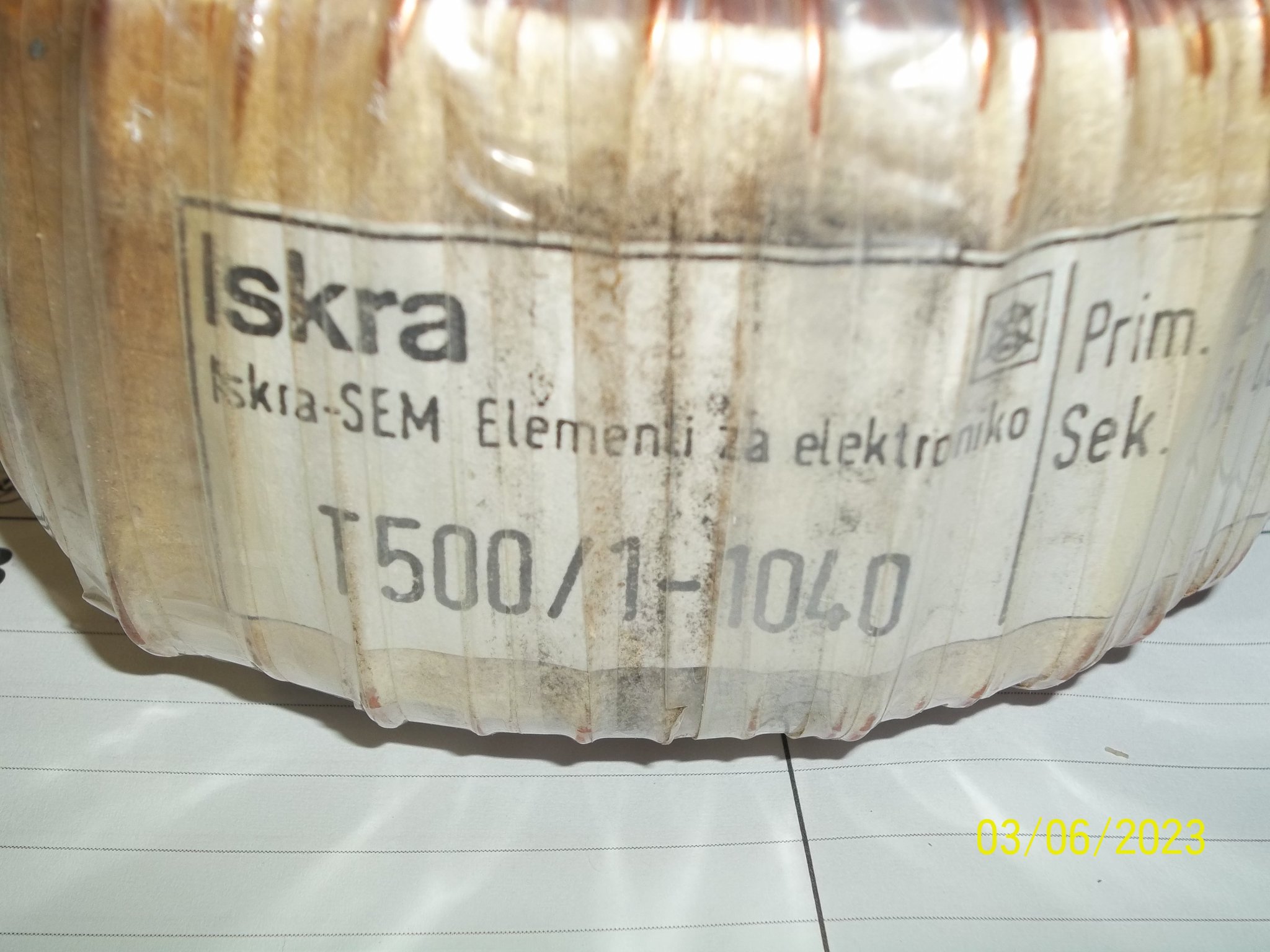

This must be where the chickens come home to roost? Since my transformer came from Nelson himself, I feel honored to offer it to some lucky member toward the most worthy cause.
It measures normally (see pic), although it has not been load tested...

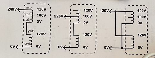

Oh, sorry, I did not look closely at the pictures in Post #34.
The wire colors are indeed marked in small print on the schematic, and there is the same drawing next to the meter.
Now the OP has to work out the landed cost of the transformer after checking his unit again, shipping may be costly compared to getting a unit in the USA.

Screenshot 2023-03-06 at 22-00-46 IMG_2748.jpeg (JPEG Image 2048 × 1536 pixels) — Scaled (31%).png
All the BAD measurement should displayed "O.L." on his meter. I believe OP's transformer has shorted primary windings.🙁
Gray-Blue 1.5 GOOD
Gray-Brown 1.2 BAD
Gray-Purple 1.5 BAD
Gray-White 1.3 GOOD
Blue-Brown 1.6 BAD
Blue-Purple 1.4 BAD
Blue-White .3 GOOD
Brown-Purple 1.0 SHOULD BE HIGHER (1.5-1.6)
Brown-White 1.4 BAD
White-Purple 1.2 BAD
