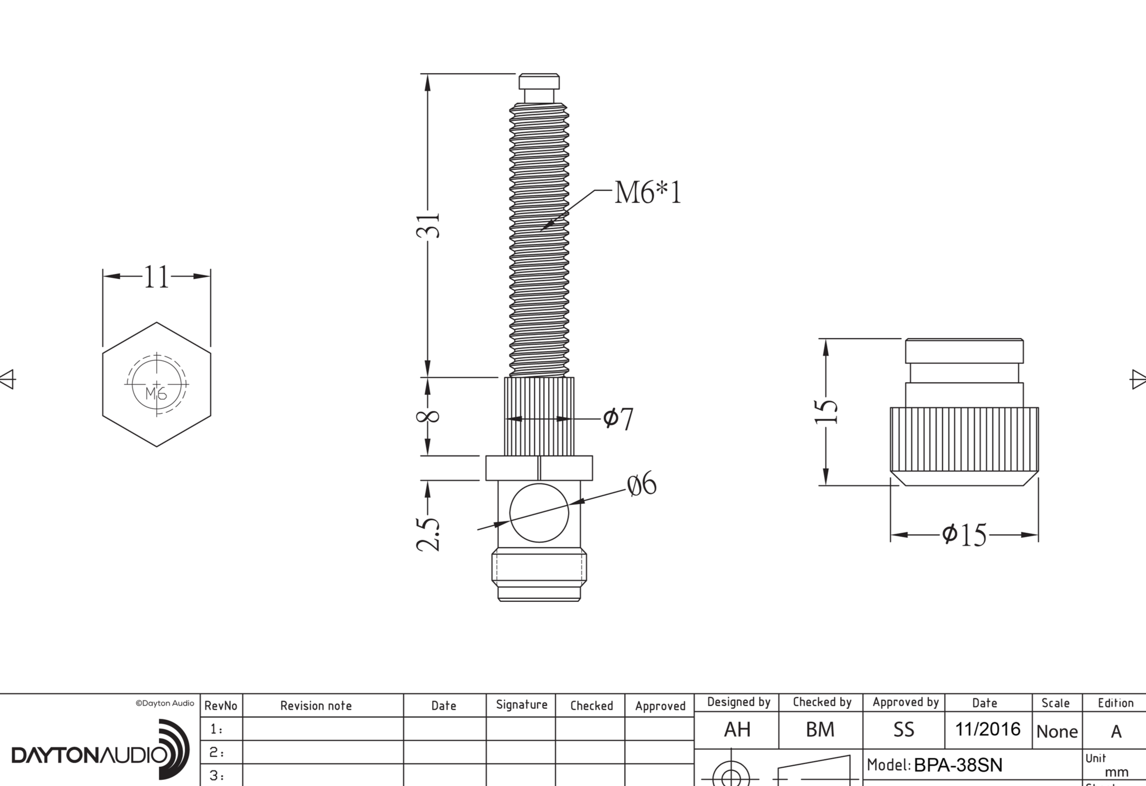

My cabinets will have these Dayton Audio binding posts which accept banana plugs or large fork terminals.
How do you know for sure what the diameter of the post is, as spades are typically either 1/4" or 5/16", when even the drawing omits it? I suppose assume 5/16" diameter as it would be pretty hard to drill a 6mm hole in a 1/4 inch post?
I use these fork terminals for 1/4" stud & #10 wire that crimp on. McMaster-Carr

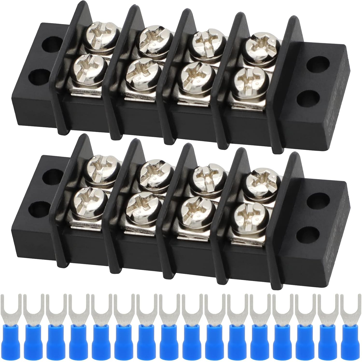

I use these:
The terminal block are available in 12-type as well. You can drill out the copper and split the block at that point. Rating of 30 A should be sufficient.
