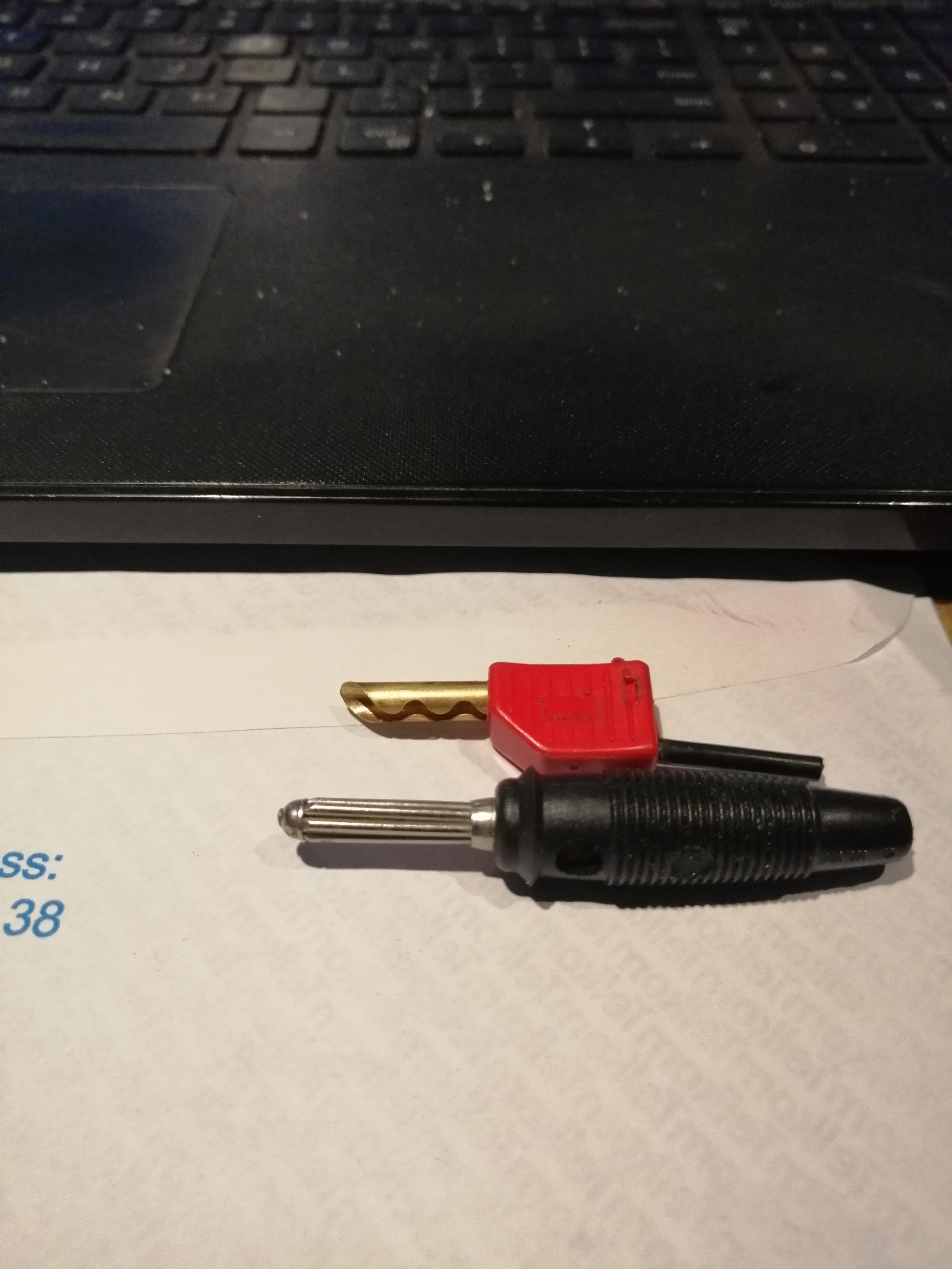

I've had BFA types bend or snap off if not careful with the plugs. I like them better than nine-tine/four-tine types for contact area.
For a more bullet-proof banana...

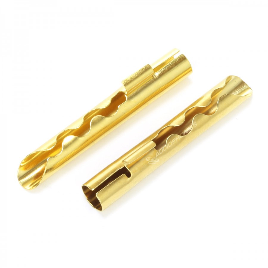

AECO makes these spiral-cut cylindrical bananas for 4mm jacks. Some like Cardas are a little bigger and the AECO won't fit tightly. Yes- they are a bit costly, but well made.
AECO:
