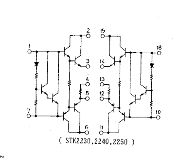

I assume i will be checking for the signal at the stk2240 packs? if so, could you help me make heads and tails of this diagram? no one has the pinout for them, and the data sheet doesnt list it...
also what voltage should i be looking for at the pack? datasheet says recommended operation of +-33.5v
I wouldn't check on the IC. One slip of a probe could destroy it.
Connect an input signal and a speaker.
For half of the IC,
Pin 1: input drive
Pin 2: positive rail voltage
Pin 3: output, likely directly connected to pin 4
Pin 4: pin 4/5 possibly used as part of the protection circuit
Pin 5:
Pin 6: negative rail voltage
Pin 7: input drive

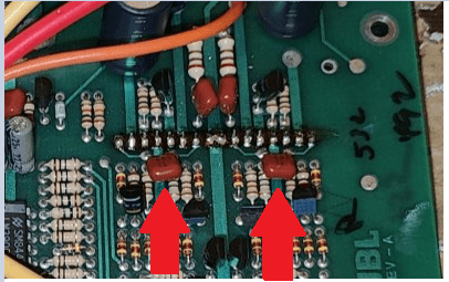

So, got audio hooked up to it. I only checked one of the two packs as theres a bunch of wires covering the other pack's solder points. I can check it if necessary, but seeing as neither work, I will stick to just this one.If applying audio is easier, do that.
Voltage at the pack is +-25.8v. I checked for the audio into the packs at the capacitors pointed at in the pic as they are connected to the supposed input pins. All thats there is 2.41v DC on one set of inputs, and -2.41v DC on the other. Turning off the audio source made no difference.
Seeing as theres no audio present at the packs, I take it the issue is further upstream? Do I need to start checking the outputs of each of the op amps?

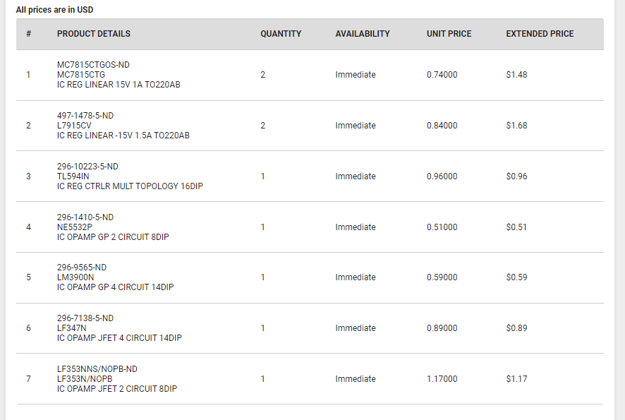

Any other parts you think I should order just in case from digikey?
The rest of the various op-amps and other DIP ICs on the board are so inexpensive, you may as well order at least one of each. It would be cheaper than shipping if you had to place a second order.

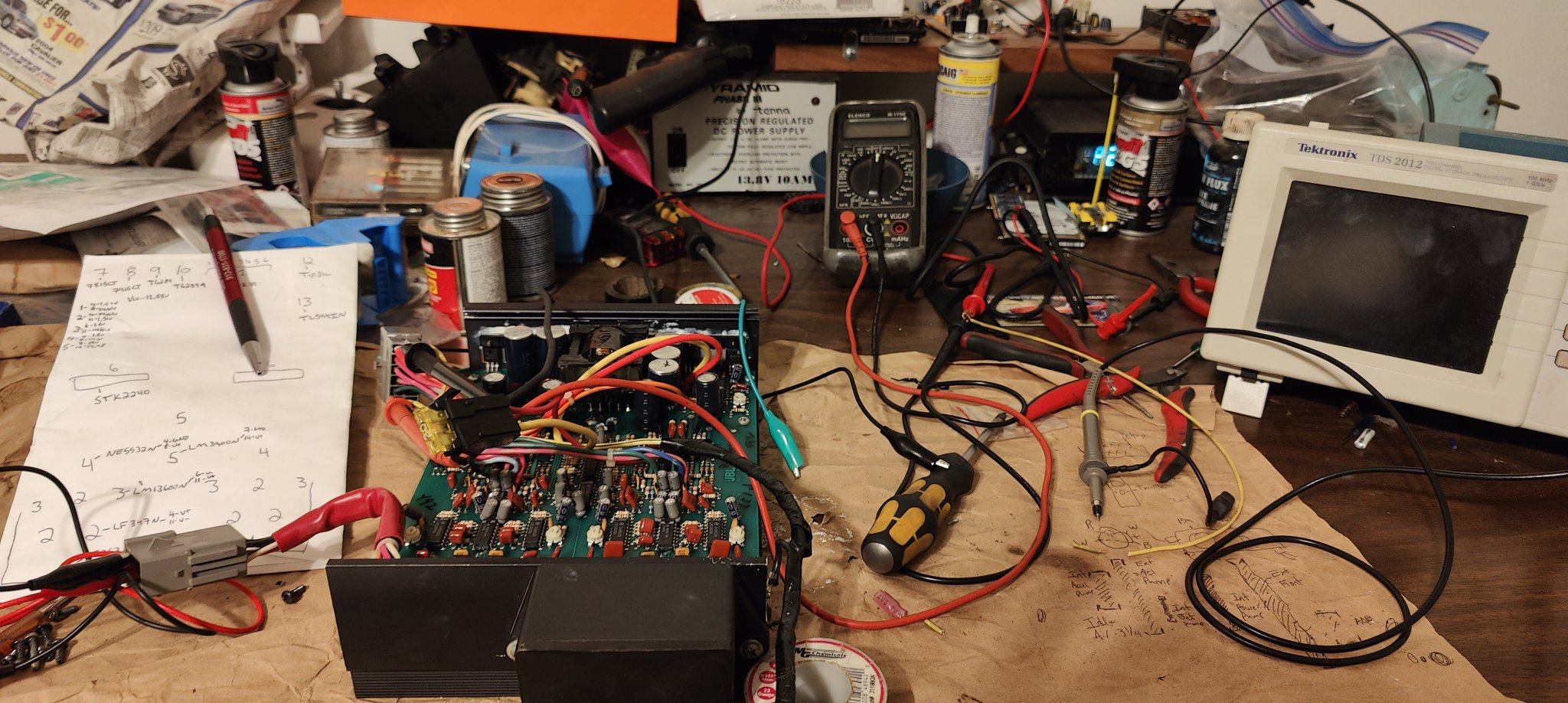

This is my trash-tastic bench setup. Basic 13.8v supply, multimeter being used as an amp gauge, second multimeter for voltage check, oscope and a spare phone to feed audio into it. You really need a scope to fully diagnose an audio amp.
Yes, I'm only checking the top of the board. While it is multilayer, there's not really much on the underside.

Got most of the parts. digikey doesnt have the buz71 nor do they have a thru hole lm13600. meh, should be okay.
