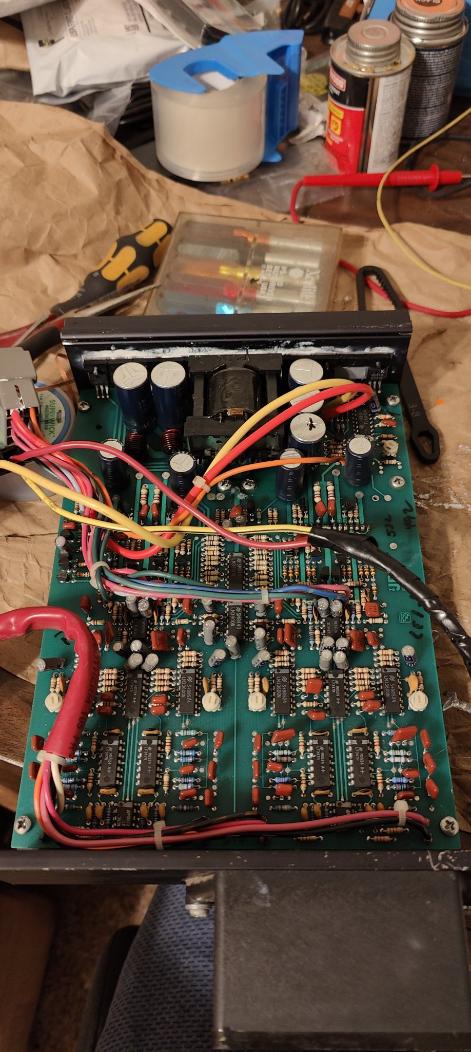

So, got audio hooked up to it. I only checked one of the two packs as theres a bunch of wires covering the other pack's solder points. I can check it if necessary, but seeing as neither work, I will stick to just this one.
Voltage at the pack is +-25.8v. I checked for the audio into the packs at the capacitors pointed at in the pic as they are connected to the supposed input pins. All thats there is 2.41v DC on one set of inputs, and -2.41v DC on the other. Turning off the audio source made no difference.
Seeing as theres no audio present at the packs, I take it the issue is further upstream? Do I need to start checking the outputs of each of the op amps?

as for them heating up, i havent explicitly checked, though I'd imagine it wouldnt heat up much with the entirety of the amp drawing less than 1 amp. ive got a cheapo laser thermometer i can check with.
You would be able to feel the heating.
Just a fraction of a watt of dissipation can make something like an op-amp too hot to touch. It doesn't take much.
