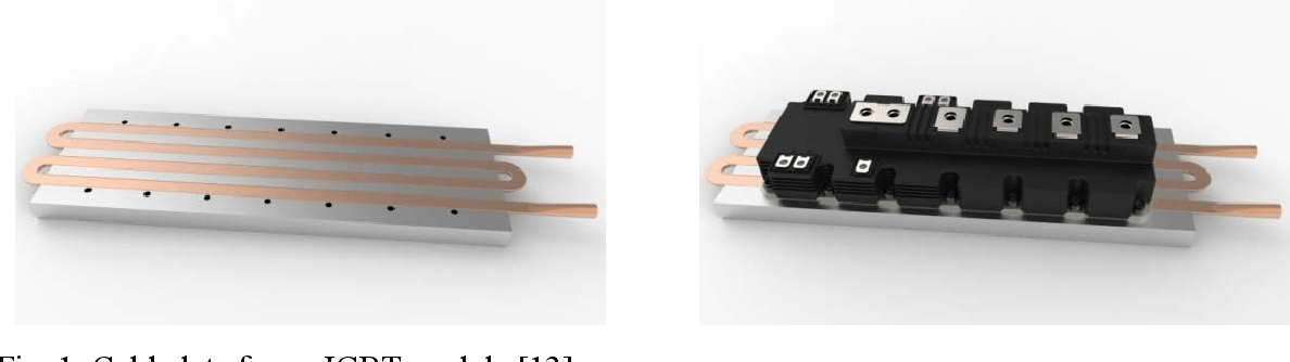

But most effective and compact (locally) is still liquid cooling, of which water is just one example.

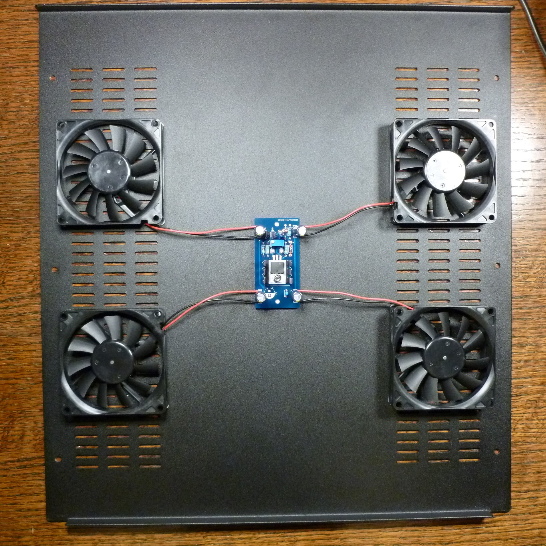

There is a fan speed regulator project that didn’t get deserved attention with A class amplifier builders:
Fan inside audio chassis
I’ve made PCB for two series connected 12V fans. They are many more types available than for 24V. First try was with four 80 x 80 x 15 mm very silent low speed fans, attached to the amplifier cover. Regulator works very well (as expected).
However, this is not good place for a fan placement. While testing fan operation with cover on the bench, it was absolutely silent. Putting cover in place, reveals that slightest fan vibration is amplified by cover resonance and with amplifier internal volume it produces some droning sound. In dead silent room at cold start, it is barely audible at 1 m distance. After an hour of operation at temperature equilibrium, noise can be heard at more than 2 m distance. Unacceptable.
Temperature inside case drops twice the drop on external heatsinks and overall cooling effect is very good. Next try will be with big fans inside case.

Hi Tombo,
This experiment has worked amazingly well. I played around with fan speed a bit for max cooling without hearing the fan from about 4 feet. My HS temps with conventional fanless cooling were 50 to 52°C. Now they are 37°C, barely above a class AB amplifier! The M2 clone really doesn’t need this fan set up, but for the future with a higher biased class A amplifier in the same size chassis, I believe this will be the solution for me.

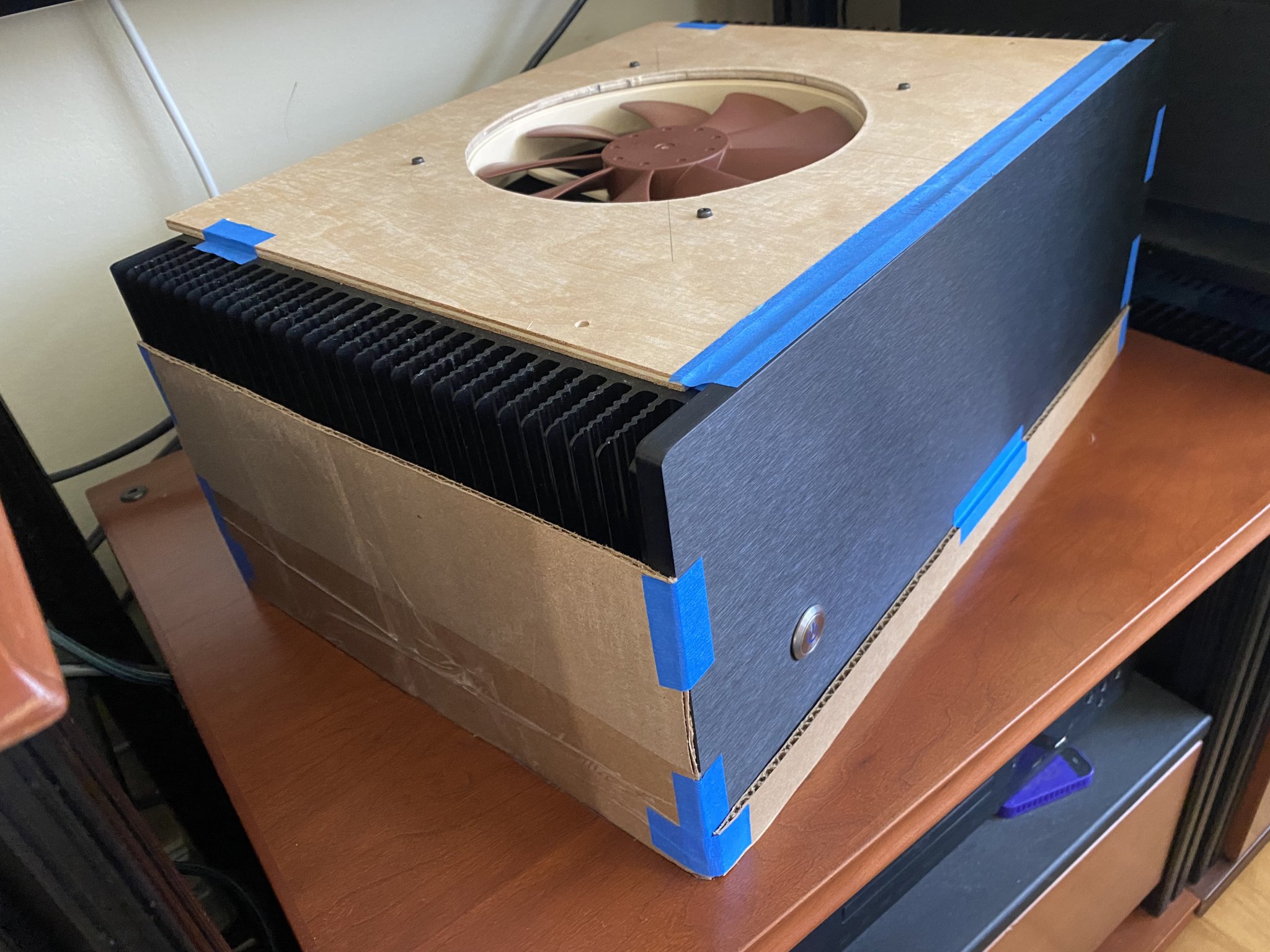

Nice DIY! A tunnel makes sure all the air surpasses the heatsink but I don´t understand the position of your fan.This experiment has worked amazingly well.
You are sucking in cold air from the top into the chassis?
Why not blowing in from the bottom?
Both solutions will not work 100% though, as the air is not directed too well and the stream of cold air will create chaotic turbulences within the chassis.
(Remember the old PC big towers where the CPU-fan would simply blow the hot air in all directions?)
I think something like this
"baby sitter" would work well if fans sit at the edges under the heatsink (and at least partially "overlap").
Simply blowing/accelerating the cold air stream straight up past the fins.
Assuming the bottom and top plate have slits you will also get forced cold air into/through the chassis.

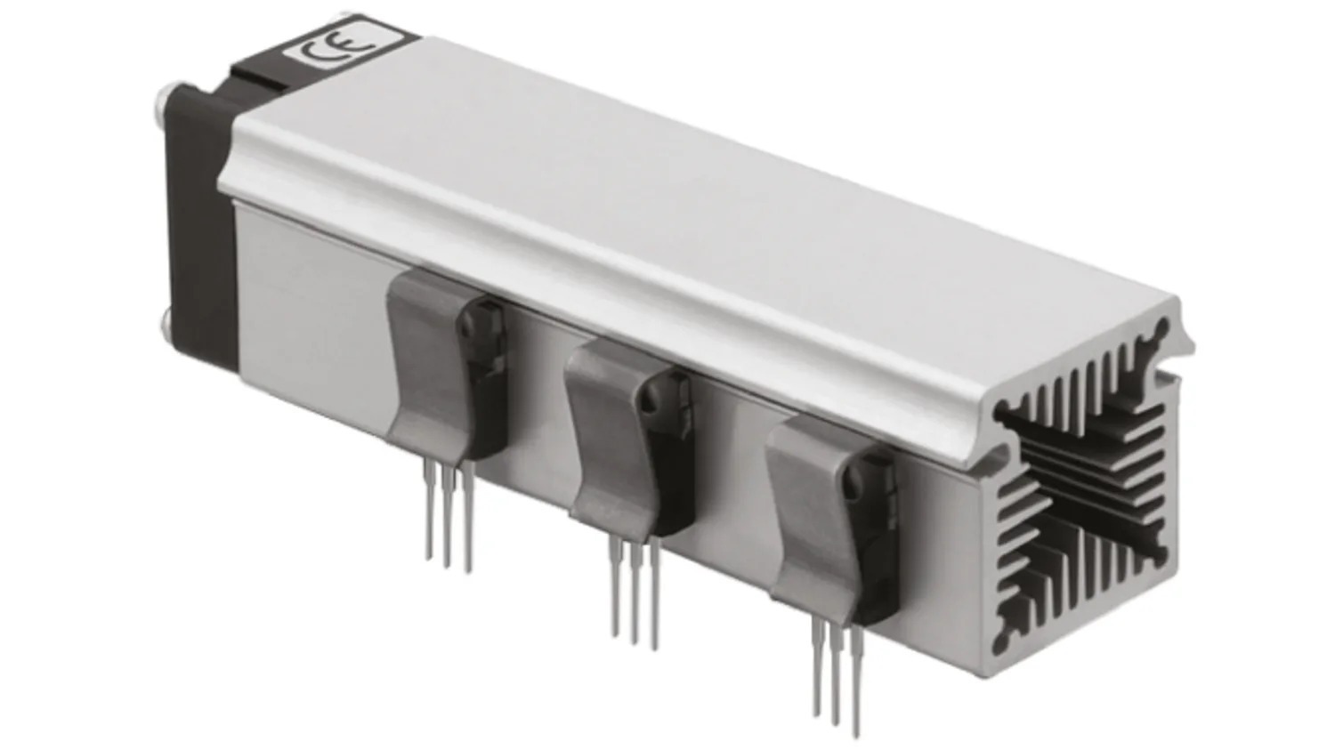

Tunnel solutions from Fischer Elektronik and the likes are nice but also quite expensive.
Fischer

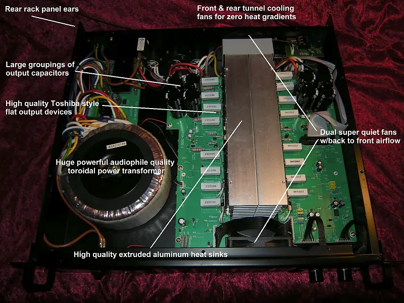

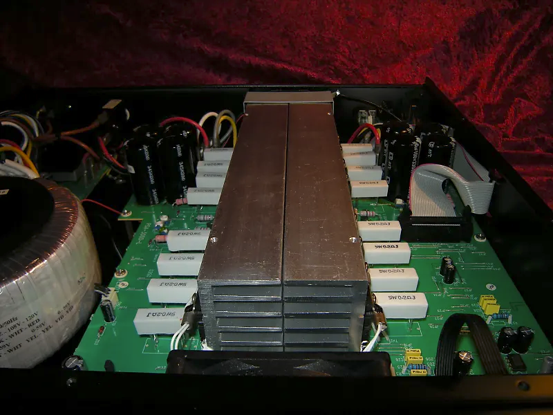

I believe any amp will benefit from just a simple fan. My choice is a twin fan unit, quiet works well. Heat build up over time will shorten the life of components.Can you cool a Class A amp to the point that sound quality is affected?

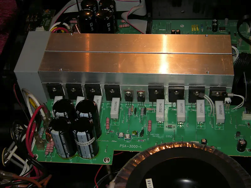

Continuous Power per channel both channels driven 20 Hz to 20 kHz 2 ohms: 800 WattsThis is the professional approach to forced air cooling....
_________________________________________________________________________
Peavy:
"A classic problem when using forced air to cool a multiplicity of devices arrayed along a heat tunnel is to equalize the device temperatures along the length of the heat tunnel. In high-power amplifiers you routinely use several power devices in parallel. If one receives less cooling than the others, it will run hotter. Like the weak link in a chain, it will reach its maximum temperature and fail first.
Even if all of the power devices have the exact same access to the cooling air- flow, the air picks up heat as it passes over preceding devices. This hotter air can't absorb heat as readily as the cool air. The classic solution for equalizing the thermal gradient in a heat tunnel is to tune the length of the heat sink fingers. Just look inside the industry standard CS800X, The heat sink at the hot, exit end of the heat tunnel has much more aluminium and longer fingers than the cool inlet end.
Multi-stage, graduated-heat tunnels are complex and difficult to manufacture. Our new heat sink approach is deceptively simple. By angling two heat sink extrusions toward each other, forming a truncated "V", the heat transfer is significantly increased at the narrow end.
The cool ambient air enters at the wide end, top of the "V." As the cool air moves through the heat tunnel gaining heat, the walls move closer together increasing air flow and velocity across the fins and helping the hotter air extract the same amount of heat the cooler air did in the previous section. By the time the hottest air gets to the end of the tunnel, the heat transfer is at it's maximum. The net result of tuning the heat sink for air temperature, the devices all operate at close to the same temperature and the amplifier will be able to do more work before the hottest power device gets too hot."

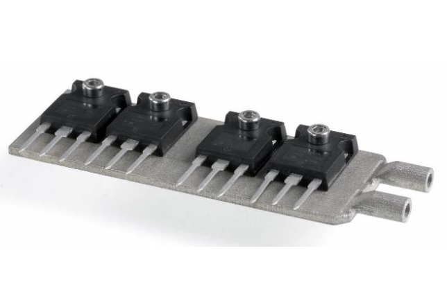

For A-class lovers struggling with hot days, the water cooling option offers a way to move the heat right out of the room.
The classic DIY option is to run a low flow hose from a garden tap, in via a window and out to top up the pool. No noise. No dust. Incredible heat transfer.
Of course sooner or later there will be a leak in the amp. Unless the water jacket is designed for harmless leaks eg mounted under the amp there will be more water leaking via tears
The sensible thing is to fun a more efficient system in the heat and fire up the Class-A convection air room heater when its chilly. But if we were sensible we would just but some good headphones and relax.
