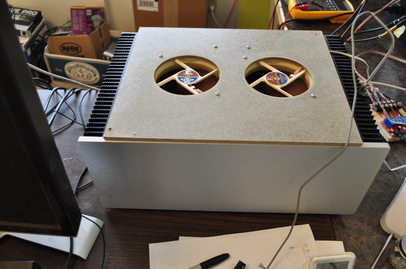

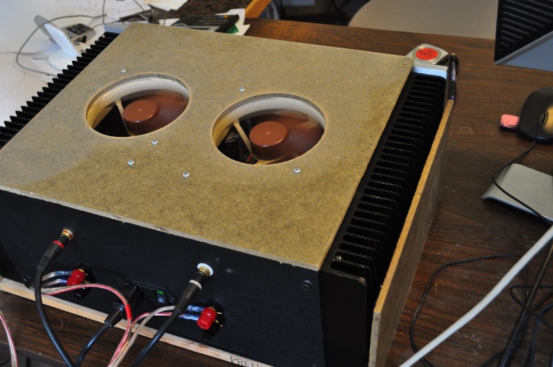

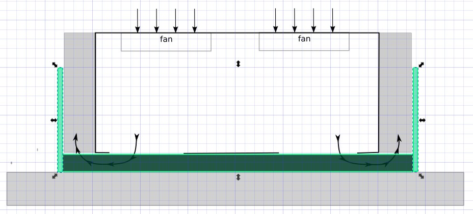

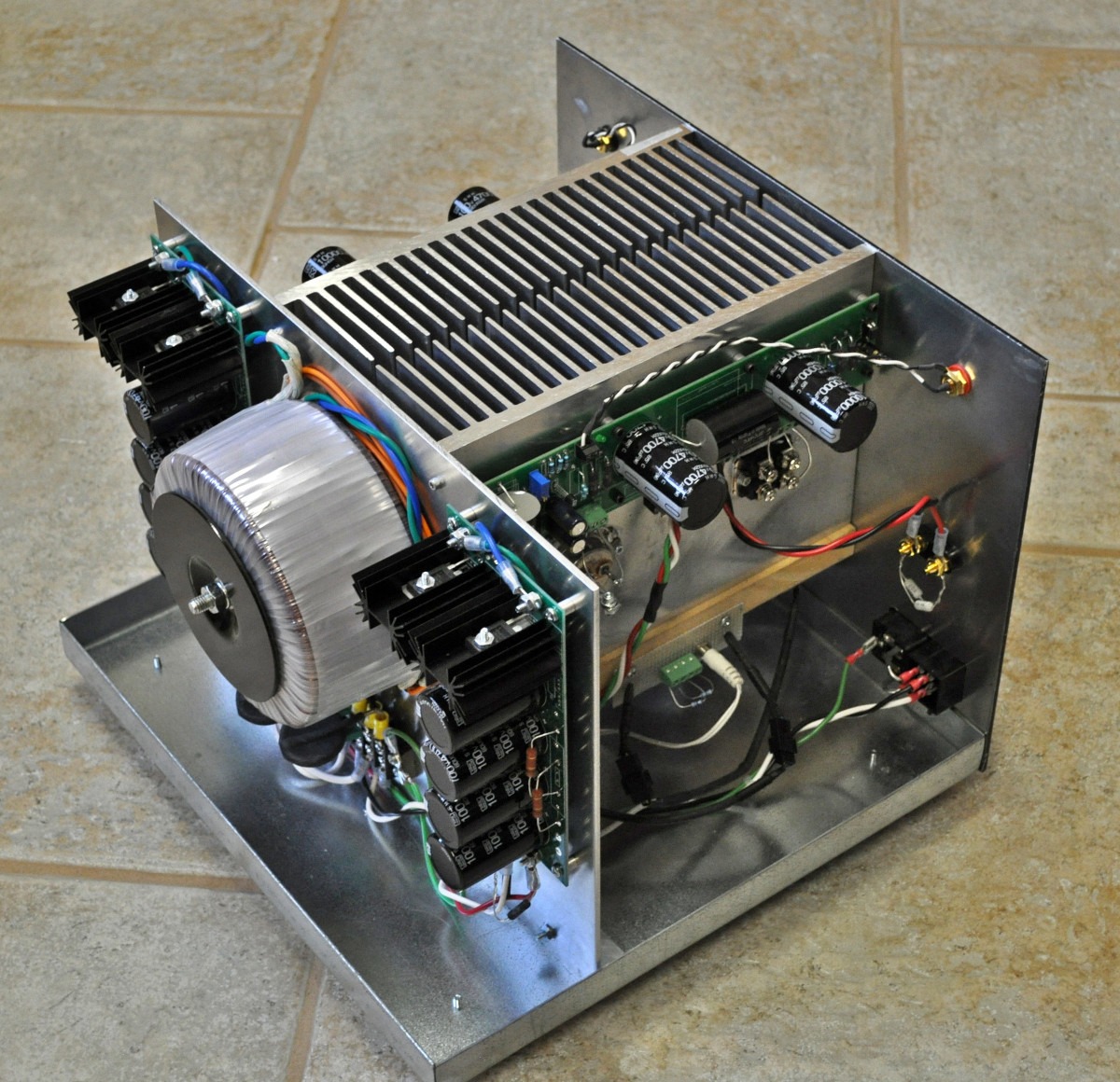

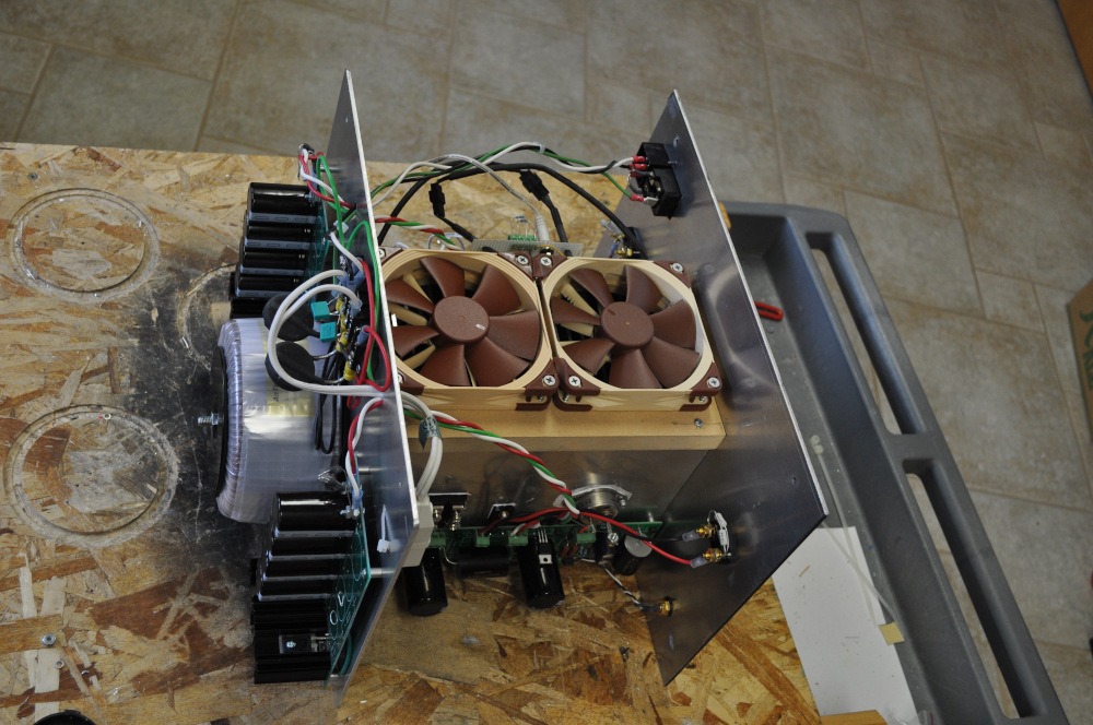

That's an interesting find. I perked up at the uniform device cooling issue and was surprised to see ducted geometries being discussed. I am currently working on a duct system for the long narrow Pass amp boards that are meant for 2U chassis dimensions. At the moment I'm tweaking things to fit two fans per duct in hopes of facilitating the high power F5 versions aside from several other changes. The main concept being each device gets it's own fresh and evenly displaced airflow.
