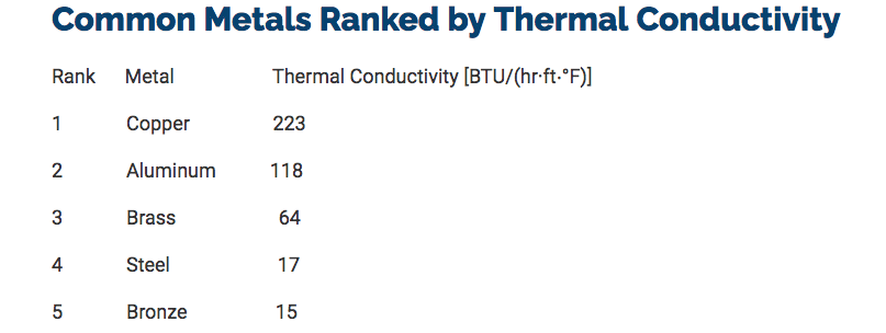

Silver transfers heat just a bit better than copper (what most voice coils are made of) but copper is about 13 times better transferring heat than steel (what the conductive part of magnet structures are made from).Fane measured turbulent air around voice coil transferring heat to magnet structure had heat transmission "comparable to solid silver"
The trick to keeping a voice coil cool is transferring heat directly to the outside air, rather than heating the steel (and ferrite ceramic) magnet structure.
