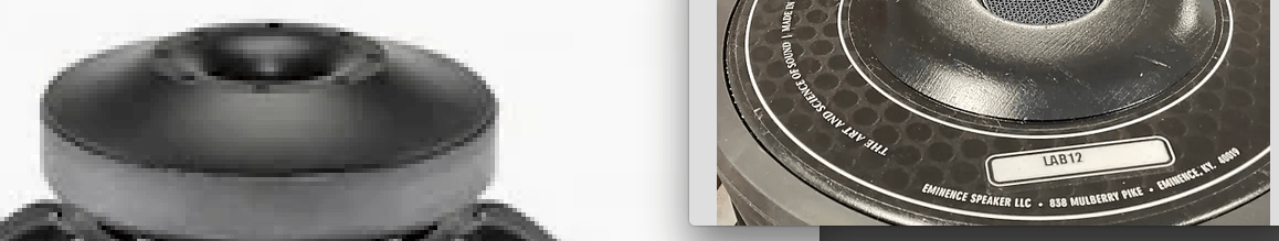

Wayne made the vent plugs for LAB 12s used in small sealed chambers to get the pole piece heat out of the box.
1) The driver's vents in the Keystone are within a few centimeters of open air.
2) The (~24year old) LAB12 design lacks vent holes around it's 2.5" (63.5mm) voice coil, it's cooling is not nearly as effective as the 100mm (4") B&C TBW100.
3) Adding heat sinks to the TBW100 magnet structure could reduce it's heat, but a plug in it's center vent probably won't.
