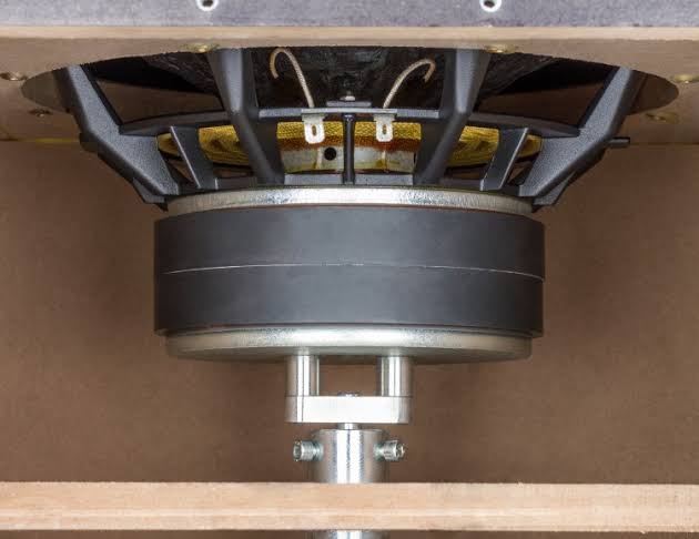

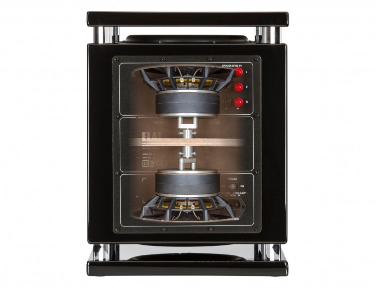

Elac subwoofer is a good sample for construction ideas dual opposed sealed
Elac has a good designer so the sub should work well, although I don't quite agree with coupling the magnets to cancel the forces. In principle the driver frame could still be applying force to the baffle. All I care about is that there is zero forces at the baffle, since that will be communicated to the outside as unwanted sound. I don't care about magnet vibration since it is inside the box and presumably less noticeable since it can be damped by fibrefill. In fact, assuming symmetry such as a cylinder or sphere, even the internal pressure forces at the baffles should be equal and opposite and therefore cancel if connected rigidly.
