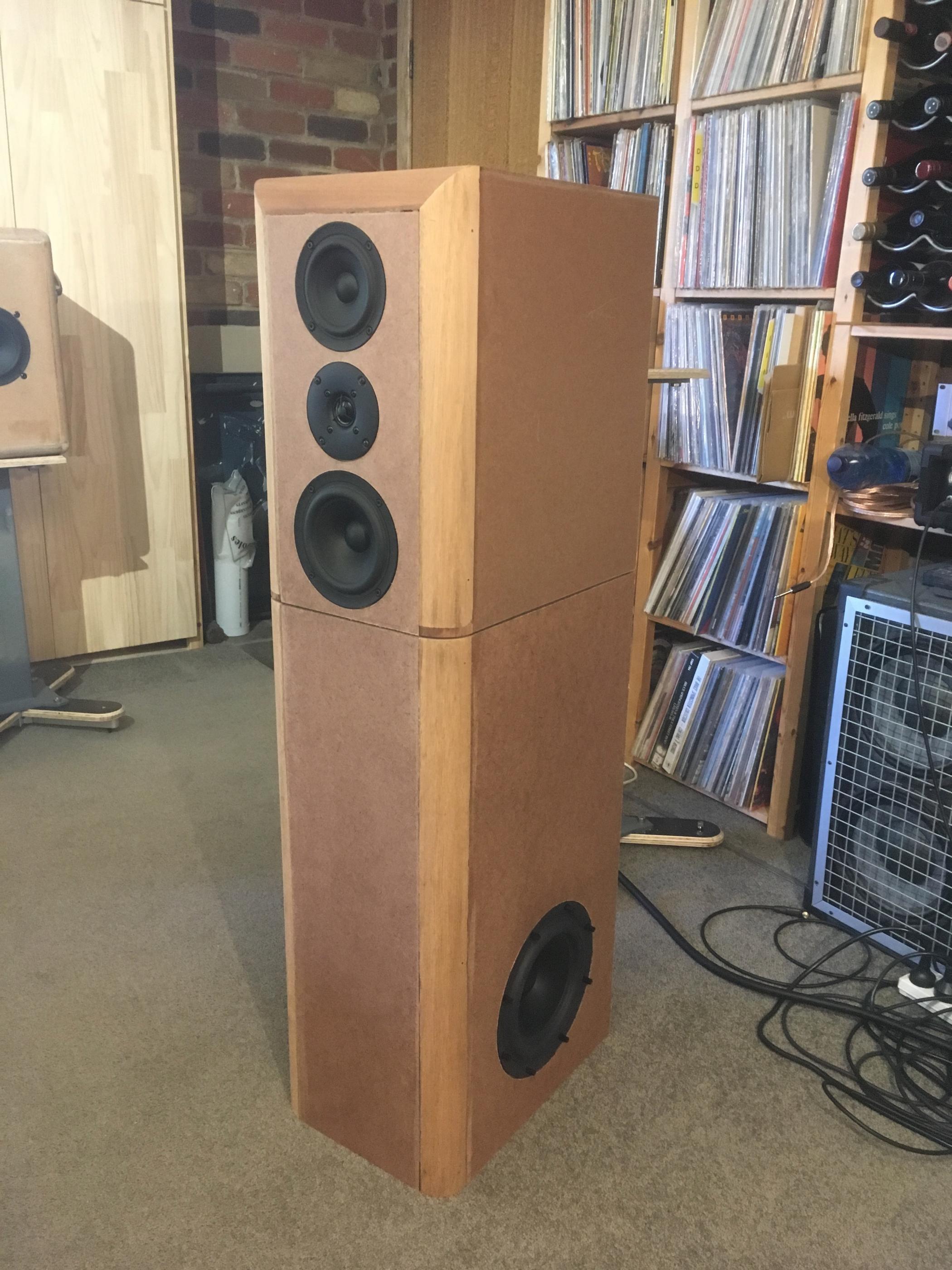

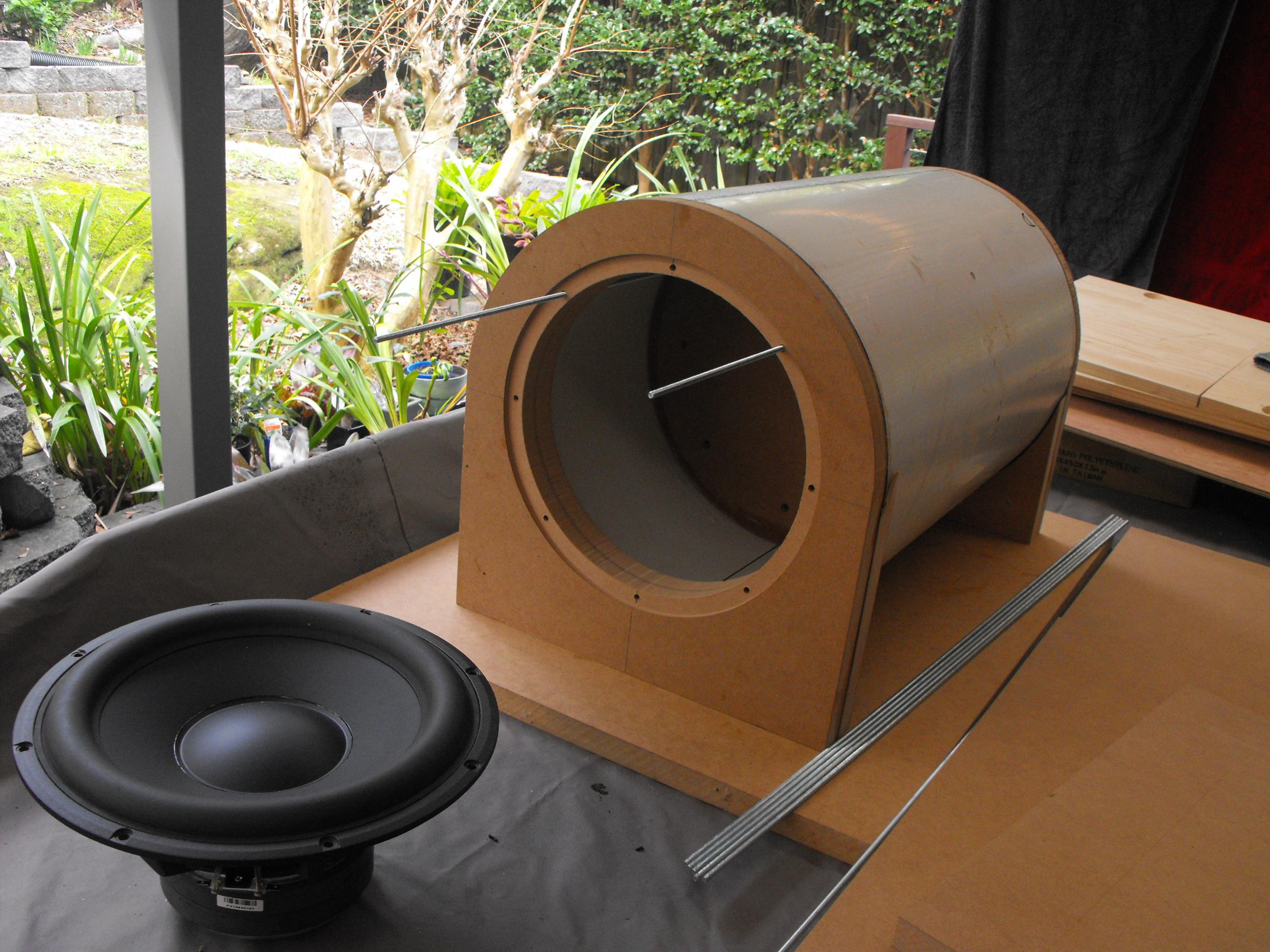

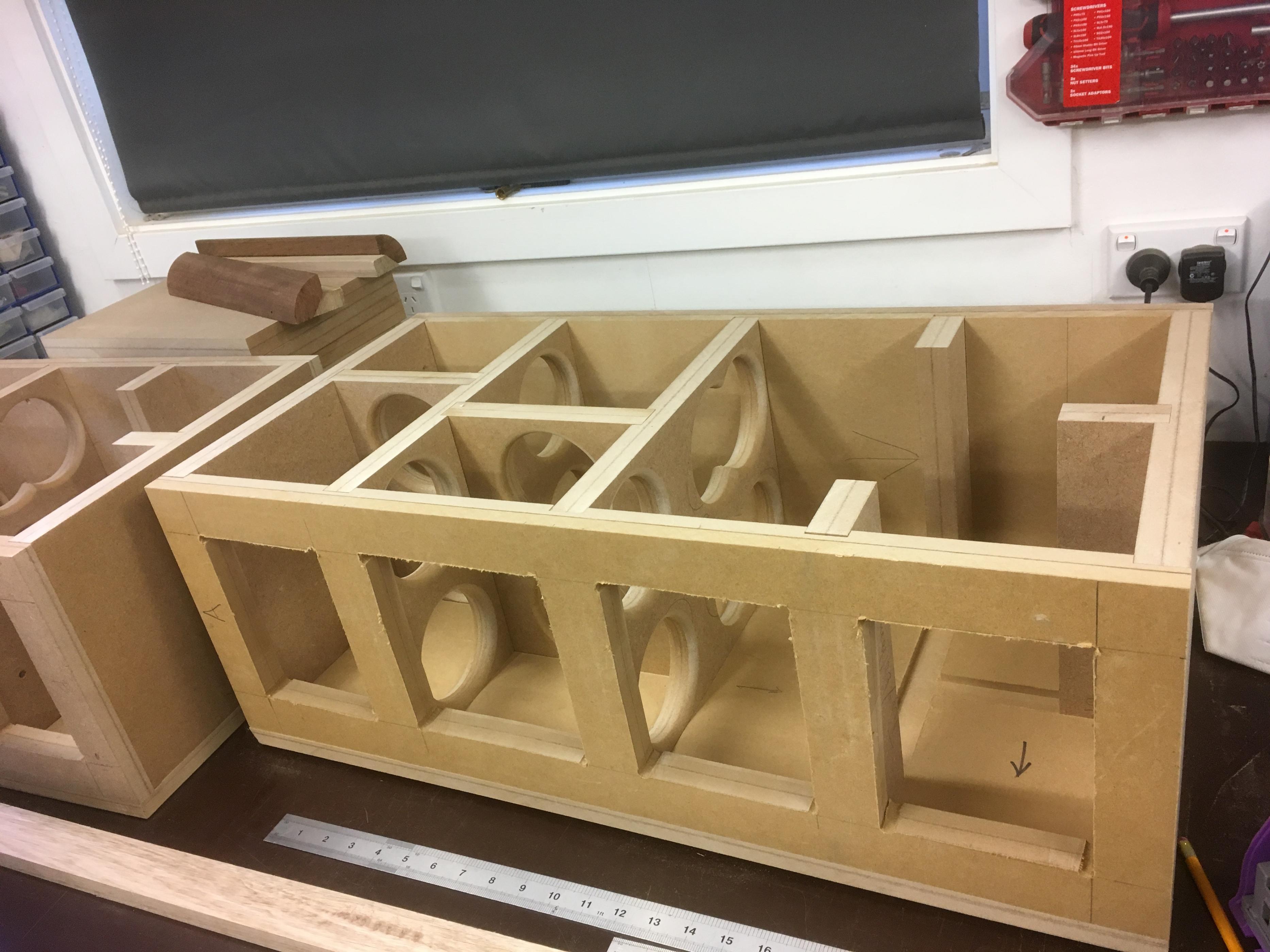

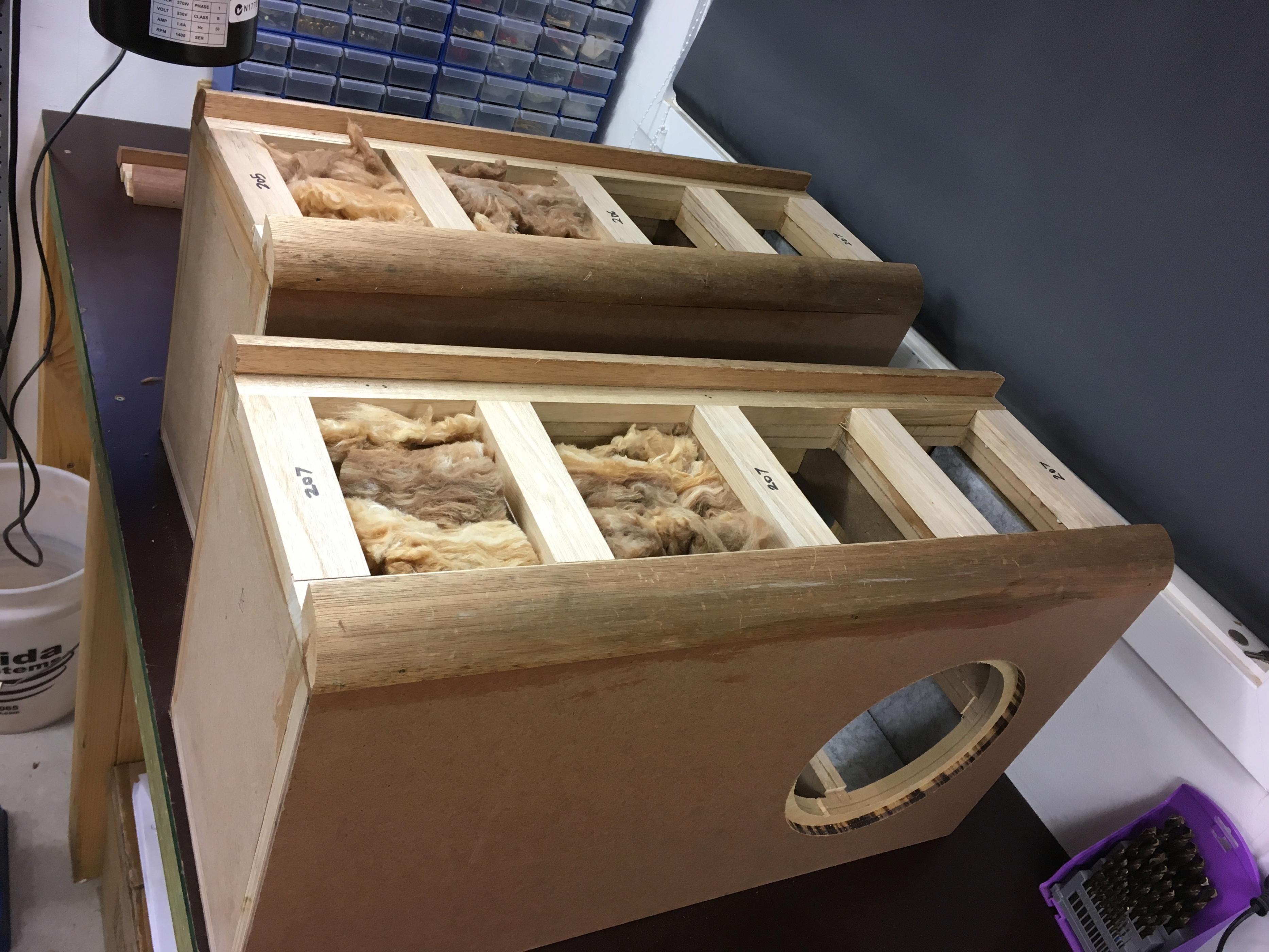

Time for an update to my original enquiry about the effectiveness of force cancelling woofer techniques. I started with a sub using 400mm plastic drainage pipe. I used 2x12" Peerless XLS drivers for a home theatre sub. This was a trial to evaluate the principle. The 600mm pipe length had a central circular brace but I don't consider it was really necessary. The end baffles were a drop-in fit, glued and screwed to the pipe. 5mm threaded steel rods through the woofer holes have nuts Araldited on one end and a long nut for tightening the other end. The saucer of water balanced on the cylinder with no ripples is amazing verification of the lack of cabinet vibration. Having confirmed the effectiveness, I next implemented force-cancelling in a 4-way active speaker project. The sealed sub-woofer sits below the 3-way sealed enclosure with drivers mounted close to the floor to assist bass output (<100 Hz). Drivers are SB Acoustics SB23MFCL45-8. Threaded 4mm stainless rod are the largest to fit the woofer holes. The results exceed my expectations. I will try and use this method in future projects whenever feasible. The only downside is that side-mounted drivers restrict the possible speaker room positions. Avoid side-walls and nearby furniture.

My speaker building has evolved over decades. The importance of enclosure rigidity and damping cannot be overemphasised. The force cancelling technique was the last important element to implement after previously taking materials, bracing, constrained-layer-damping to extremes. As the enclosure and driver size increase, force cancelling is a game changer IME. Testing the sub with 15 Hz, doors, windows, furniture in the room were shaking violently. If you have every had a LARGE helicopter go overhead at low altitude, you would have an impression. The saucer of water balanced on the sub did not show even a ripple. Later, it was discovered that the plasterboard (wall board) nails had "popped" at several locations. BTW, the subs are sealed.
Where did you source the 400mm plastic drainage pipe in Australia? I wonder if there are any tubes with ID of 445mm as then 18" woofers would fit straight on with no sawdust.
400mm is a standard size. I don't know what is the next size up. I was given the 400mm as a scrap building project item. Wall thickness is approx 8mm, which shows no flex at all under serious drive. A rigid cylinder or sphere cannot pump under uniform internal pressure. The baffles are another matter but should be kept to a minimum as you suggest. I don't know if they can be completely eliminated, since the drivers have to bolt onto something.

I used a small rectangular plastic terminal plate on the underside of the cylinder. Cut the hole to close fit with a jigsaw. A thick bead of glazing silicone and the terminal plate tightened down with screws until silicone oozed but not enough to distort the plate. Allowed to dry 24 hours and tested for leaks. The end baffles also glued up with silicone. It is a 2 layer laminate, with the inner layer a circle that drops snugly into the pipe. A generous bead of silicone around the circle prior to fitting. The silicone must ooze and be smoothed the inside/outside seams with a finger. The outer layer of the baffle is originally slightly over size for the pipe but trimmed flush around the semi-circular part with a router bearing trim bit. The tension rods and silicone hold the baffles solid to the pipe.
