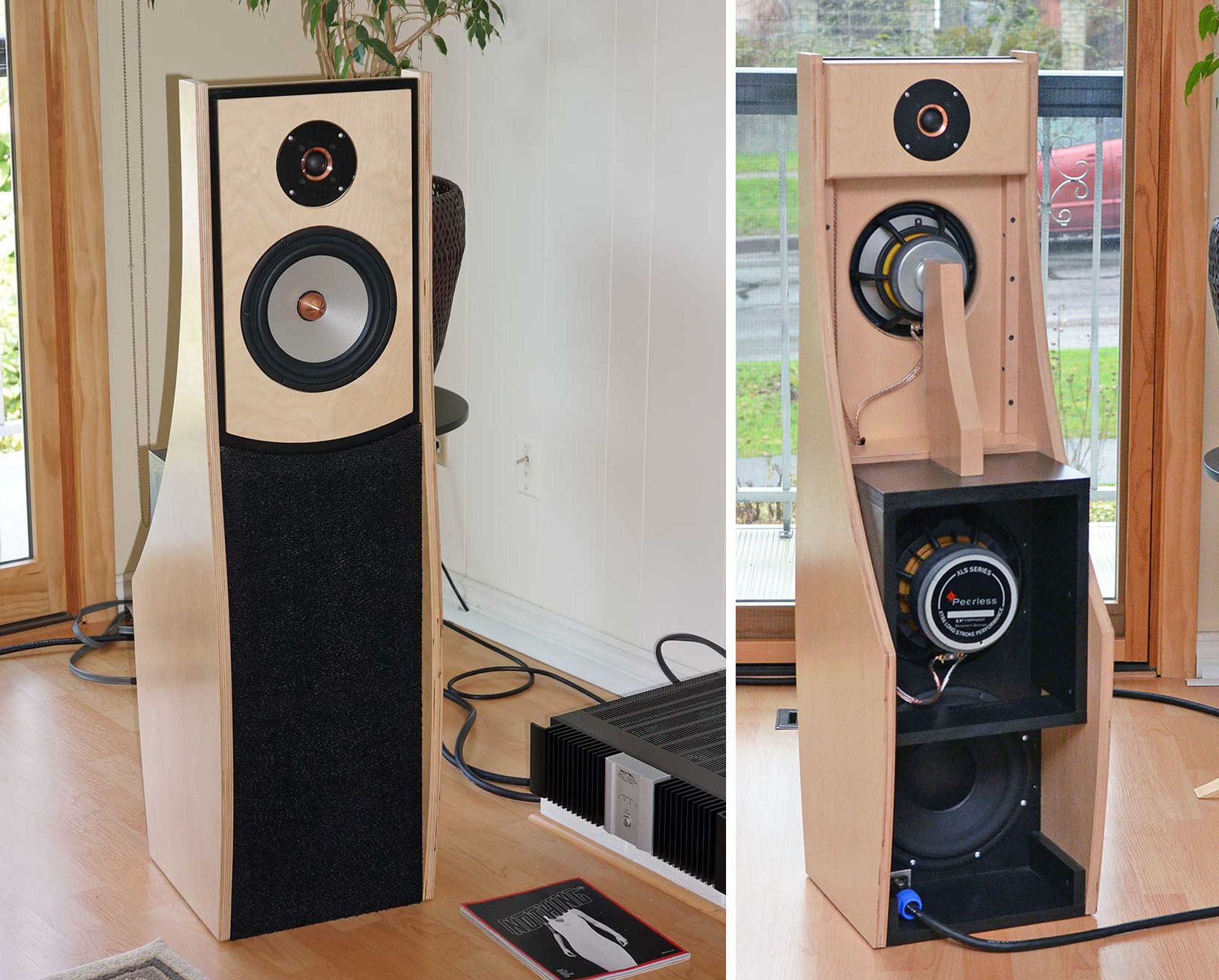

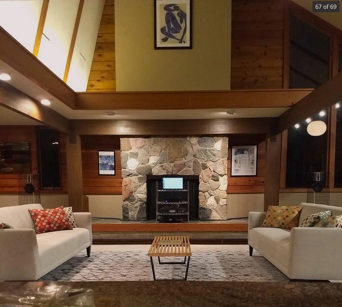

This is a new project for my friend Mark who has an enormous "great room"
30x52' with vaulted peak ceiling >20' high. The goal is not to fill the entire space with sound but the LR portion, which is about a quarter of the total floor space. Mark seeks a game-ending system, with some financial limits. He also happens to be a master metals fabricator with a lot of skills & tools, which will be brought to play.
I post this as a reality-check / peer-review of my plans.
This pic shows a fraction of the big room.
Initially, Mark wanted scaled-up versions of my LX521 clones with dual 15" SBA Nero-15SW800 in a W-frame force cancellation setup. But after examining the room again, I persuaded him that OB might be too expensive & difficult to achieve 20Hz bass at >100 dB even in just his LR space. I've heard his EV Sentry II & JBL L212 speakers in the space & there's little question the sheer size of the room is a challenge. Amending the acoustics with floating absorbers/diffusers in the ceiling (and elsewhere) is not an option due to WAF. A large rug in the LR is in the works; currently the entire space is reflective.
The current plan is a pair of 12" woofers firing sideways in opposition to each other in a sealed enclosure, topped by an OB lower mid, mid & tweeter. This would be an active system with miniDSP Flex 8 & a mix of amplifiers for the various bands, a turntable, and a Wiim Ultimate streamer/preamp.
The physical design will draw from the iconic Acoustic Research AR9 (1978-82), the modified sealed-bass LX521 I recently made for my son, and the Linkwitz Orion. Mark likes the look of my Orions, which also garner better WA. I believe I can replicate that with side-firing 12" woofers in a sealed box + a WG tweeter to reduce diffraction & control vertical directivity.

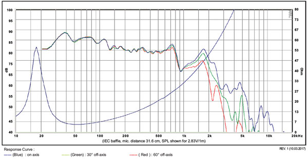

Woofer: SBA SB34SWPL76-4 Low sensitivity of 85 dB/2.83V, but 19Hz Fs, a low 79 liters Vas & 0.31 Qts allows 0.7 Q in a 40 liter (or smaller) box, with a slow roll-off easily amended by DSP. Two woofers in a box double that size could easily provide >100 dB to below 30Hz with force cancellation minimizing vibrations to the OB above. 15mm Xmax is excellent, as is the FR claimed in the spec sheet.

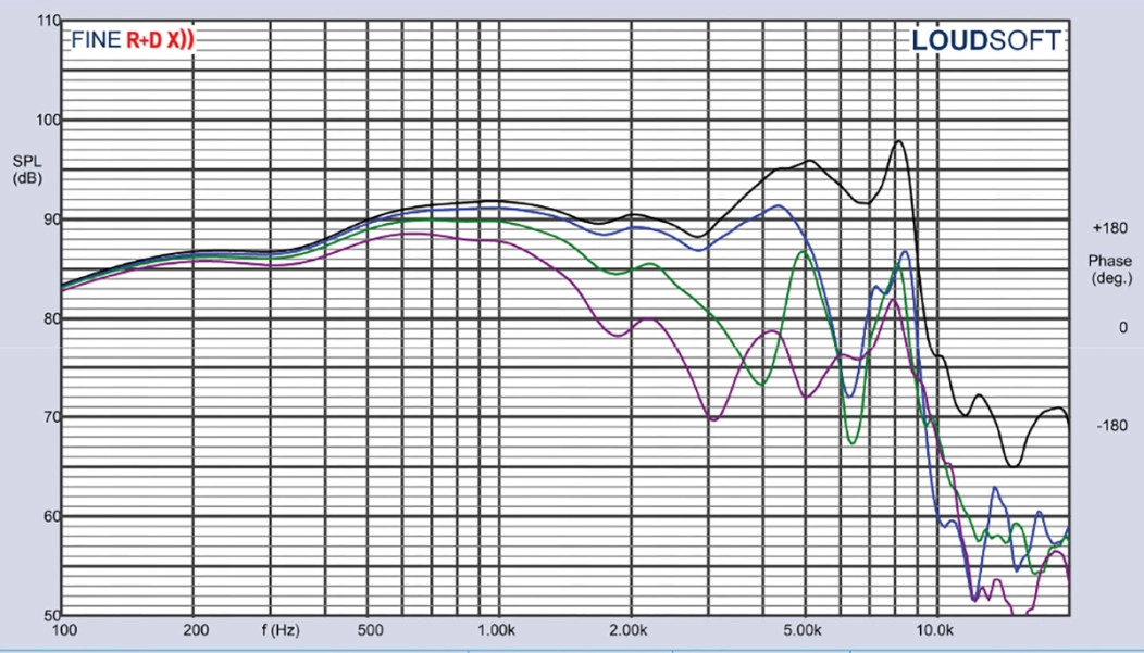

High Mid: The Satori MW13TX is a natural choice, given the WO24TX lower mid choice. It will not be necessary if we go 3-way.
Tweeter: My favorite dipole tweeter Aurum Cantus AST2650 will get a shallow waveguide on both sides. The waveguide has yet to be made, but I've seen enough iterations of such that it should not be a big challenge, executed in 3D printing or CNC cut directly in the baffle board.

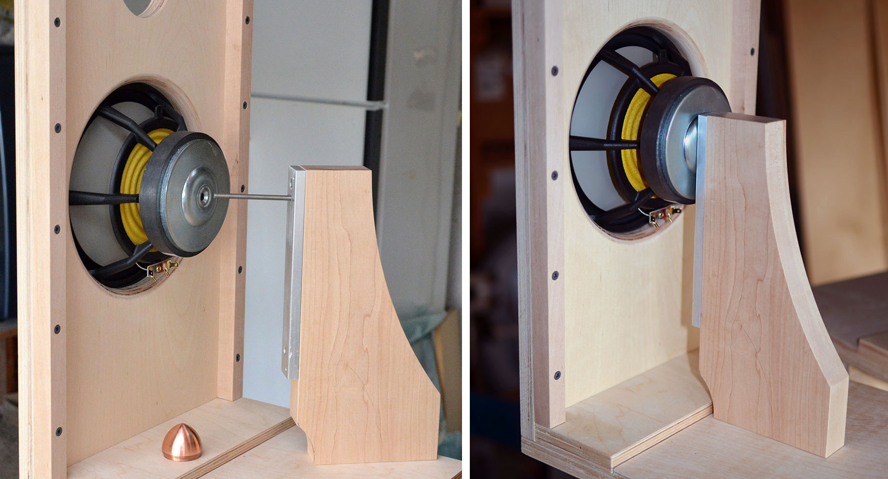

One feature that will likely be adopted from the Orion is the mounting of the lower-mid 9.5" driver by its magnet to the top of the bass bin. This config positions the driver on the baffle without touching it, preventing mechanical conduction of the driver's vibrations into the baffle. There's a foam gasket to prevent spurious vibration between the baffle hole and the driver rim. The force cancellation of the bass drivers should keep most of the larger vibrations out of both the box & baffle. This method of mounting the low mid driver will complete the primary anti-vibration scheme.

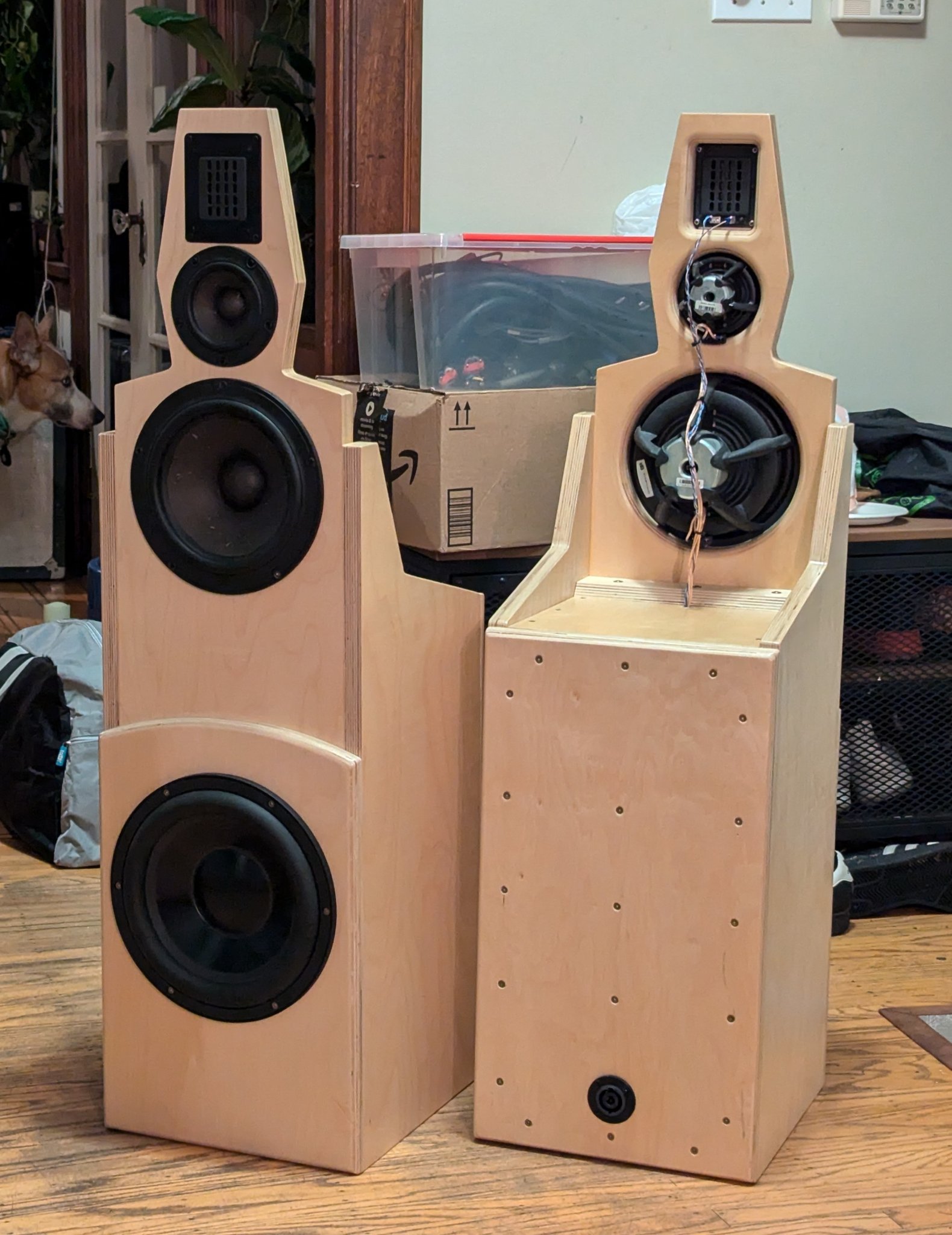

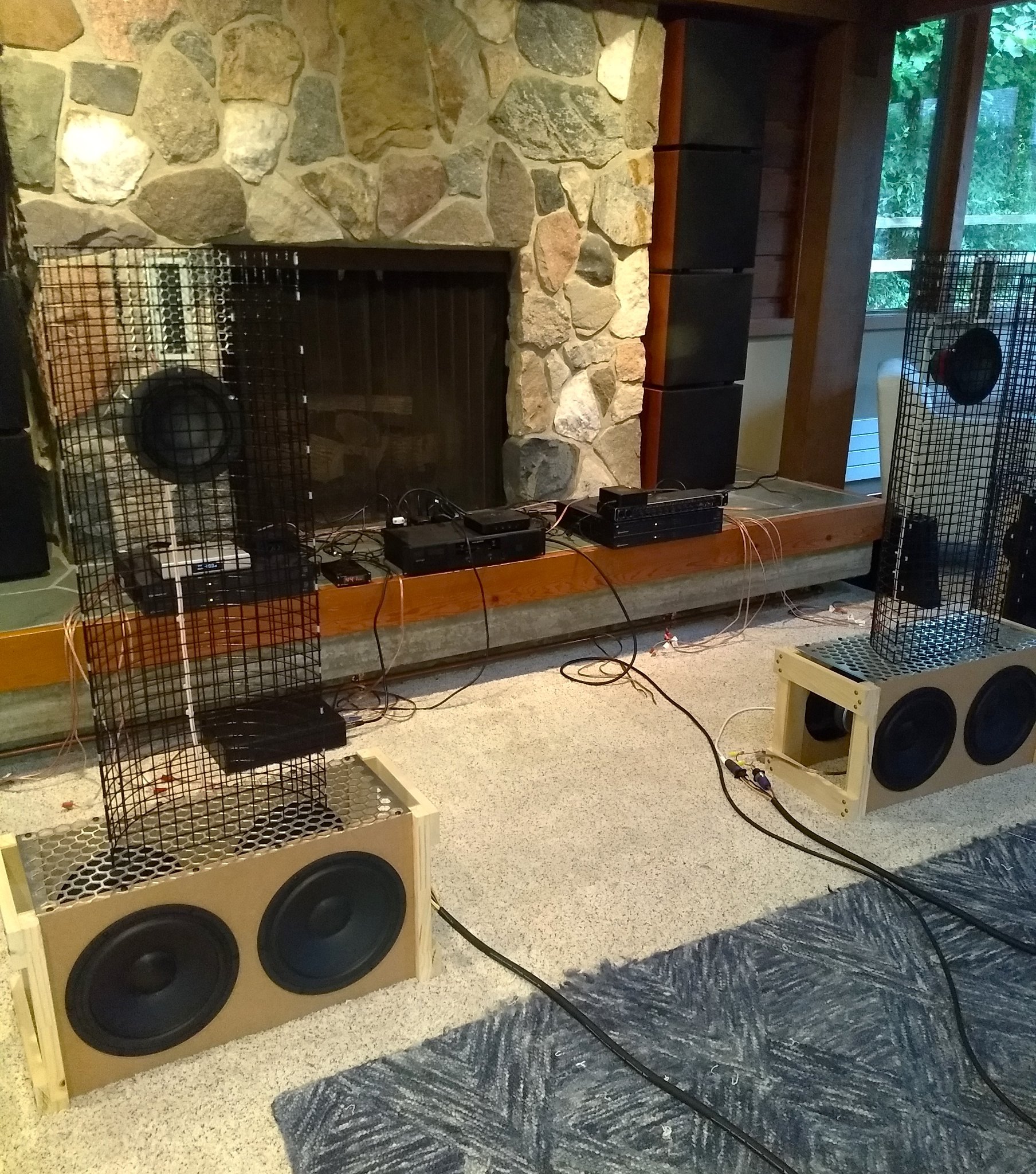

In my last home I had a very large vaulted space that I filled with sound using a system consisting of a 3-way dipole type loudspeaker operating above about 80Hz and sealed subs below. I deployed stereo subs, with four 12" drivers per side each in their own cube of about 1.25cuft. I stacked them on top of each other into a column and placed the columns against the wall behind the speaker. The speakers were positioned about 1.5-2m out from the wall. The system was active with DSP used to implement the crossover and address the main LF room mode.
With a 3-way dipole you can get down to around 100Hz using a single 12" or 15" driver, or use four 8" drivers in a panel arranged 2x2. The midrange can be a 6" class which can cover 350Hz to about 2kHz, with a dipole tweeter above like Mundorf or I used Aurum Cantus ast2560 or ast25125 with the faceplate removed. For my systems the mid and tweeter were nude. This can reach pretty good SPL levels with the woofer relived of low bass duty.
This concept could work well in the space that is shown in the first post.

Was this overkill for headroom or just enough? Did it give you balanced FR at the listening area? How was the sound beyond the listening area? Any pics or measurements?stereo subs, with four 12" drivers per side each in their own cube of about 1.25cuft. I stacked them on top of each other into a column and placed the columns against the wall behind the speaker.
Whether that many subs is overkill depends on the drivers used. I made the mistake of choosing some pretty cheap GRS drivers just because I already had the cabinets from a buyout and the drivers fit the recessed hole in the cabinet that was designed for "old school" 12" driver frames, and now the normal frame OD is about 0.125 larger and most 12" drivers would not fit. My listening space was pretty large because of an open plan home and dimensions up to 40 feet across, so eight 12" drivers was not overkill and the sealed subs could provide satisfying bass better than dipole type subs below 35 Hz. See attached pics for the room and speakers. I could only find one pic that shows the subs. They were just utilitarian subs, nothing special, but they did their job. In any case I did not think of taking pictures of them per se, so they only happen to appear in the background of other pics.

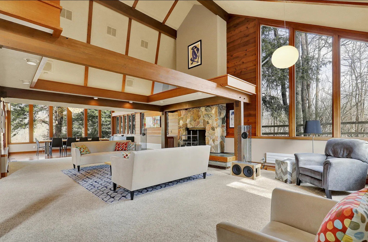

The first two pics are from when our home was up for sale last spring. The subs were normally positioned on either side of the rock fireplace hearth but I took them out when we were showing the home to potential buyers. IMO when in this position they disappeared nicely into the area and centrally located them along the long wall of the room. In a more regular sized room I would put them in the corners if possible and then use some delay compensation for the main speakers. I liked how the speakers could disappear and did not draw one's eye too much. Contrast this with some larger planar OB systems e.g. from PAP which are not my style or design approach for a dipole loudspeaker. But it's not a look for everyone...
The nice thing about a true dipole system is that the FR seems about the same everywhere. I could walk around the immediate area or even be farther away in the house and except for the HF the tonal balance remained the same. This is because a dipole with flat FR will also produce a flat power response. There is always some attenuation of the HF due to adsportion by room surfaces, however. Otherwise I tend not to use room treatment and prefer a more live/reflective environment with a dipole speaker.

I'm a bit surprised that the SBA SB34SWPL76-4 isn't discussed more here (at DIYaudio) because on paper it's quite the driver for an old time "acoustic suspension": 15mm Xmax, 19Hz, 79l Vas -- WinISD predicts~40 liter sealed box for 0.7 Q w/ F3: 43Hz & F10: 25Hz. DSP would easily flatten the response to 25Hz, with 300W power handling. From a box under 1.5cf, that's pretty impressive, and the cost relatively modest at Solen: CA$332 = USD237
