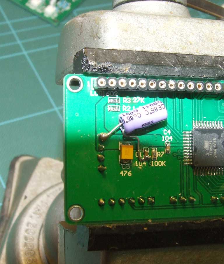

OK,looks like power supply comatiblity.
I had a nice email from Luzhu with some suggestions.
The clue is if it does power up in the correct state, EVERYTHING works, including the remote. No problems 🙂 🙂
So it looks as though the initial power-up reset is not working. This is because the PSU I am using, a big bench supply with digital meters, is very heavily damped giving it a safe (but slow!) risetime.
Adding a series mechanical switch to the +5V from the supply allows it to power up correctly every time.
Sorry for the scare!
Cliff
OK, everything resolved for me.
Luzhu sent me the schematic of the controller pcb so I can see how the power-on-reset circuit works.
There is a 1oonF /100K (C1/R7) holding up the RESET line until the power is stable.
In my case this time constant is not enough as the supply is slow. So I added a 2u2 el elctro across C1 to increase it.
I don't have any SM components so used a HUGE standard one! See photo.
After 100 power up cycles, no problem at all.
As Luzhu emailed to me, this is designed to run on a standby (always on) +5V which doesn't get power cycled.
This is fine, but there is always the very first power on, which, if it isn't properly reset, can get stuck in a loop!
I suggest that C1 be increased to >1UF and you ship the complete schematic with the product.
Now I can connect it up, at last, and see how it sounds.
Cliff
