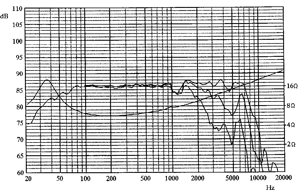

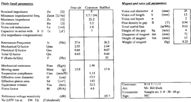

Avikas,
Unfortunately, I don't have any drivers that can be used as replacements for the npt-11-046-1 woofer.
From a strictly mechanical standpoint, the 046 has a small frame OD. This makes it hard to fit most other 6.5" woofers into the baffle hole. The second problem is that the angled baffle on the M2.5i means that there is very little clearance from the motor of the woofer to the inside surface of the outer cabinet wall. The woofer you put in there must have a motor with a very small OD to not hit the cabinet wall. On other NHT speakers with angled baffles that had larger motor woofers, we had to route out a recess on the inside of the that wall just for motor clearance.
I have never compared the 025 frequency response to the 046, but at least their sensitivities are in the same ballpark. The Re values are the same. The big difference is the Qts. Since the driver is only used own to 125Hz in the M2.5i, the very different Qts won't have too much effect.
I've attached the 046 spec sheet.
