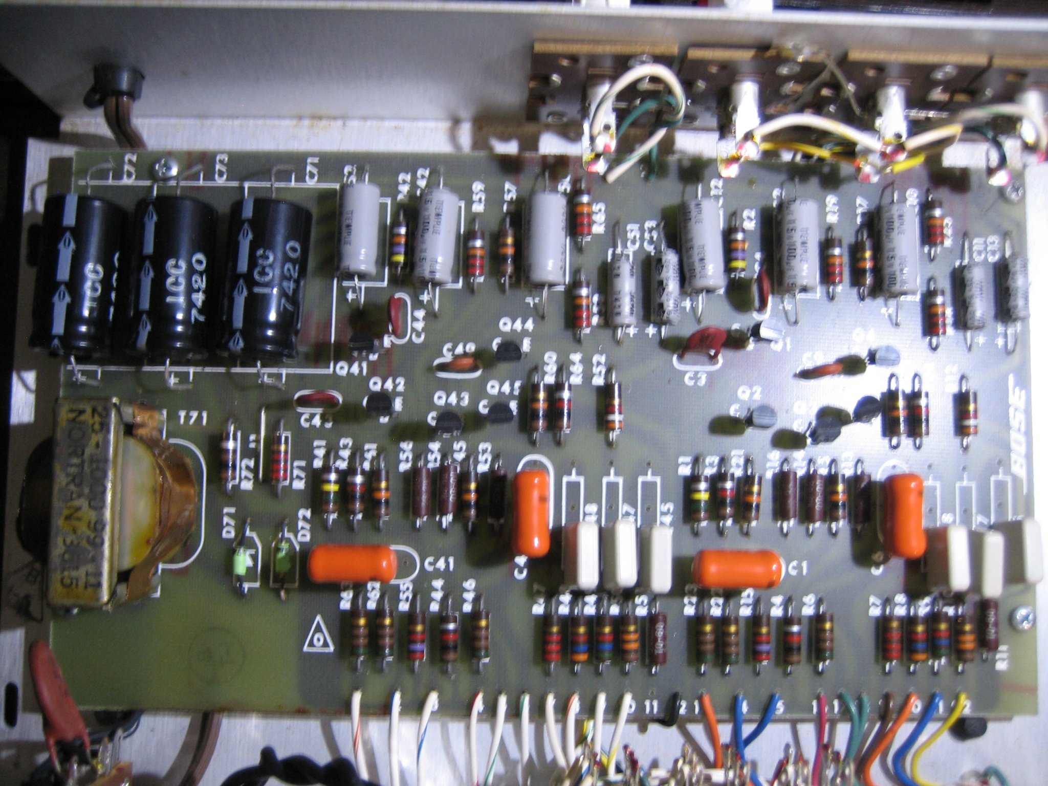

For audio signal path in an equalizer, which capacitor would you choose?
I have a choice of either
1....general purpose Vishay tva atom series electrolytics
or
2...audio grade Nichicon UKA series electrolytics
Those are what I have on hand and I dont foresee me using others ,
though I believe there are better choices available.
Lets have a vote !
I would like to see the actual circuit first. 🙂
A circuit diagram is important to determine where this capacitor is hypothetically going to be placed, and if it’s part of the filter, a RTF time constant network, or if it’s even needed at all to prevent the passage of DC, the position can have some importance regarding the value, type and capacitance.
If you talking about dc blocking, I would use a BIPOLAR electrolytic capacitor, they are suppose to have less distortion than any polar electrolytic capacitor.
Nichicon mentions ES series as their “Bi-polarized “nichicon MUSE” acoustic series”.
But other brands have their bipolar caps, Panasonic, Elna and others.
Film caps are of course good but the largest capacitance for a miniature cap ( with lead spacing 5mm) is 10uf, someting like wima mks2 10uf(I heard about wima mks2 22uf but I never seem them).
The caps are intended for a Bose 901 series 2 equalizer. There are a total of 10 capcitors for the audio signal, at least it seems that way to me. There are three others for the power supply. I'd like to replace the grey coloured caps.
Your picture is very blurry,
I don’t know your reason for thinking about replacing the caps, but if you looking for an improvement I would look at those resistors too.
Carbon Comps and Films are noisy and make amps have more hiss, pops, and sizzle. They get even nosier over time.
If the nominal voltage across the capacitor is zero, bipolar are a reasonable choice, but if there's an explicit voltage across the cap use unipolar electrolytics with the correct polarity!
If the cap value is large enough the distortion will be minimal as only a tiny fraction of the signal voltage appears across the cap.

Nichicon UES are by far the best non polar electrolytic caps for the signal path. They sound very close to most smaller MKP film caps. You'll be hard pressed to hear a difference in any application that calls for a compact sized non polar cap. The next best ones are ERO brand, but they're harder to find.

The best bipolar? Yes. But if you want the VERY best, use a polypropylene cap. But the size and cost can be prohibitive. Another alternative would be the metalized PET caps---Bateman reports that "the best 1 µF electrolytic, the Bi-polar type, was clearly beaten by the good metallised PET"

I've tried the Nichicon UES in various coupling and feedback stages. They are almost as good as an average MKP in terms of distortion given the voltage drop doesn't exceed a few hundred mV and the DC offset is close to zero. Once you have appreciable DC offset present, a polarized cap is a better choice. This allows the cap to work in a more linear range. The main concern is to use a cap which has non-magnetic leads. All UES series caps have copper leads as opposed to most other electrolytics which have steel leads. The parasitic inductance can be a problem when using magnetic lead caps in feedback loops with any significant bandwidth.
Inductance due to ferromagnetic materials in leads is non-linear, and can be an issue at very low impedances / high currents, such as components in speaker leads, unlikely to matter with low power signals though as we are talking µ-henries v. k-ohms.
Inductance of any form can be an issue if it introduces a pole or zero low enough in frequency to affect circuit operation. Large wound capacitors (& wirewound resistors) can have significant inductance just from the geometry, though its possible to wind in a way that cancels circulating currents and is low inductance. Sometimes the datasheet will have ESL given, or self-resonant frequency.
