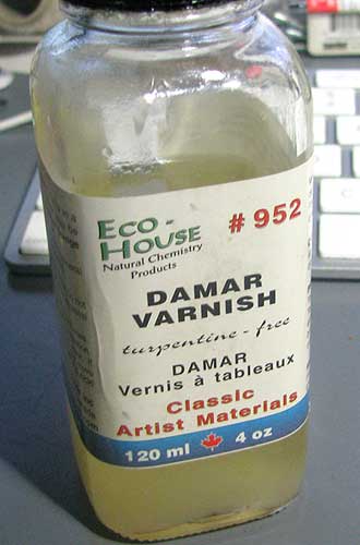

Dave, where do you buy you dammar? A link with a pick would be nice. I am working on a BOM for your ENABL process.

Note that the damar is part of my treatment and not EnABL.
Damar should be available at any art supply store...
one of a number of kinds at Dick Blick...
http://www.dickblick.com/zz004/38/
attached is a pic of my bottle
dave

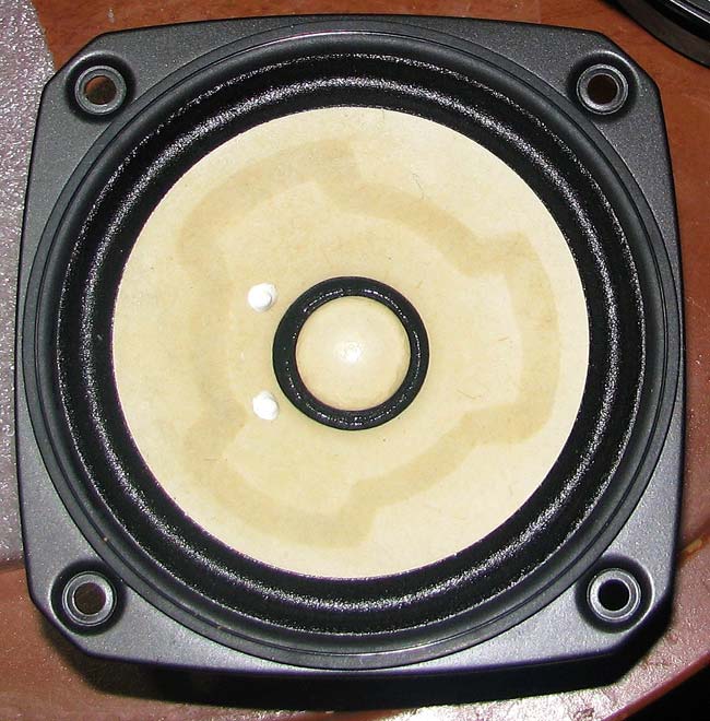

planet10 said:Here is a pic of a cone with the pre-treatment applied -- damar for the trifoil pattern, plus 2 thinned coats of puzzlekoat on top.
dave
Thanks for the pic, that pic and Bud's comment is just what i needed to push me to enabl. From what I read so far I understand that your and Bud's enabl processes are differant and I like your war paint with the extra twist.
If I understand what I read so far, your pre-treatment with the damar and and puzzlecoat is what you do before applying the blocks for enabling and the puzzlecoat has a plus side of allowing cleanup if you have an error. (does the banana get completly covered with the polly scale acrylic before applying the blocks?)
It looks like the suspension for the driver has puzzlecoat applied to them too, is this correct?
One last question. What brush have you and Bud found to be the best for applying the puzzlecoat or polly scale to the banana? Whenever painting anything, I have learned a good quality brust goes a long way on the results you get. A link would be nice to get a better piture.

the damar "trifoil" pattern was been used on these drivers before we discovered Bud's EnABL. While he has yet to hear the combination (an oversight we hope to soon remedy), they are synergistic.
I think that's just the stock treated fabric of the surround - sometimes the proximity of direct camera flash creates visual artifacts

ecir38 said:If I understand what I read so far, your pre-treatment with the damar and and puzzlecoat is what you do before applying the blocks for enabling and the puzzlecoat has a plus side of allowing cleanup if you have an error. (does the banana get completly covered with the polly scale acrylic before applying the blocks?)
The pretreatment has 2 coats of thinned puzzlecoat over the whole cone after the damar pattern (i specifically use the Mod Podeg gloss brand). Then the pollyscale flat EnABL blocks/spots are added, then i use 3 coats of 50% microgloss on top of that (each successive coat uses less paint,
The puzzlecoat allows for some error recover, but it has to be done quickly and not aggressively. A dry Q-tip to wick up the bad spot (don't rub, just dab), and then if necessary a wet one. This can still leave a bit of a stain sometimes). The puzzlecoat means less wicking of the acriylic into the paper fibres for a tidier application and more distinct edges and also leaves the spots to sit higher on the cone, but this is probably immaterial.
