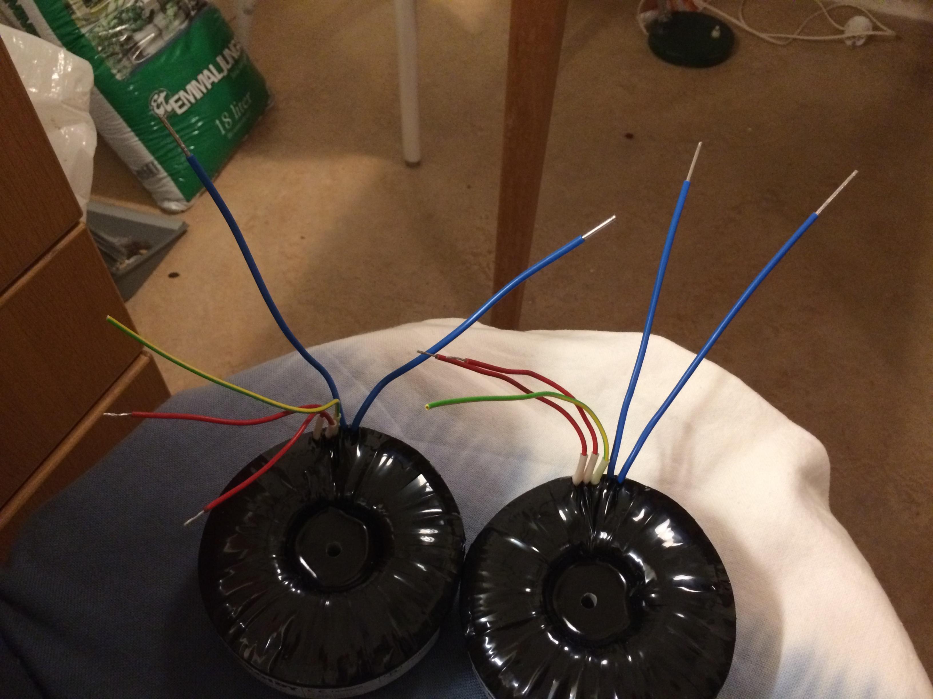

those are Toroidy, right? Love that company!!!
Then maybe not... The center is black instead of their beige color... They look amazing as well!
Do
